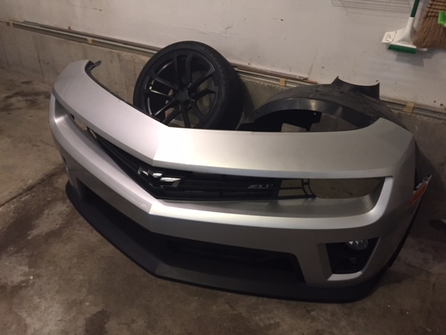

Heat Exhanger is not a consumable...
One of the First mods for me were a ron davis heat exchanger and radiator, rotofab hx coolant res. and i run 80/20 (distilled/dexcool) as it doesnt get particularly cold here in CA
