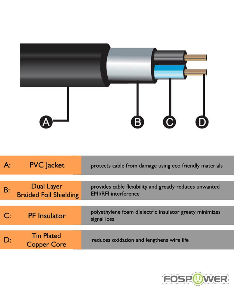

Okay, so.... I've added a microphone wire for those who's interested in tapping into the factory mic. As shown by @seishuku, there are two wires, a black hot wire and a grey secondary. What you want to do is to cut your cable on the end that can't be plugged into the radio, now you splice out the wires within, black for black, and blue for grey. Test it out before you wrap it with tape and reorganize your cable under the glove compartment.
Alternatively, you can cut the wire on the provided microphone from the 8200 NEX radio and bridge that to the factory mic instead.

Stock mic is just like any other mic out there... you were told that it wouldn't work because there are no adapters to connect to it. But that doesn't mean you can't splice wires to the mic and run it to your aftermarket radio.

Static/Interference is caused by improper shielding.
Just make sure your wires aren't exposed and carefully wrapped.
