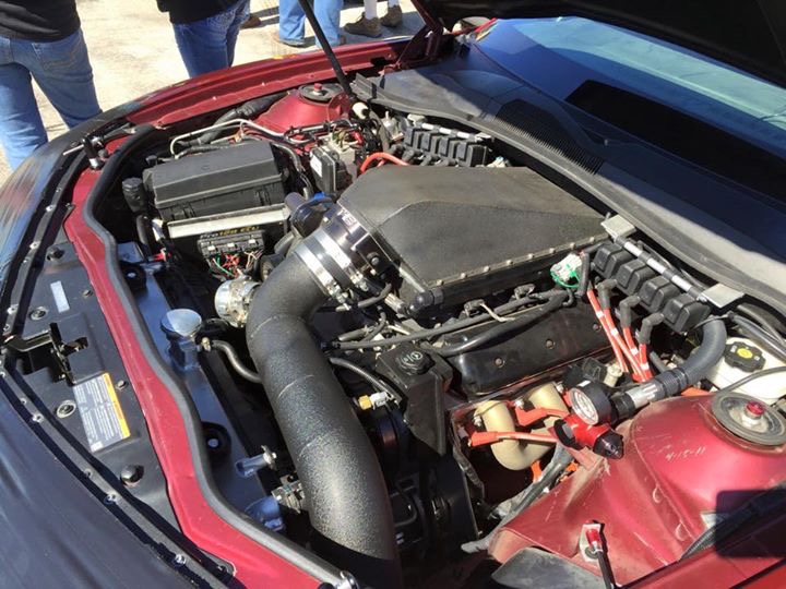

What intake are you running... Here is mine... It's the mock up test version. We like it (performance is amazing), so now will finish the drawings and mill it out of two billets. One for the top shell and one piece for the lower half. The milled piece will be very smooth with rounded contours rather than hard lines of the sheet metal piece. We built this piece in the shop.....
The throttle body is a 102 mm manual body. We kept having the blade shut on the electronic bodies.
I like the location of the coils
Thanks, that was a last minute oh crap kinda installation (I have intentions of cleaning it up and making them look nicer.) The valve covers that come with the heads don't have coils bosses on them. They have a lubricant tube inside fed by a -3 line from my oil supply (dry sump). The oil sprays on each side of all of the coil springs keeping them cool and lubricated. We run a pretty decent sized cam with big big lumps and we spin the motor to 9000 rpm... I don't want to break a spring and touch a piston with a valve.
