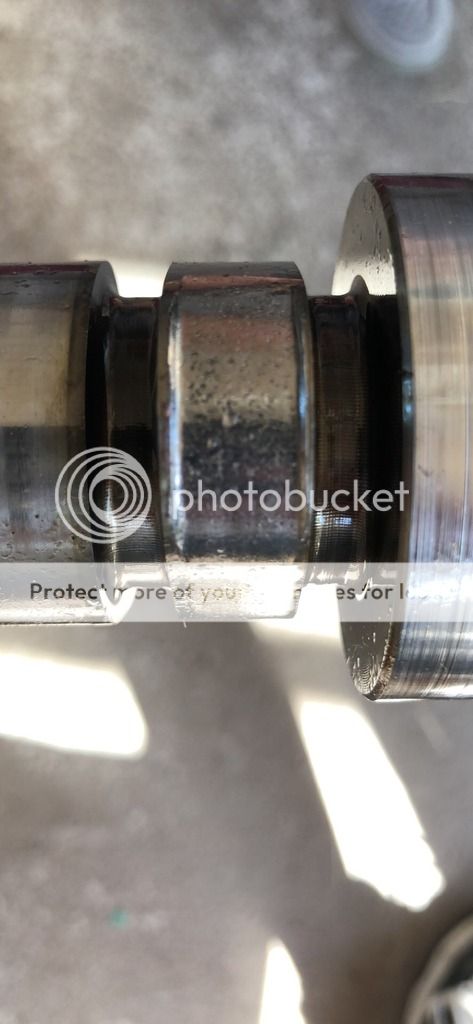

Here is the picture:
GPI SS2; EE E2 catch can; SP 1 7/8" LT Headers w/ hfc; FM AT 3" cat-back; CAI Cold Air Intake; AEM Wideband
Tuned by GPI
McCleod RXT; MGW flat stick; Ram Clutch slave cylinder & hydraulic adjuster
BMR cradle & diff bushings, trailing arms, toe rods & upper control arm bushings
Hotchkis sub-frame brace
Stop Tech Z-23 brakes
4.10 gears, Eaton Truetrac, LPW diff cover
Best 1/4 mile 12.073 @ 115.68 mph 3,300 ft DA
zlathim is offline   Reply With Quote
Old 02-04-2019, 09:41 AM   #16
anthony.martinez
Drives: 2010
Join Date: Dec 2018
Location: texas
Posts: 119
soft core cam shaft.
anthony.martinez is offline   Reply With Quote

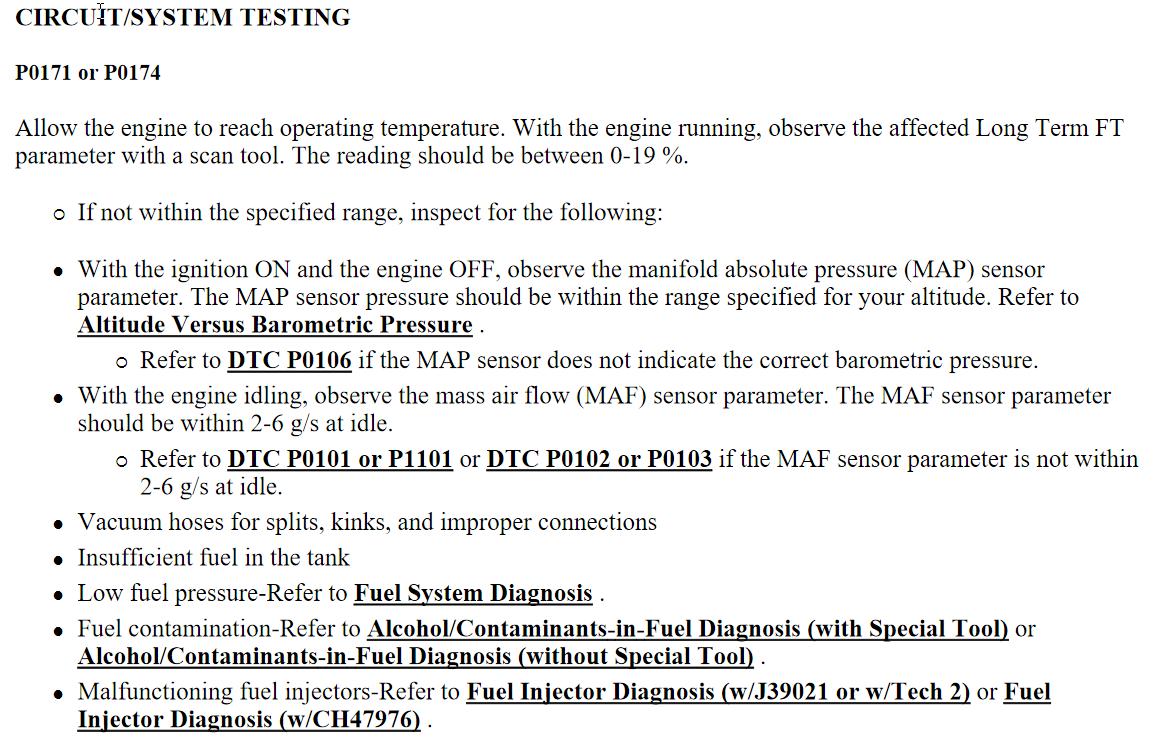

Here is the service manual coverage of those codes, I think it was about page 8000 something.
silversleeper is offline   Reply With Quote
