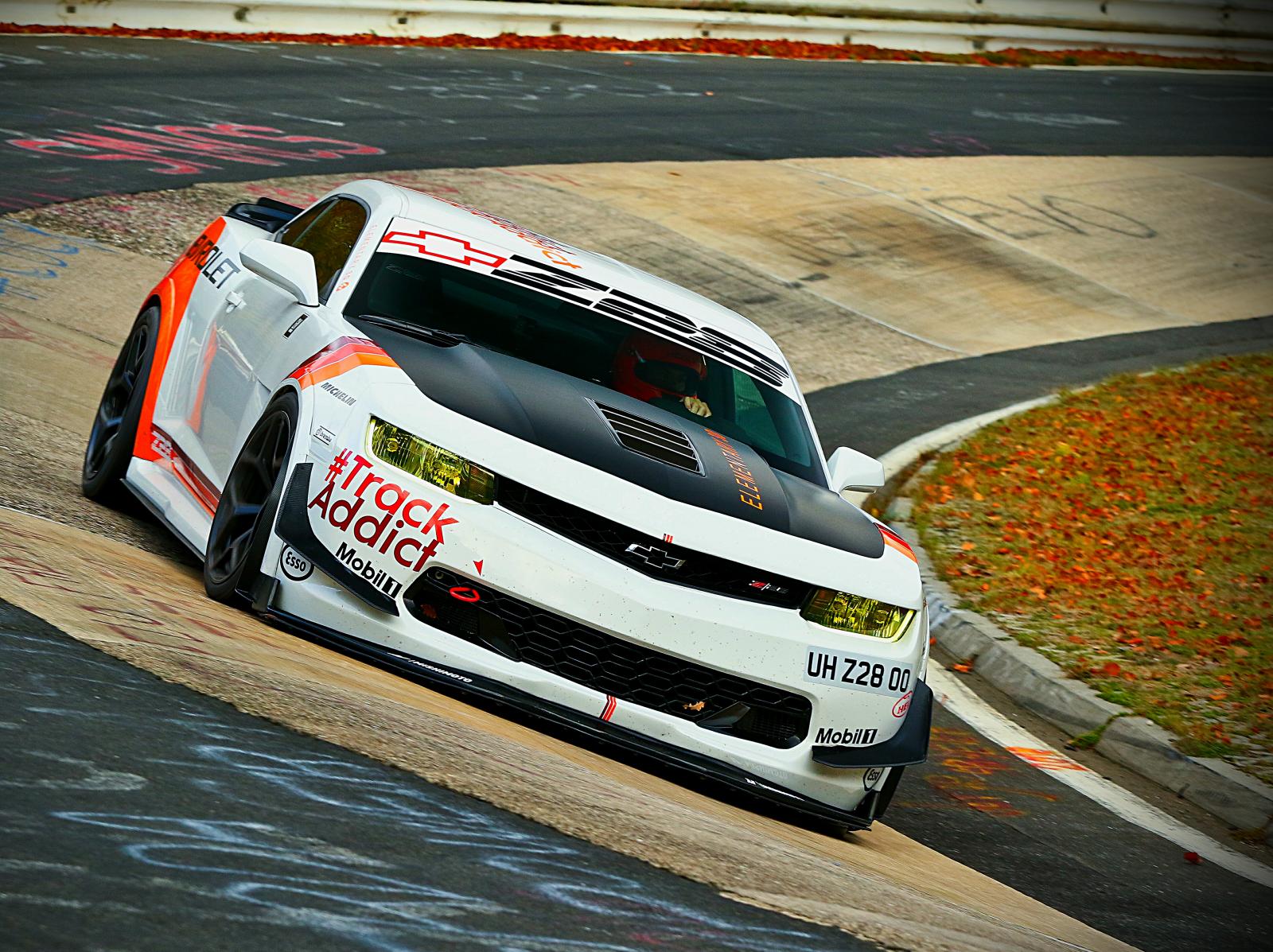

I'm still recommending marine plywood if you track it hard and intend to run kerbs.
No damage following 7 laps of this but it was gently kissing the ground. I've got about 1000 track miles on my current splitter extension now.
I've worn through the right hand side rubber tyre deflector piece though, I'll be ordering a replacement soon.
(This equivalent part on our Z28 splitters)
