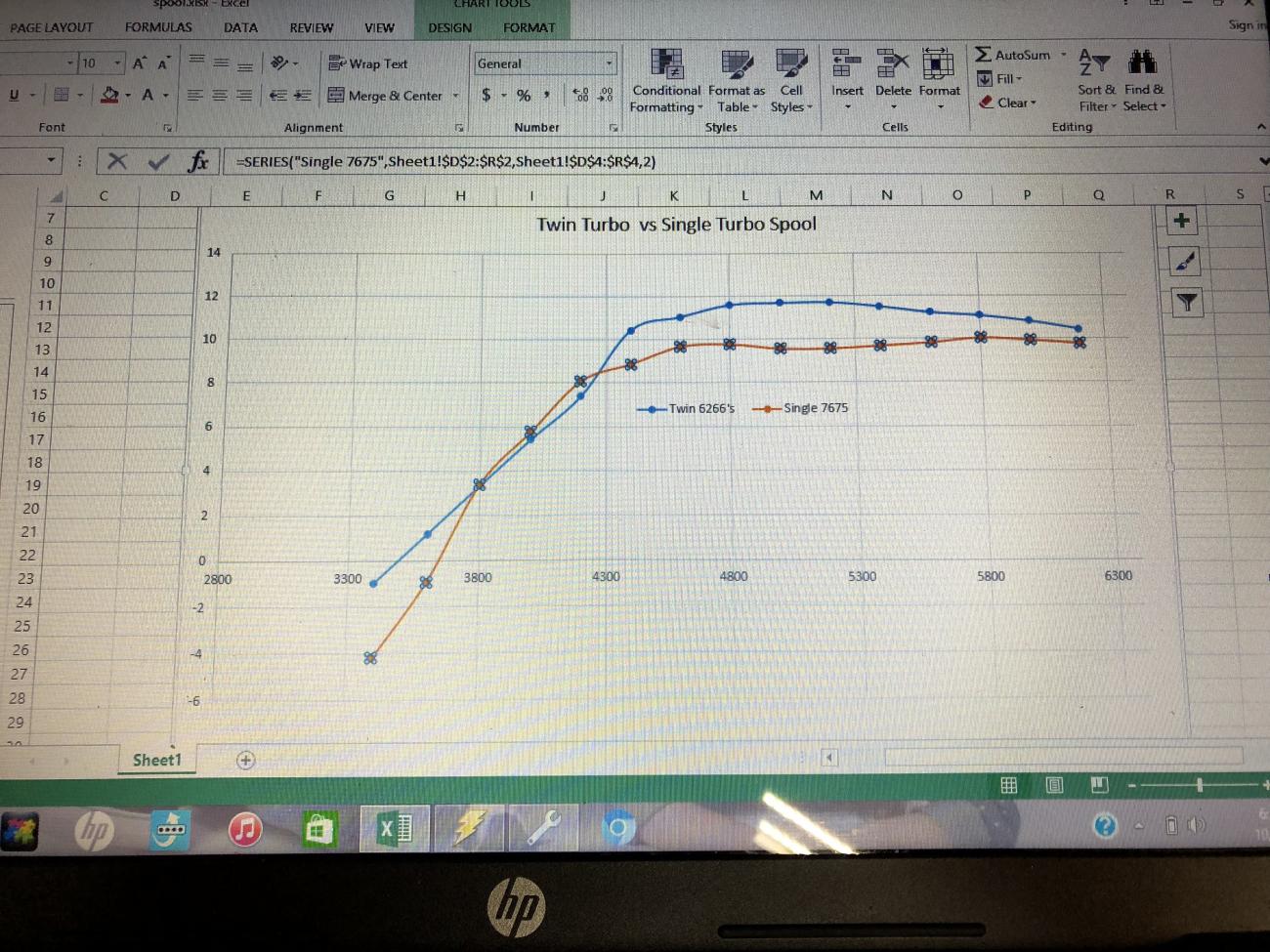

Old 03-07-2019, 10:45 PM   #21
RealQuick
Drives: 2010 Camaro 2SS M6 - Intake/Exhaust
Join Date: Sep 2014
Location: Bridgewater
Posts: 696
Just a quick example of my boost curves (2nd gear it’s on the street) twins vs single
Within 1400rpm I go from 0psi to 11.5psi with the twins.

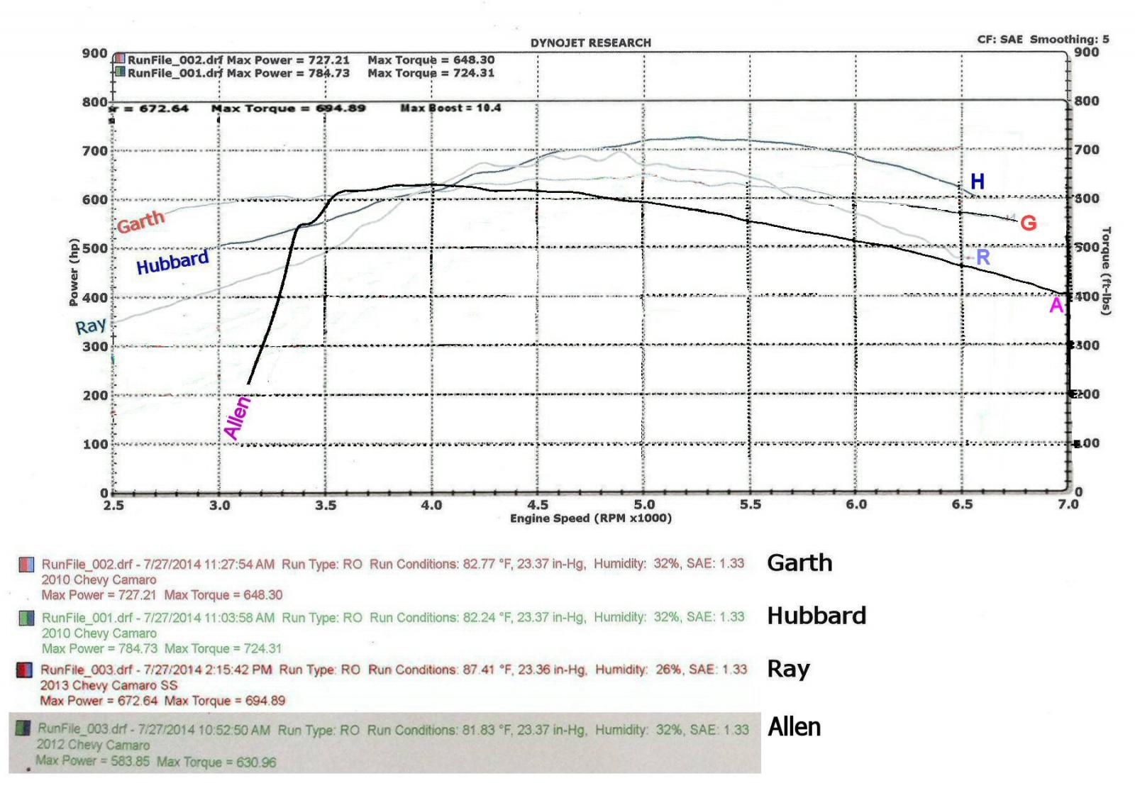

Old 03-07-2019, 11:27 PM   #22
dreksnot
Served USN - Atomic Chimp
dreksnot's Avatar
Drives: 2021 Camaro ZL1 1LE A10 (stock)
Location: Fort Collins, CO
Posts: 1,706
A number of years ago I overlaid different FI power/torque delivery. Don't look at peaks; actually look at how the torque and power come on. Same dyno, same day - it was a Dyno Day!
Garth has a roots [forged LS3, heads, 16psi]
Hubbard has a centri [SBE LS3, D1, 15psi]
Ray has twins [SBE LS3, head work, 10psi]
Allen has nitrous [SBE LS3, 200 shot]
The top graph is horsepower
- as we'd expect, the centri produces more power as RPMs climb
The bottom is torque:
- as we'd all expect, roots and nitrous produce tons of bottom-end torque
- as turbos spool up, so does the torque
My believe is the more area beneath the curve (power band 4,500 to 6,500RPMs) during a race is going to win.

but back onto the SC vs Turbo...although the graph of those 4 cars could have massively different setups etc...it does highlight one big misconception many have about a centri. Where many will say they do nothing at lower rpm's. Which is totally untrue. It's clear to see on those graphs that one isnt too far behind the Roots in terms of torque at lower rpm, despite seeing less boost.
And equally the twins graph....really not that impressive low down, but with no info on the setup....again, makes it sort of meaningless.
