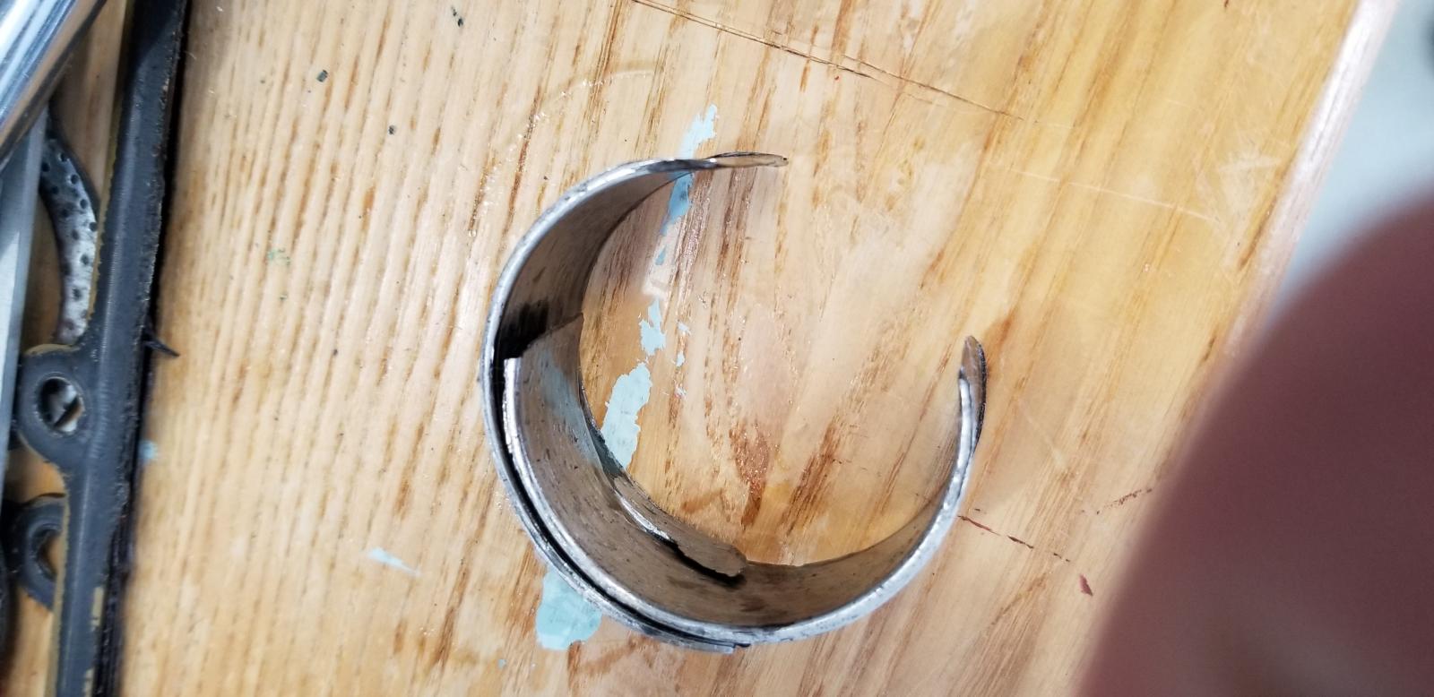

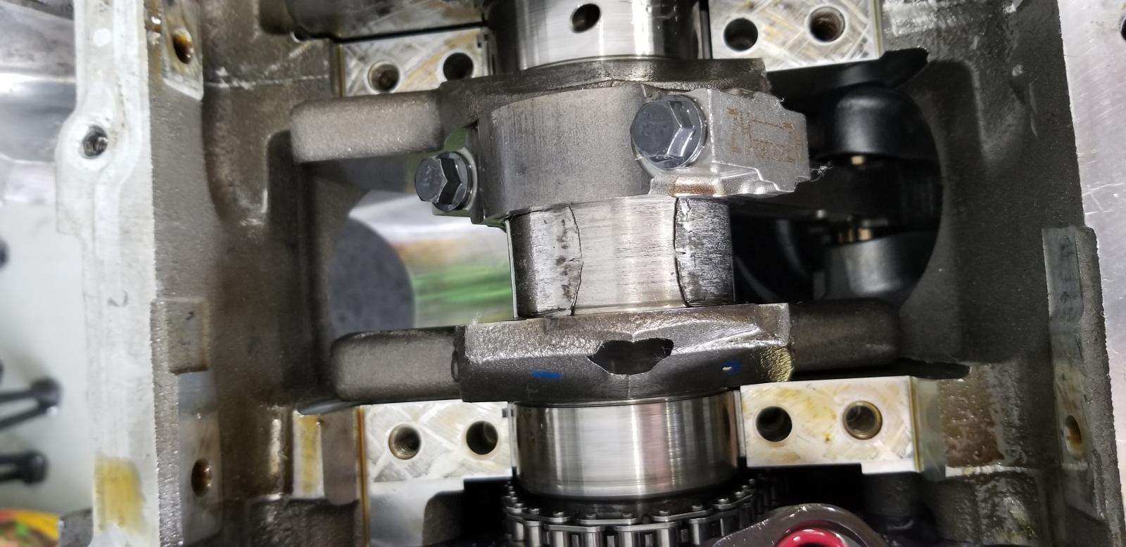

Old 06-25-2019, 04:57 PM   #20
zz430camaro
zz430camaro's Avatar
Drives: 2015 1LE
Join Date: Oct 2015
Location: Cleveland, OH
Posts: 1,498
Originally Posted by lazerlemonta View Post
Thanks Zach. I spin my SBE LS3 7650 but i have the valvetrain for it. Only reason I was asking is the X1 intake likes a cam for RPM.
Clarkstar used to spin his to over 7k regularly and spun a rod bearing.
2015 1LE, TSP 225/236 113+3, VMAX Throttle Body, CAI with race scoop, GPI Ported Intake, Land Speed Stage 2 Heads, 1-7/8 headers, NPP exhaust, 25% Fluidampr, LT1-S Monster Clutch, 485 RWHP & 444 TQ
zz430camaro is offline   Reply With Quote
Old 06-25-2019, 05:12 PM   #21
Clarkstar
Clarkstar's Avatar
Drives: 2013 1SS 1LE
Join Date: Jun 2016
Location: Ixonia wi
Posts: 1,456
I've read the stock bearings aren't designed to be spun that high.... some don't have any problems. I was less fortunate...
2013 1le- Katech 416 short block, TSP custom grind cam, LOD intake, cnc heads by F.ED., Nick William's 102mm T.B., CORN fed, Pedders coilovers. Performance street alingnment by Justin at Lake Country Alignment and dyno tune by Late Model Throttle.
603 h.p. 495 ft lbs tq.
Clarkstar is offline   Reply With Quote

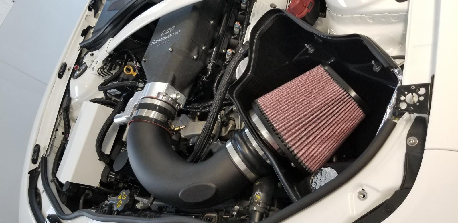

Clarkstar
Clarkstar's Avatar
Join Date: Jun 2016
Location: Ixonia wi
Posts: 1,456
Making progress... nw 102 tb and Airaid MXP intake. DSX flexfuel sensor is on too..... just gotta get to the tuner.
