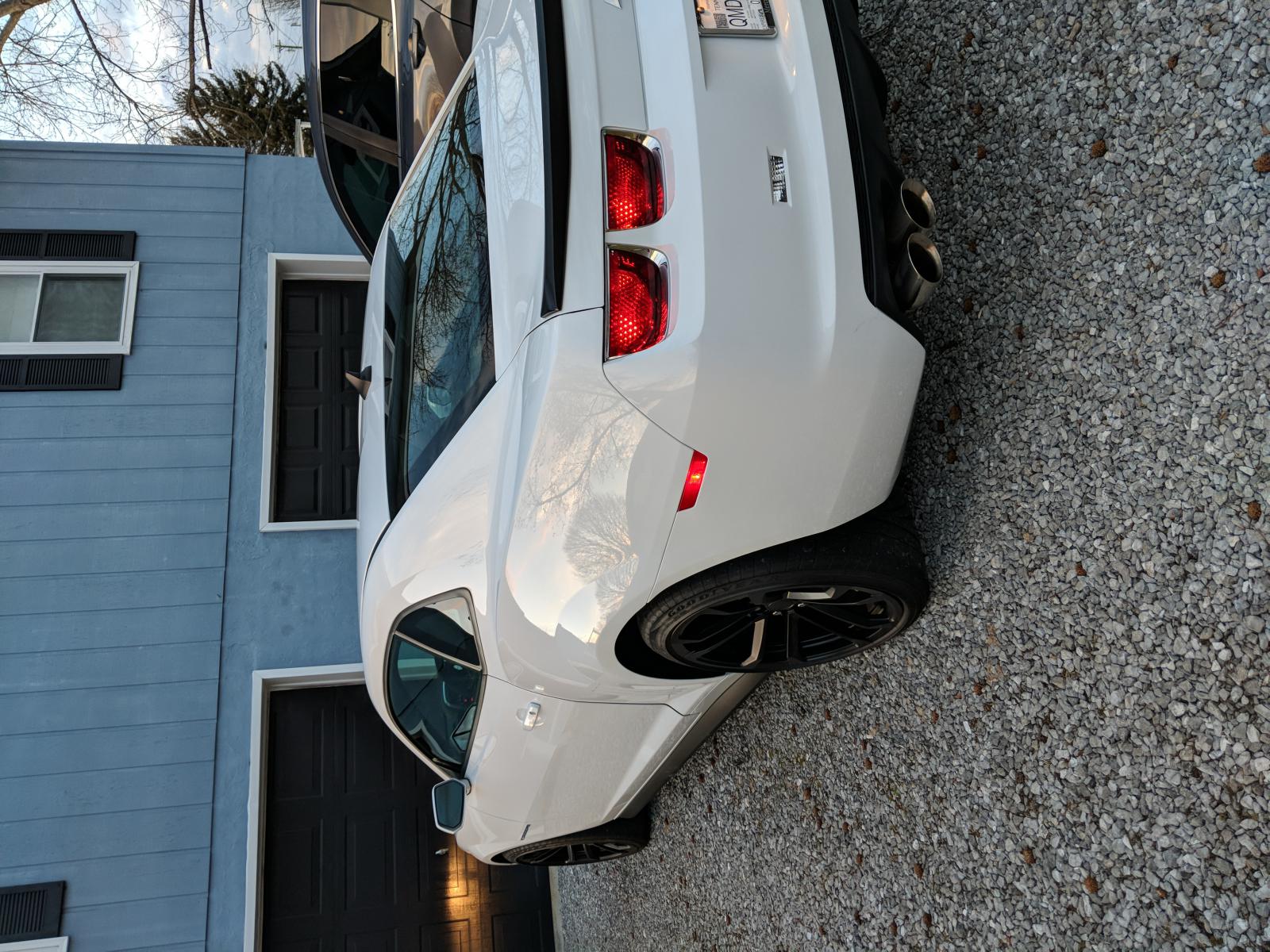

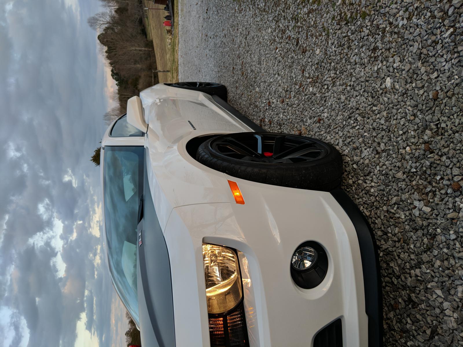

My 2013
KnoxSS1LE is offline   Reply With Quote
Old 01-23-2021, 10:57 PM   #18
KnoxSS1LE
Drives: 2013 SS1LE
Join Date: Jan 2021
Location: Knoxville
Posts: 65
Sorry. Don't know why photos posted sideways ��

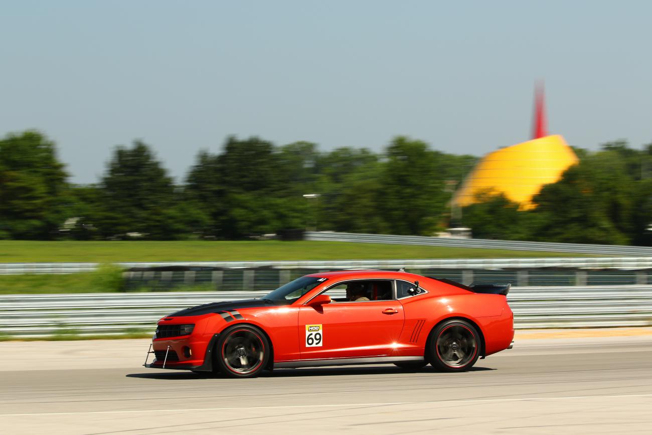

Talk about good lookin
Wow blue, and vegas, your Camaro's look amazing!!
Man your is no slouch either, I followed your intake thread an was really hoping the LOD would be a good road course type of intake but seems like everything leans towards drag racing, so I got a GPI modded intake an will see how it performs.
Orange Krush II
1LE Front sway bar, Splitter, shocks and struts, Z28 dual mode mufflers, Intake, UCA Bushings, and Toresen 3.91 Diff. 1 piece DSS Drive Shaft, ZL1/C7 Calipers, and 32mm JPSS Rear Bar. ASC race spec splitter and wicker. 6th Gen M017 Wheels. Stainless Works 1 7/8 LTs. DSE and PAFDT Suspension components.

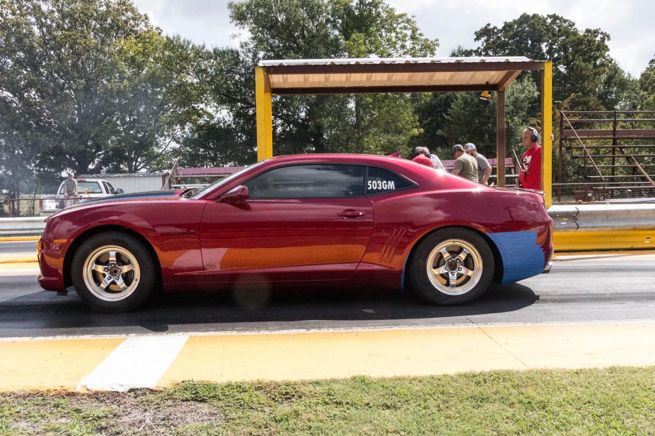

Old 01-25-2021, 09:42 PM   #27
Vegas Bound
Drives: 2013 Sparkly Red One
Join Date: Dec 2018
Location: Hospitality State
Posts: 2,558
Originally Posted by KnoxSS1LE View Post
Very clean! Love the wheels
I got way more miles on my 2013. I just turned 15,000. A lot of short trips down a straight, flat, sticky road.
