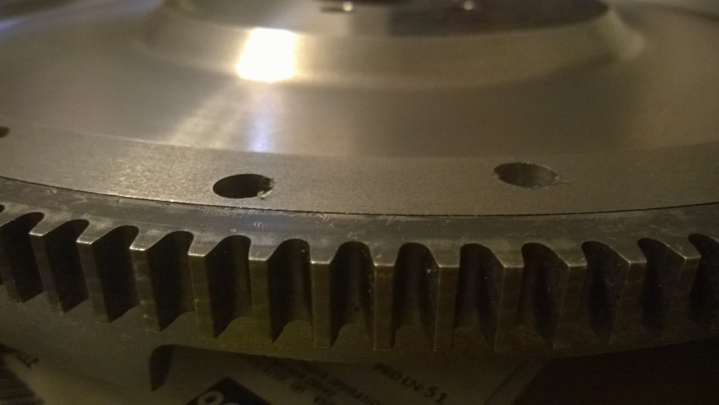

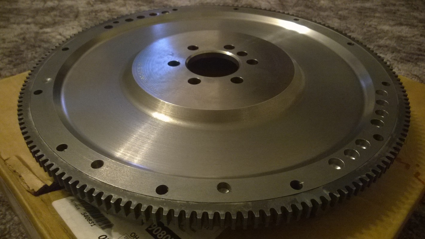

I have a Camaro with basic modes with about 450 horsepower on the rear wheels.
I had a typical problem with LS3 clutch with a non-return clutch pedal.
I don't use the car for drag racing - only for normal riding and I used the LS7 clutch, which I have been driving with for 5 years and has never been a problem.
Only I wasn't just happy with the look of the flywheel, even though it would be hidden.He looked terribly crooked. When they cast it, they probably had a form on the slope.
I leveled the flywheel itself, relieved and let it rebalance.
Of course, I replaced the bearing support and added a remote bleeder.
Good luck
