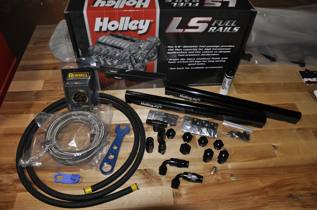

Originally Posted by Joe.G View Post
More Power What length did you order? Did it come with the correct ends so it is plug and play? I would run mine like yours with cross over in the back.
Bo that is I believe the C6 Part number and the one I will use if I do just the rail flip which I am assuming that is what you used it for.
Bee The kit you linked to would still need a cross over line I believe and not sure why it is so much more then the kit Morepower linked to.
I compared the kit I used to the one Morepower went with, and they are two different Holley fuel rails.
Mine (HLY-534-210) is "Holley EFI Fuel Rails" which has a description of:
These machined aluminum EFI fuel rails are capable of handling 1,100+ hp engines. They feature a large inner diameter bore to decrease fuel pressure drop and help cancel out back pulses.
Morepower's (SNE-850013) is "Holley Sniper EFI Fuel Rails" and has a description of:
Holley Sniper EFI fuel rails hit the mark every time--on time! It's not enough to shoot fuel to your injectors; the process must be consistent and precise for efficient engine performance. Holley Sniper kits will deliver the performance, and they feature billet aluminum rails with a black anodized finish and a laser-engraved Sniper logo. If your target is the optimum delivery of fuel, equip your manifold with Holley Sniper EFI fuel rail kits.
Here's a picture of everything I had gathered before starting the project:
But to answer your question, yes...a crossover line is needed to connect both fuel rails together. I went with a T-fitting on the passenger side so I could continue running the line along the firewall to connect to the factory lines.

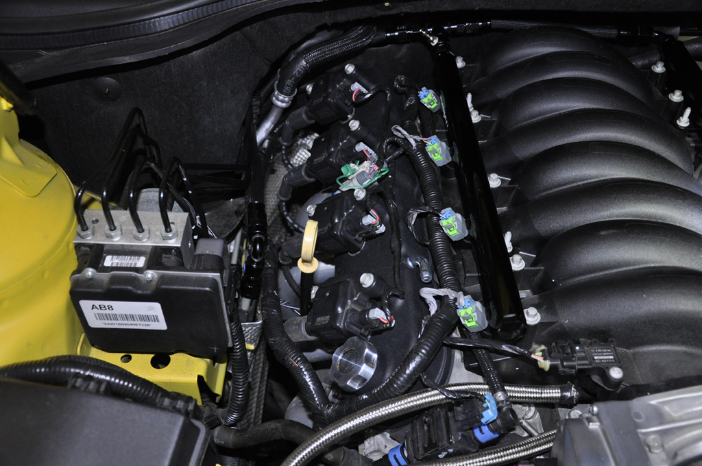

This one I took during the install to show how I routed the lines:

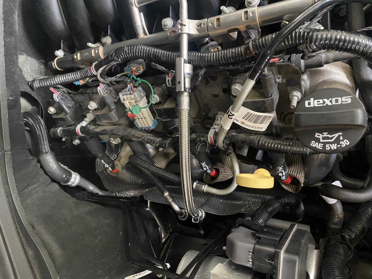

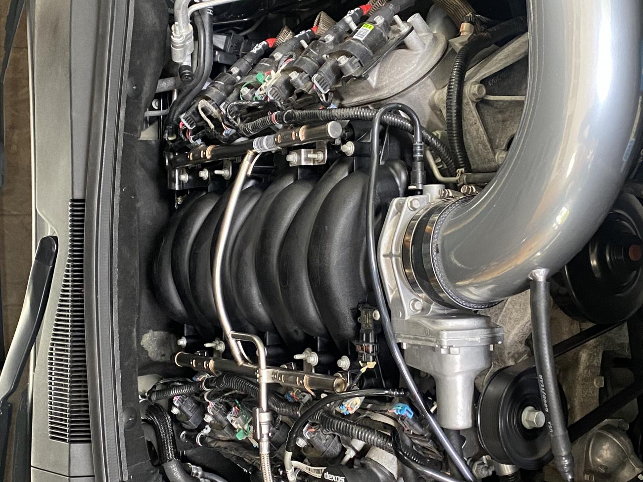

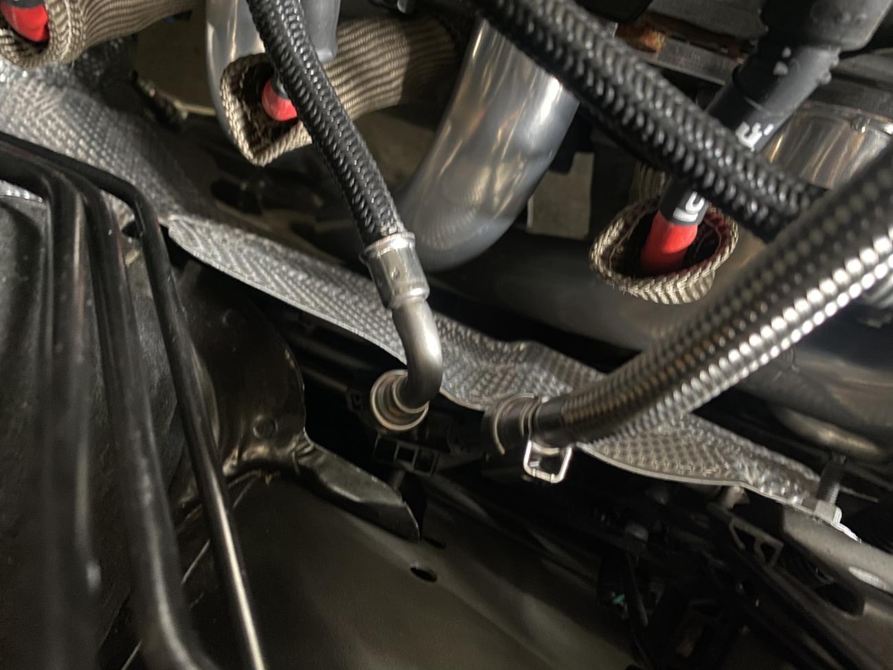

Installed the GPI intake and flipped the rail, I did have to take the clip that holds the hard lines to the car off the stud to get the line to fit, it was probably a 1/2 to short.

I should have left the Drivers side re bracket off, The guides I read said to leave the Drivers side on, Pass side had to be removed for Pressure port clearance. Now I am reading the other can be left off ( I figured it could but didn't ) Can't take it off now because rear intake bolt. Not a big deal but every little bit helps to clean up.
