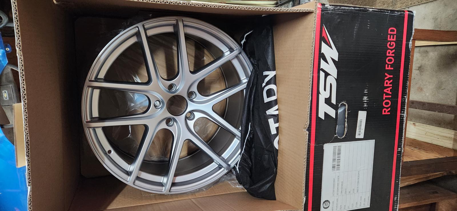

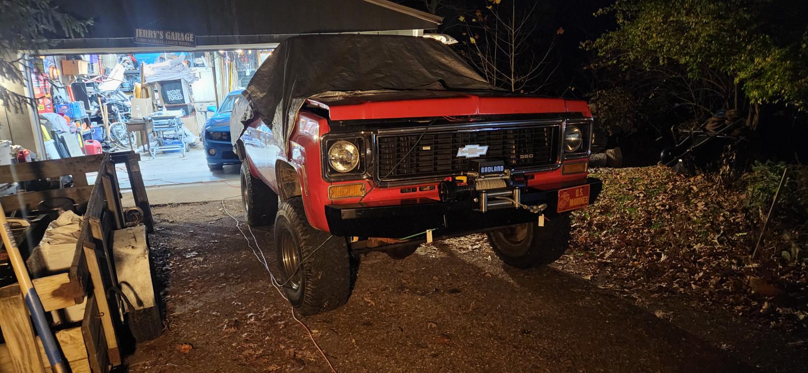

Weather is turning cold next week. Put SweetneSS is the garage for the 1LE+ upgrade. I also bought new wheels so that I can go to a square set-up. That means my '74 Blazer is bumped to the driveway and tarped to cover the full convertible.
