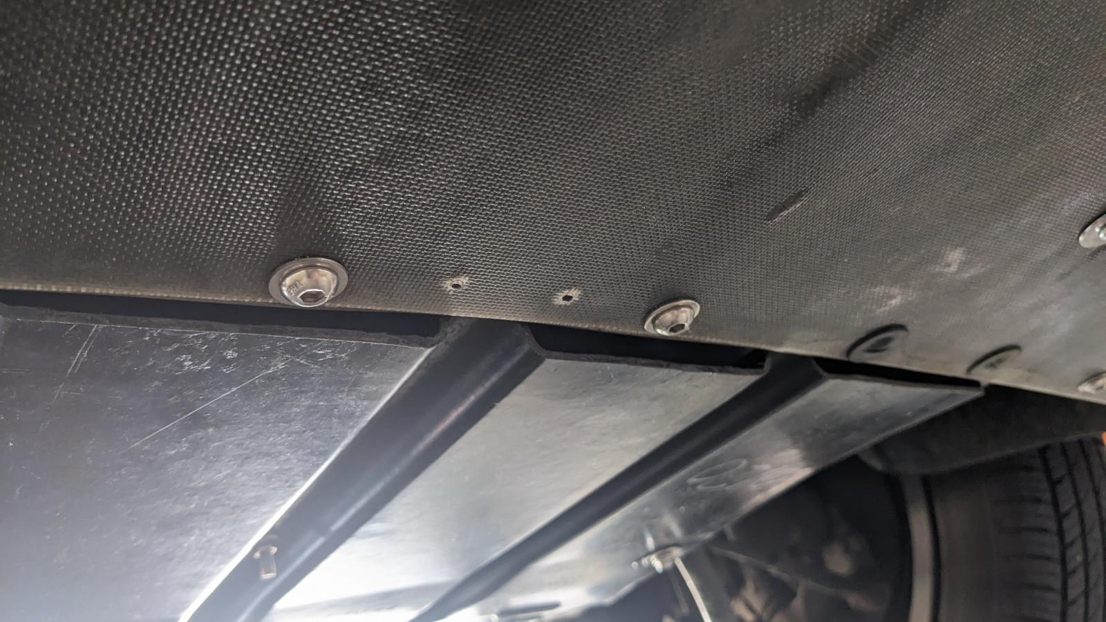

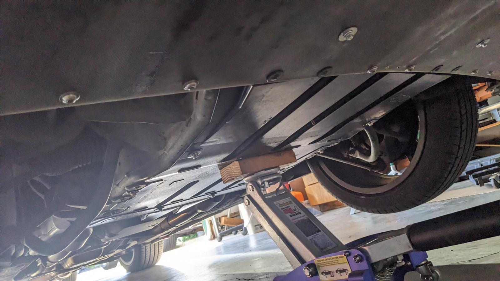

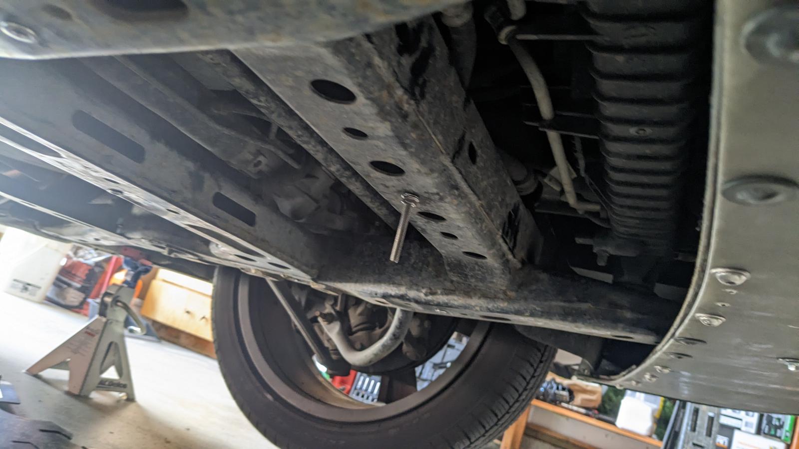

Wrapped up the undertray install yesterday, drilled all the holes out just a tad biger and installed the rivnuts, kinda felt a bit uncomfortable drilling holes in support beams but if GM put those there in the future gens then it should be fine I hope.
Because of the cutting the front of the tray sat just a little low, so I stalled a long threaded rod to bring it up just a hair and close the gap, seems to have worked out good.

Also not sure if here or in another thread but I asked if I could use the jack point on the main bar even with the tray on and seems like it's fine, I'll keep going until something breaks
Attachment 1128848
Attachment 1128851Attachment 1128852Attachment 1128853
Attachment 1128854
Looks really good. I actually really like how you installed it with the rivnuts and threaded rod. That tray isn't going anywhere! I want to do something similar for my rear diffuser.
