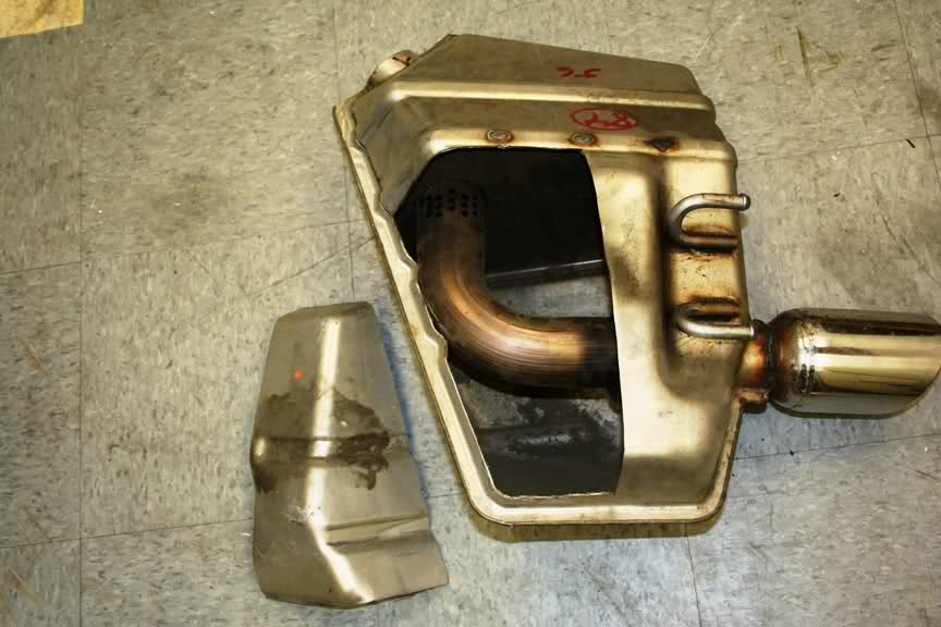

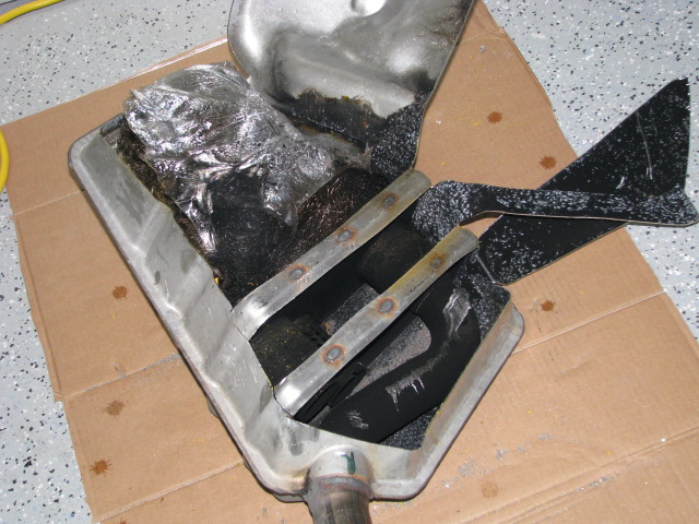

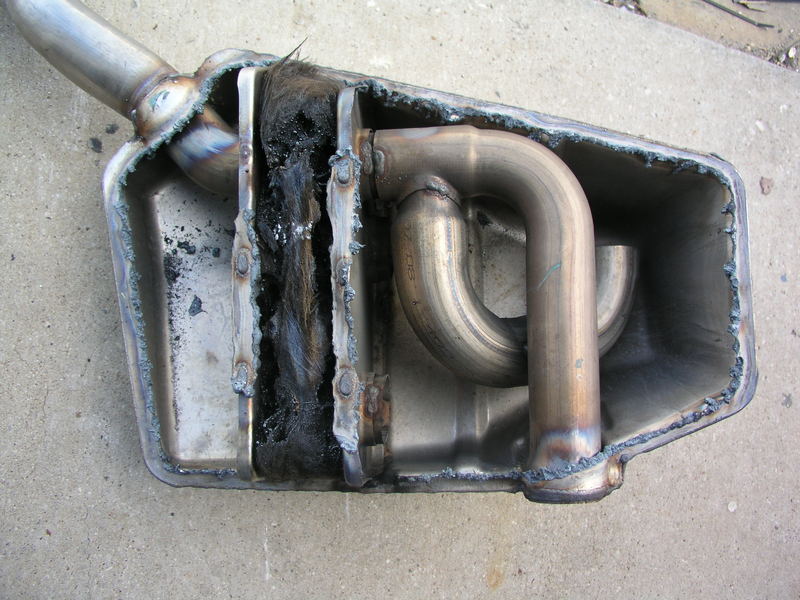

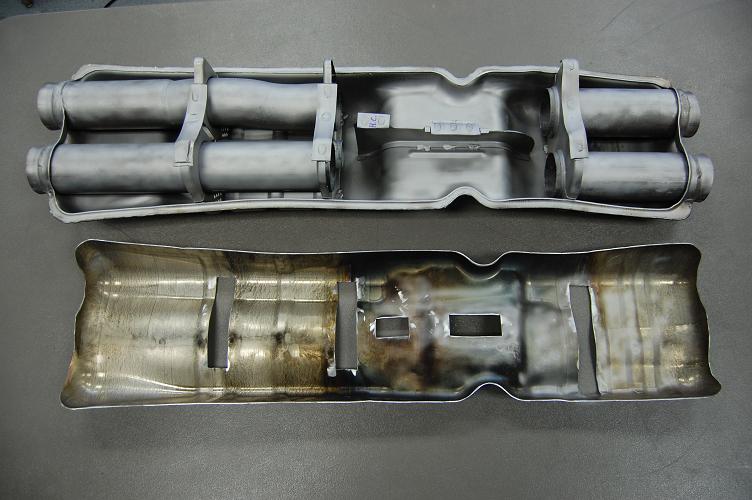

And for you curious folks who like to see the difference in the muffler internal configurations, dug these up.
First one is the L99 Resonator, second is the V6 muffler, then the L99 muffler, last is the LS3 muffler.
Attachment 1136511
Attachment 1136512
Attachment 1136513
Attachment 1136514
Thanks for the pics!
