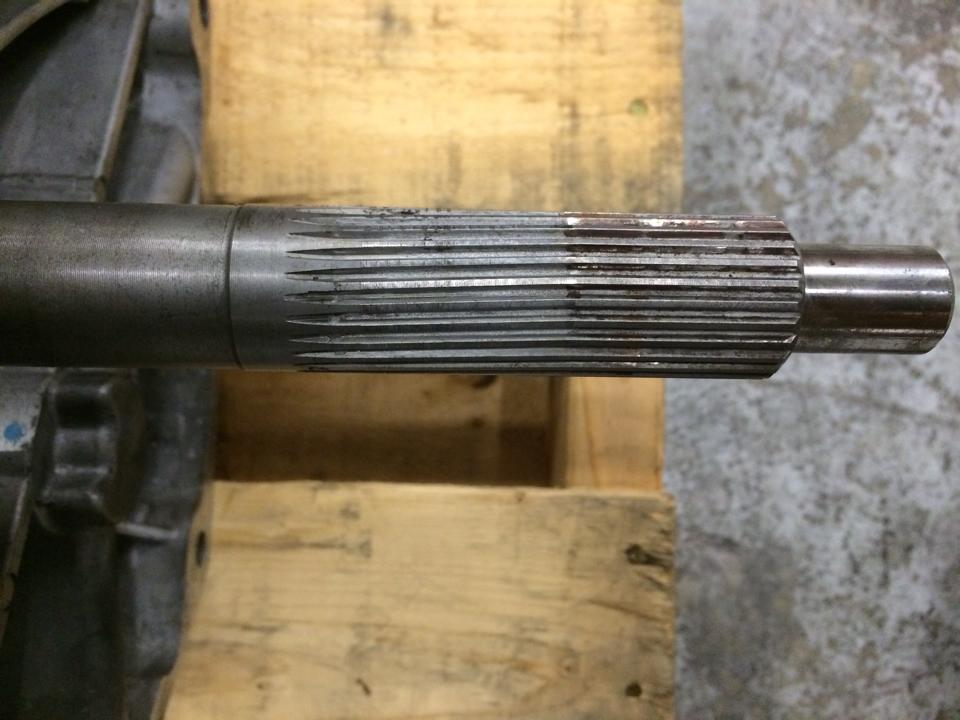

I twisted a 300M output shaft… (Dead hook on slicks at 6000 rpm at Indy) builder of said shaft said it couldn’t be twisted… I got pictures… He wanted the whole trans back…He even paid return shipping after seeing the output shaft image…His autopsy was a mess to say the least… Not only was the output shaft twisted, the main shaft and various parts inside the trans were so twisted , he couldn’t get the forged gears off the shafts, (I went 200+ mph a few months later with that same trans, before the noted shaft twist, only pulling it out after hurting the motor at the mile, which was when we found the twisted shaft) so I had to purchase an entire new trans. All the gears were forged except 6th and reverse… Shafts, all forged… etc etc etc… Never hurt that one…

Good info sir. How much hp were you pushing when you twisted that output shaft?
~~ 1300+ rwhp on boost, call it 1700 on spray, and it only sprayed at WOT in second, third…. Obviously I wasn’t at full HP sitting on the line but it was a good bit…
