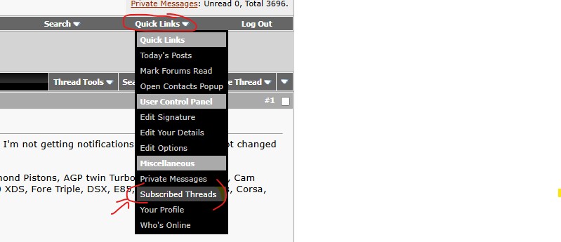

My advice is to use the "Subscribed Threads" link as your bookmark to Camaro 5
Attachment 1163415
I've used it for years and never had to subscribe to e-mails to know where my active threads are.
1st place I go every time I visit the site.
