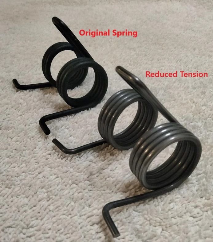

The reduced tension spring will be a direct replacement for the OEM. This spring will provide no functional pedal assist, but has enough tension to hold the pedal up. It is a thinner spring wire, and has an extra loop on each side.
Here is a picture of the one I make for the C5 Corvette:
The reduced tension spring for the Camaro will be dimensionally the same as the OEM, and will snap into in the same mount points as the original.

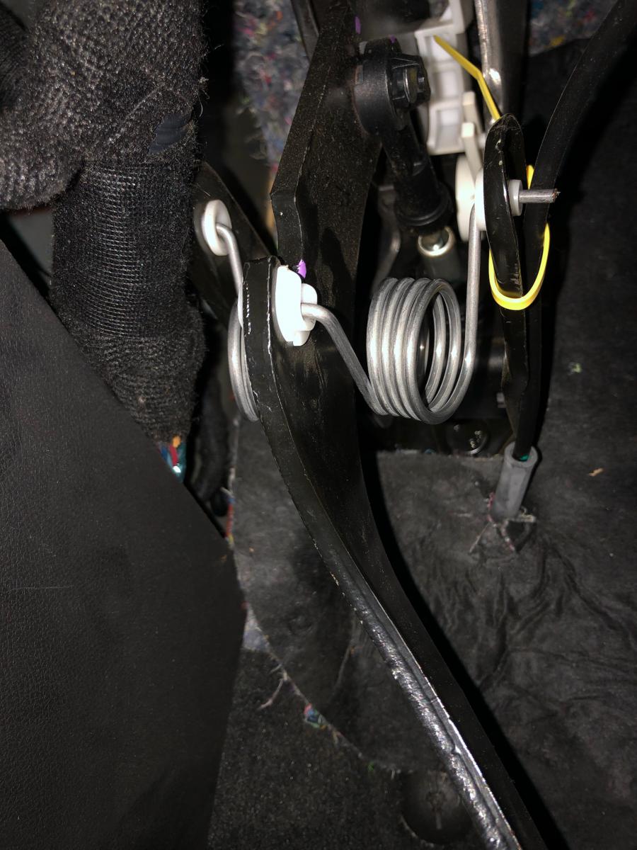

New production 5th gen Camaro Clutch Pedal Spring has arrived and has replaced the prototype spring in my buddy's test mule!

Name:  5th Gen 1.jpg
Name:  5th Gen 2.jpg
MidBubSC is offline   Reply With Quote

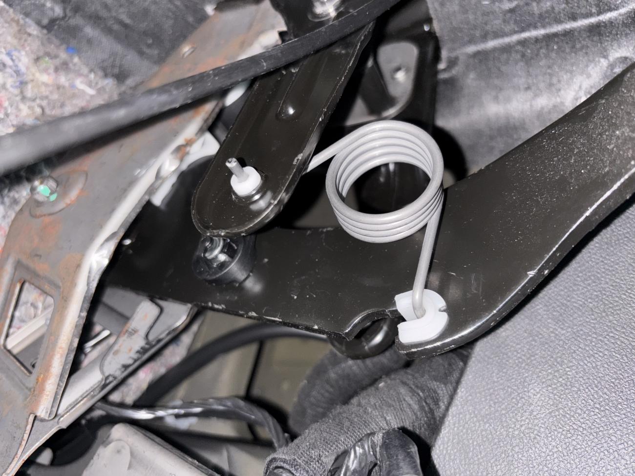

The picture with the springs is what I DIY’d for return springs. The one in the photo where I’m running my DIY return spring setup, is the super heavy one. Makes you feel like you’re stepping on a 15+ lb setup, and it’s hard to modulate the clutch pedal because it pulls back so hard. Definitely didn’t like it, but got used to it, and it saved me a few times when my clutch master cylinders would constantly fail….
TheBrightSide is offline   Reply With Quote
