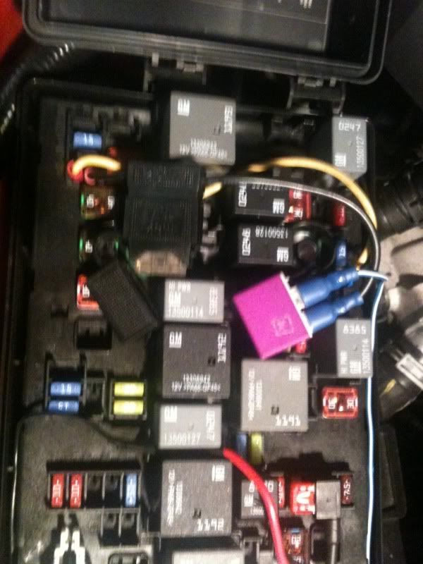

I fixed it. Fuse 40 was ABS, so i took out fuse and replaced this with a relay (standard closed) the activating-plus from the relay comes from the line-lock solenoid.
So when the linelock is activated the relay opens and the ABS gets no power. 1 light goes on on the dash, the one with 2 stripes behind the car which is correct
After i release the linelock button the 3 lights go on and reset directly so t.c. is on and the tractioncontrol/competitive mode(launch control) button works without restarting the car.
The red wires are were the fuse was. The blue provide minus and plus(switched). I make everything nice later, this was for testing.

You should still have a fuse ''in line'' on one of your 2 red wires... as of now, your system is not protected... dammage could occur...

Yes fuse is needed, above was for testing if my theorie worked in real.
So i looked on which side the plus 12v was and on that side i put the fuse (same color white) in.
I tested the 12v plus also for the linelock and turned the powertake wire with fuse so the fuse was working correct. There is a good way and a wrong way to mount these.
Picture of how it is now:
And a film were u can see one light burning (line lock on)
and then (line lock off) 3 lights burning and the quick reset of them.

I got a yunkjard so i just got one with 5 plugs.
A picture is more than words:
85 to ground
86 to linelock +
30 and 87A to were the fuse was.(fused on powerside)
