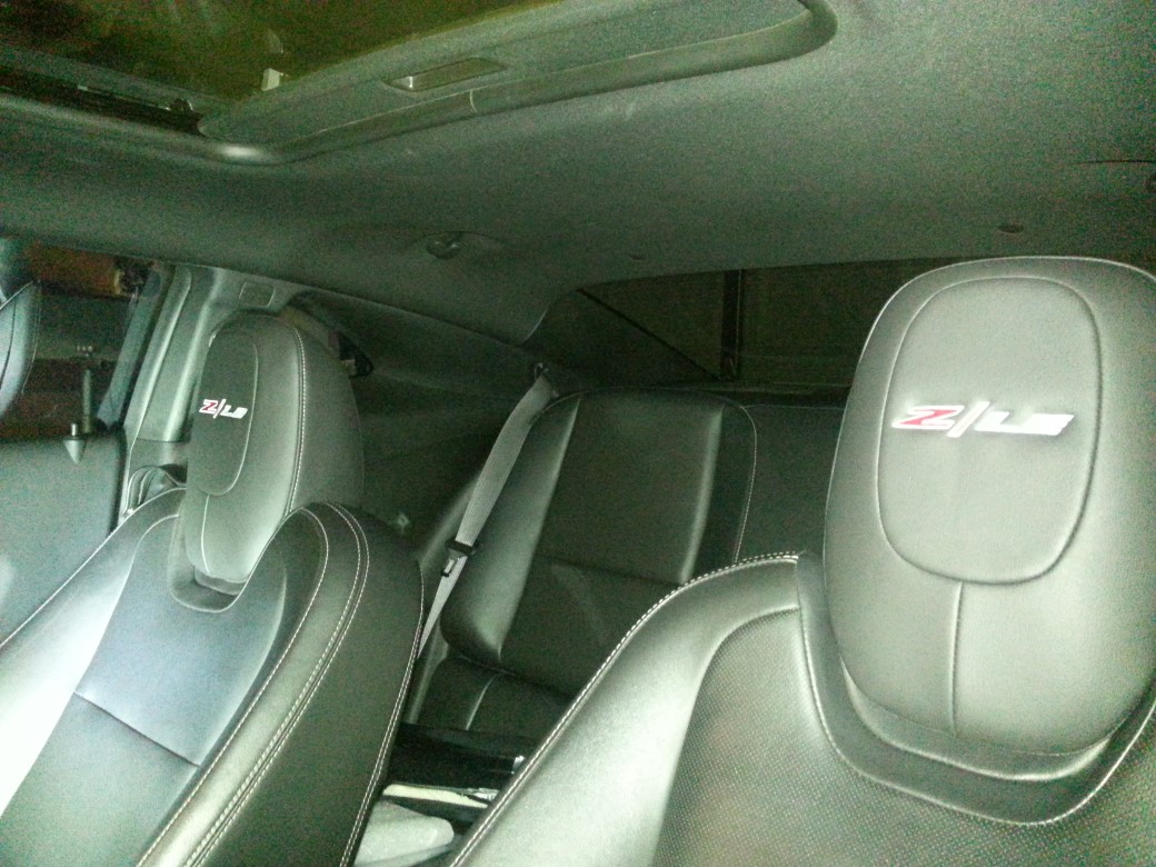

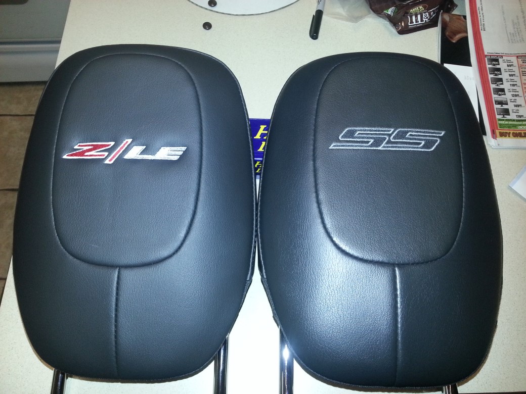

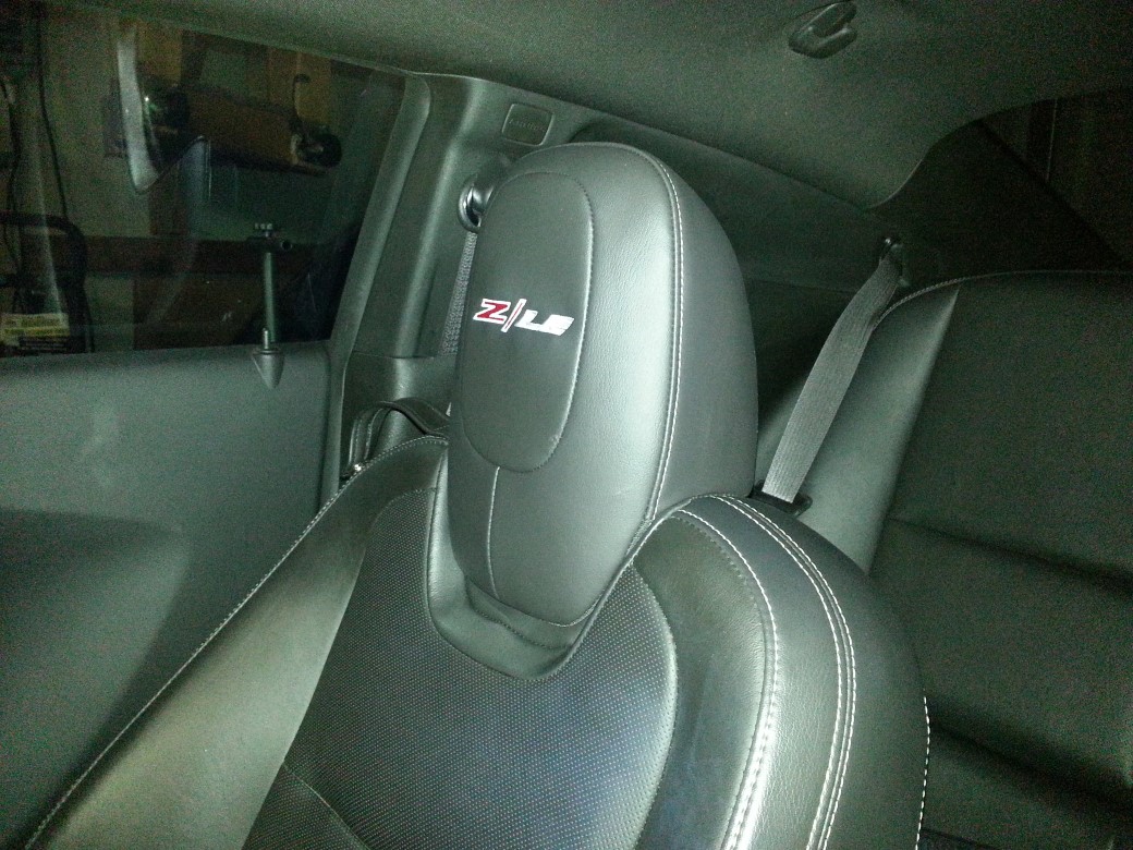

Headrests -- Custom Embroidery:
SS ones (looks like I'll sell these):
Getting there!
-Don

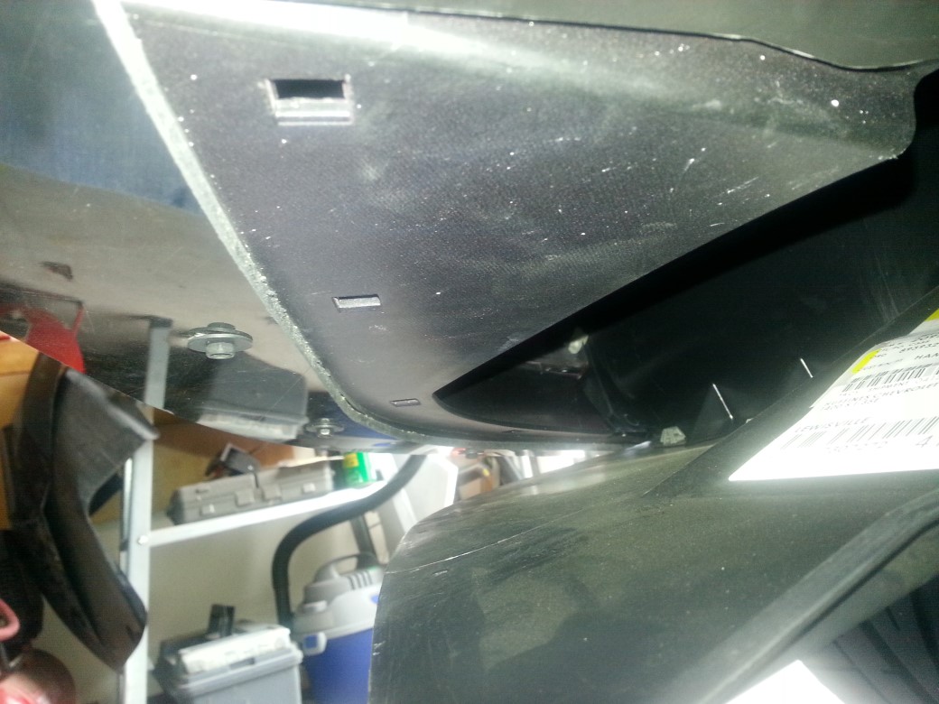

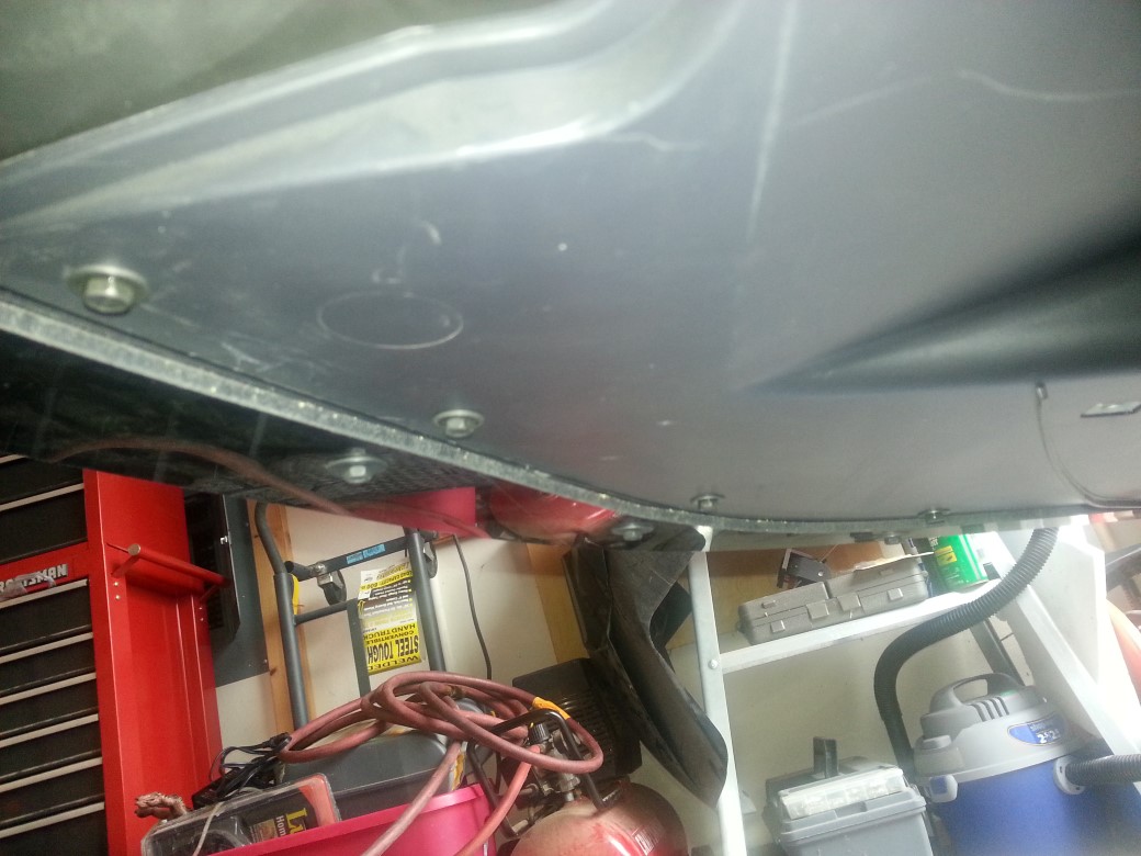

OK, finished bolting up the splash shield to the bumper
Got these from clipsandfasteners.com:
Much cheaper than gm -- $4 a bolt or a box of 100 for $12 -- yep
So, I had to add the clips in these square areas:
Perfect fit -- then bolted them up (both sides -- takes 8 clips/bolts):
