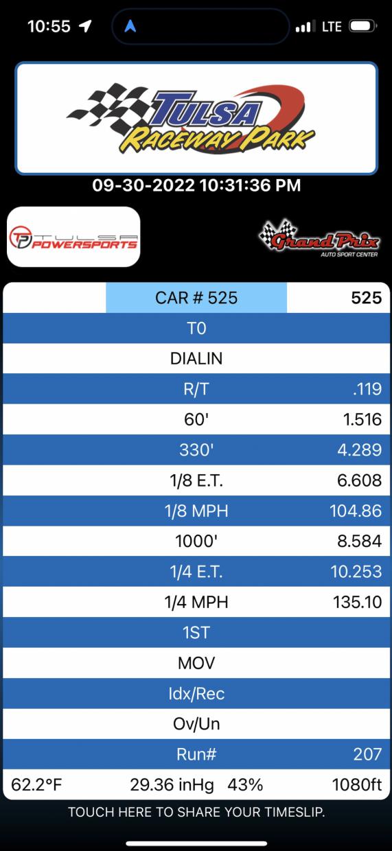

The first 4 passes just spun even with dropping the air pressure. Still had best ET's with spinning so a little improvement anyways. lol
After the 4th pass we made changes to the rear shocks to allow more compression and slow the rebound down.
On the 5th pass I goofed and left in second gear and then the accessory belts decided they were done just past the finish line. The A/C belt was completely gone, the drive belt was still there just hanging out and didn't look damaged much at all. Thinking the A/C belt had enough and it took the drive belt off. I've been carrying a spare belt so got it put on just in time to make 2 quick passes before they closed.
6th pass I dropped the tire pressure even more and it hooked! 10.327 @ 135.39.
Went straight back to the lanes and the 7th pass was 10.253 @ 135.10 with same tire pressure. Here is a video - https://youtu.be/dIPSdjxuD5o
Very happy to finally get it to hook and looking forward to getting some more passes in while the weather is cooling off!

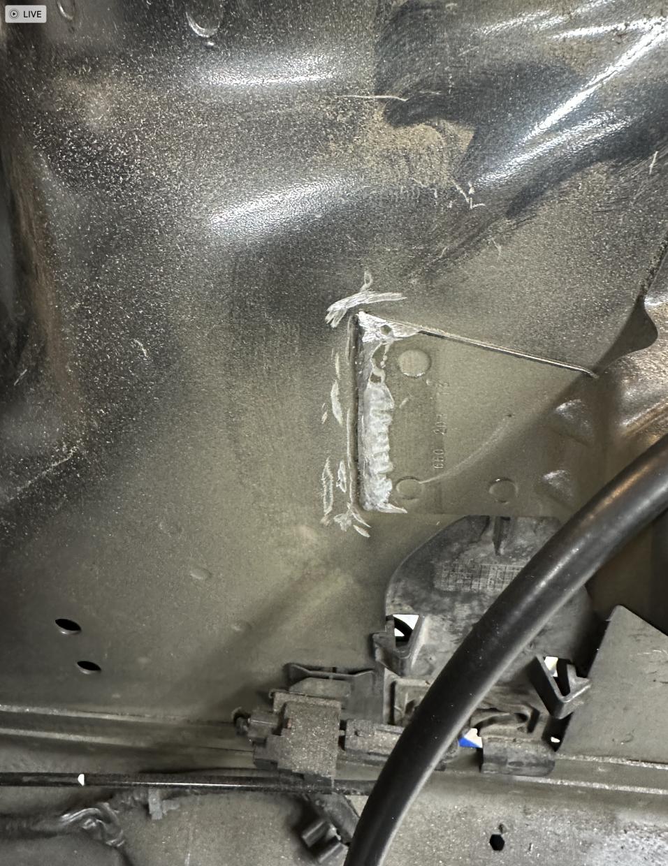

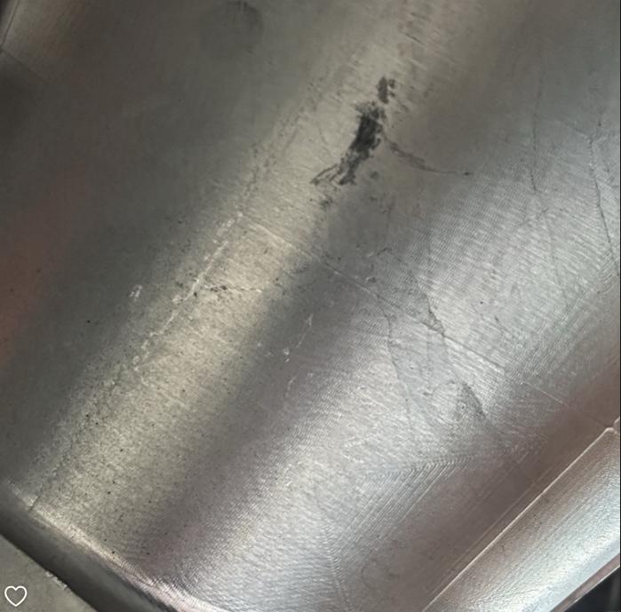

Had the car up in the air looking at things and noticed the driveshaft and the gas tank heat shield were starting to not play nice with each other. Very small amount of rubbing on both, more scratches than anything.
I thought about just removing the heat shield, but it also serves to hold the emergency brake cables into the plastic retainers on the side of the gas tank. Since I'm running 15"s and have the cables tied back to clear the wheels, the cables tend to pop out of the retainers and the heat shield helps keep them in place. So I modified the heat shield just a little bit.
The oblong hole towards the front allows some extra room for the yoke arms which is where a light scratch was on both the shield and the arm. I left a small section of the middle in for rigidity and then removed the remainder of the upper portion of the shield.
After first cuts and fitting
Name:  Screen Shot 2022-10-24 at 6.43.24 AM.jpg
Made some more cuts towards the rear - looks better
Name:  Screen Shot 2022-10-24 at 6.43.13 AM.jpg
After final cuts/fitting and in place
Name:  Screen Shot 2022-10-24 at 6.43.01 AM.jpg
Plenty of clearance now. I will check it again after the next time I go to the track in the next week or two.

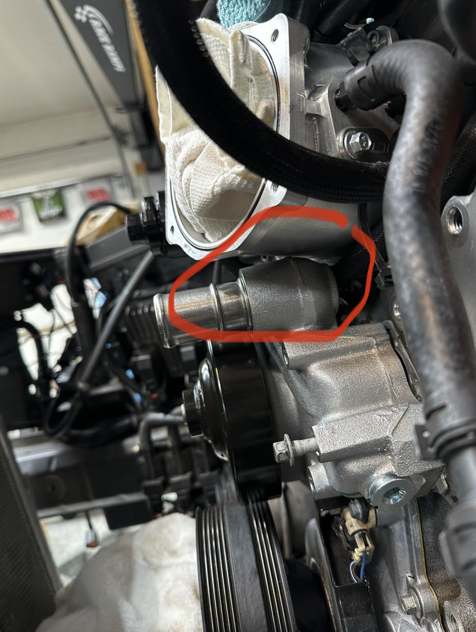

Its been a while again.. lol.. Anyways, during the summer I was collecting parts for a forged 416 build and in November all the parts finished arriving. So early December after recovering from Covid and finally starting to feel a little better, I started taking the car apart. Before getting too far though I wanted to test fit the LSA 3 belt with Maggie Heartbeat to see if I was gonna have any issues.
I did find 2 things had to be done for it to work right -
#1 the LSA water pump water inlet was hitting the throttle body inlet
Name:  Screenshot 2023-02-11 at 6.28.19 AM.jpg
Marks on the bottom of the inlet -
Name:  Screenshot 2023-02-11 at 6.28.30 AM.jpg
After grinding the flashing off of that it looks to be good to go -
Name:  Screenshot 2023-02-11 at 6.28.47 AM.jpg
Everything mounted up - Griptec 3.20 10rib upper pulley, DSX Triple S/C Idler Pulleys, a GM LSA tensioner with 10 rib pulley and a ICT 6 rib Idler pulley w/Bracket.
Name:  Screenshot 2023-02-11 at 6.32.08 AM.jpg

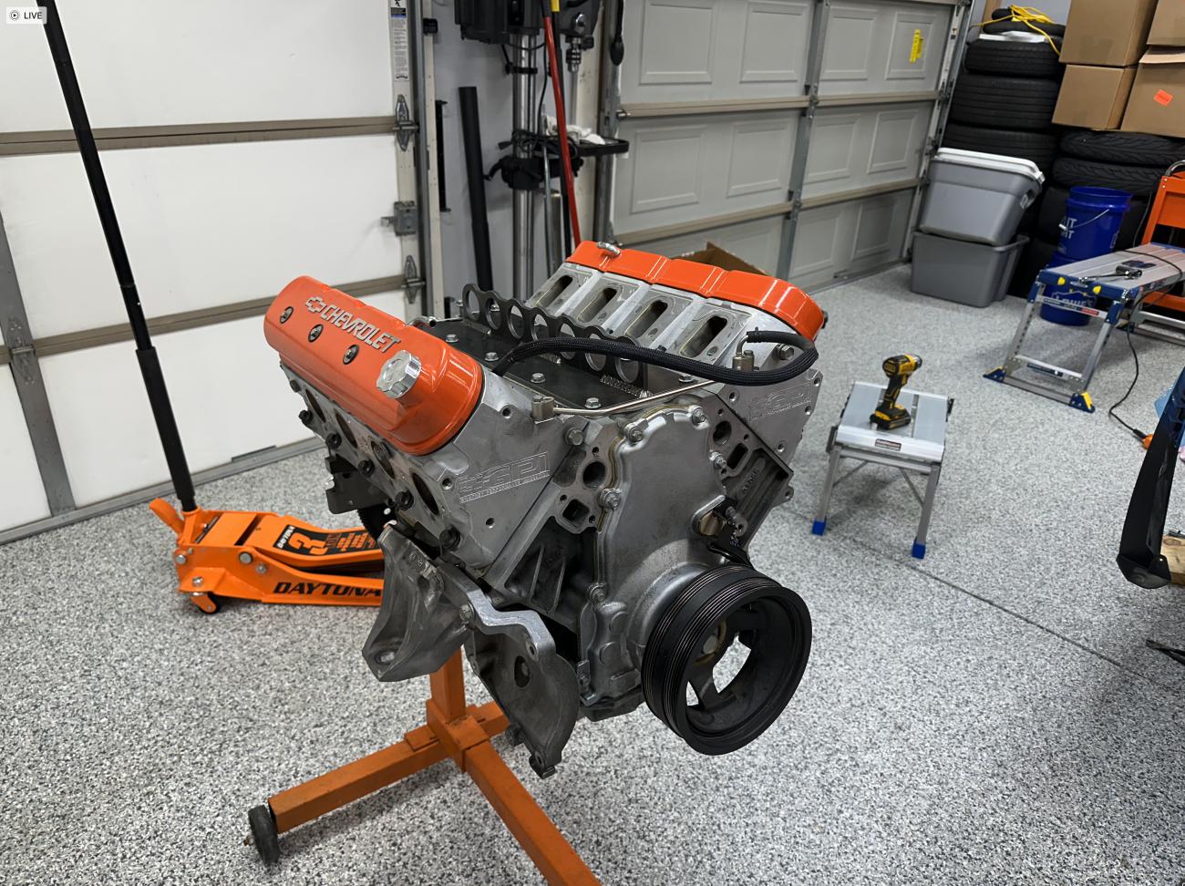

Next was to get the engine & trans out -
Name:  Screenshot 2023-02-11 at 6.14.14 AM.jpg
Name:  Screenshot 2023-02-11 at 6.14.21 AM.jpg
Name:  Screenshot 2023-02-11 at 6.14.27 AM.jpg
Name:  Screenshot 2023-02-11 at 6.14.33 AM.jpg
GPI 416 w/GPI S/C Cam, GPI Ported Heads & Tuned by Ben, Holley Dominator ECU, Mag Heartbeat, ZL1 Fuel Pump/DSX Aux Pump, NW 103 TB, FIC 1650's, Alky Meth, Rossler T400 w/t-brake, Circle D Converter, Kooks Headers, Viking Coil Overs & all the BMR Goodies in the rear, Zl1 3.23 Diff, DSS Axles, Wiles Racing Driveshaft, Hendrix Offset Diff Bushings, AFE Solid Subframe Bushings, 875HP/843TQ 5FDP

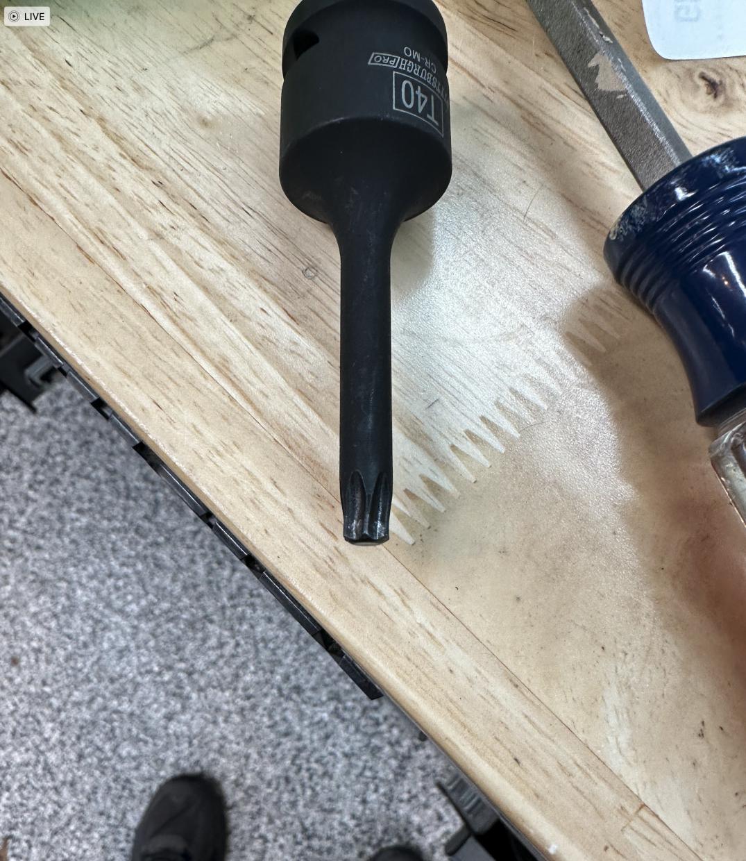

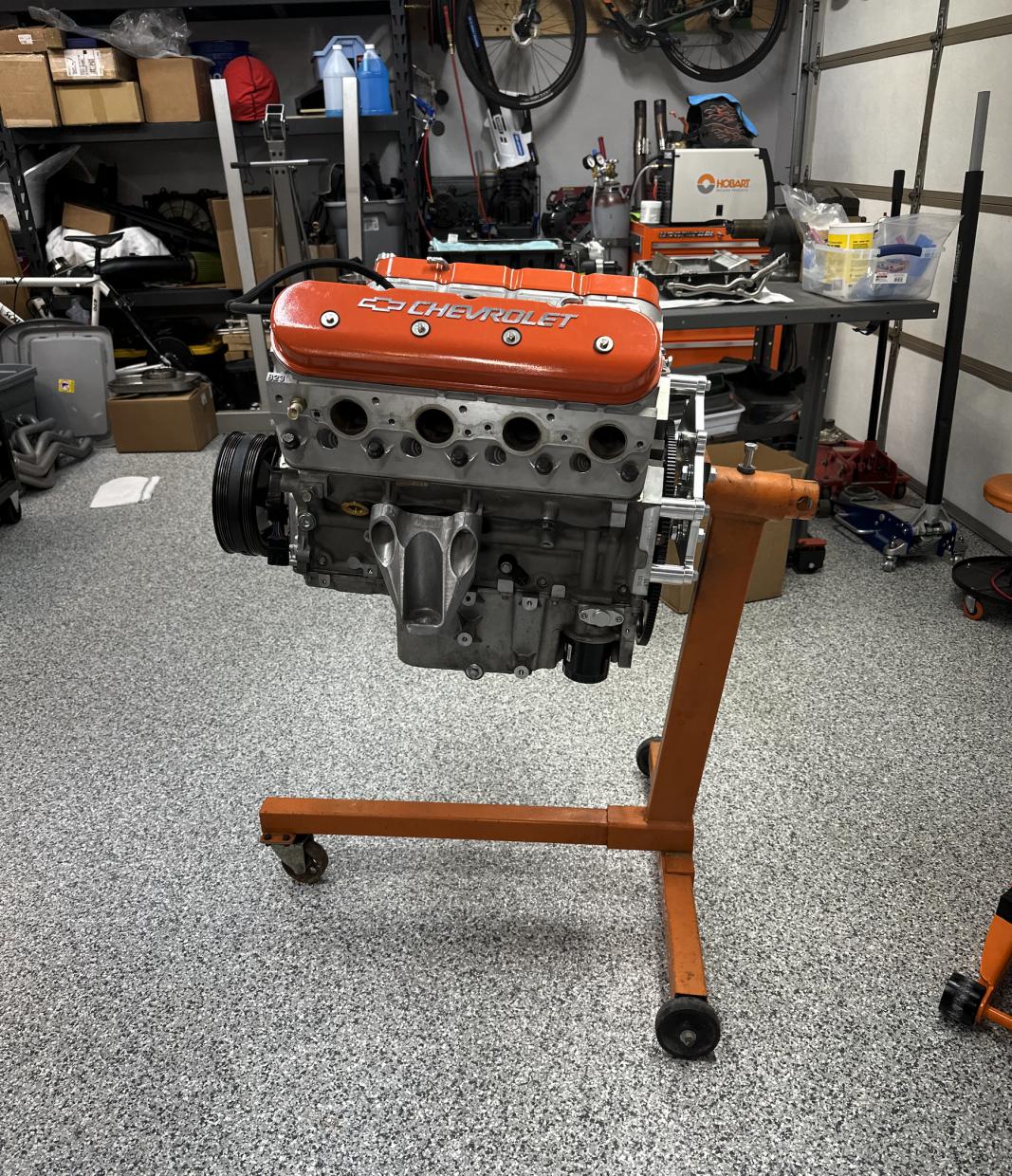

While tearing the engine down everything was going smoothly until I went to pull the cam out. There was one bolt in the cam retaining plate that just wouldn't give. Ended up twisting every torx bit I had trying to get it out.
Name:  Screenshot 2023-02-11 at 6.14.56 AM.jpg
Ended up welding a nut to the bolt head and got it out finally.
Name:  Screenshot 2023-02-11 at 6.14.49 AM.jpg

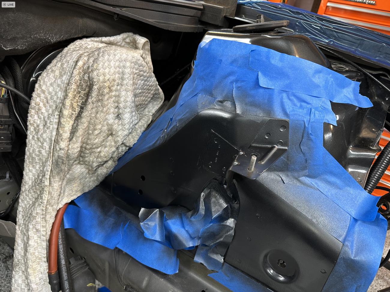

Then working on relocating the positive battery jump connector/contraption/thingy... lol
Name:  Screenshot 2023-02-11 at 6.18.03 AM.jpg
After cutting it off.. I left the tab with the stud on it as I use that to mount the Mighty Mouse Catch Can.
Name:  Screenshot 2023-02-11 at 6.18.23 AM.jpg
Name:  Screenshot 2023-02-11 at 6.18.15 AM.jpg
Masked and primered
Name:  Screenshot 2023-02-11 at 6.18.42 AM.jpg

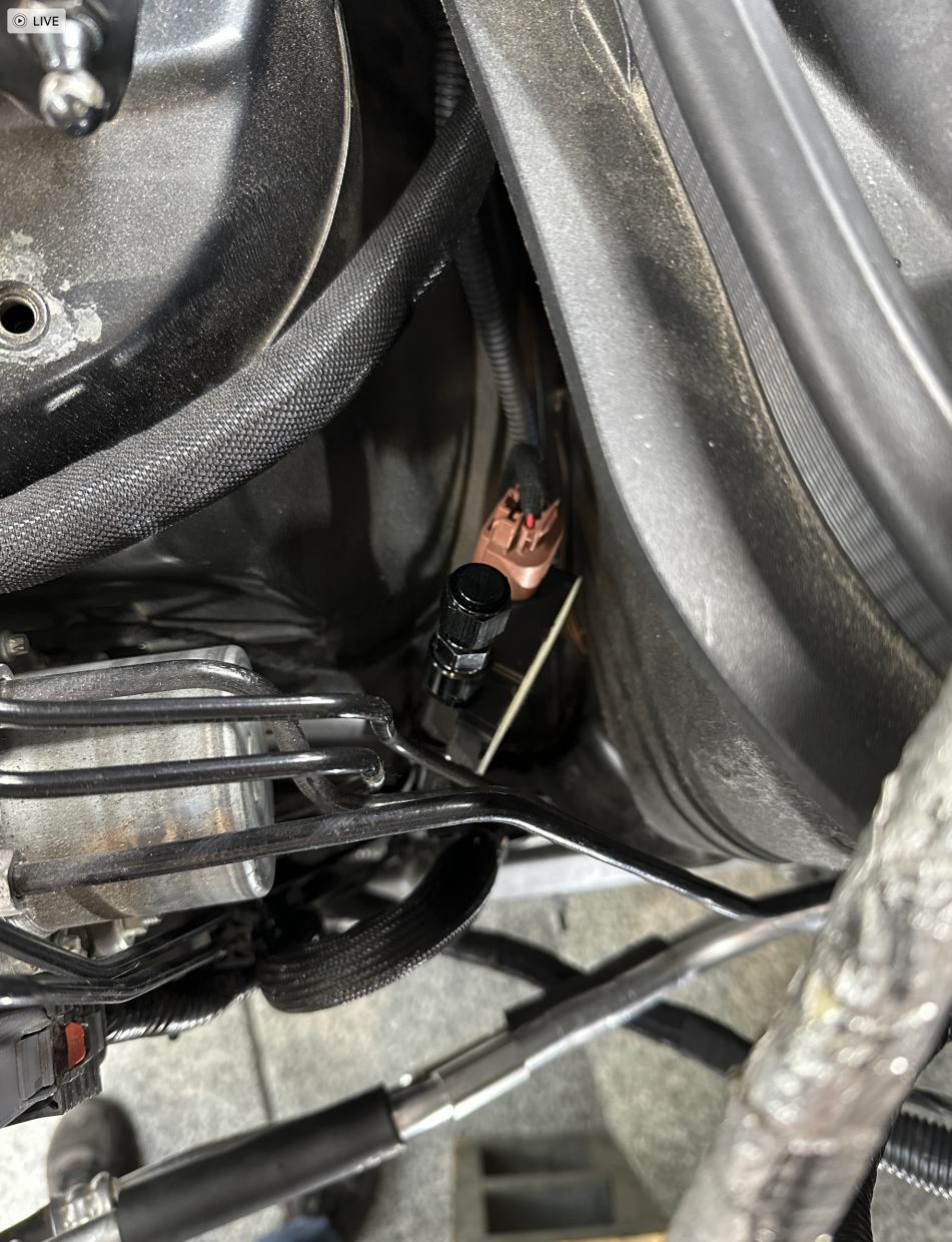

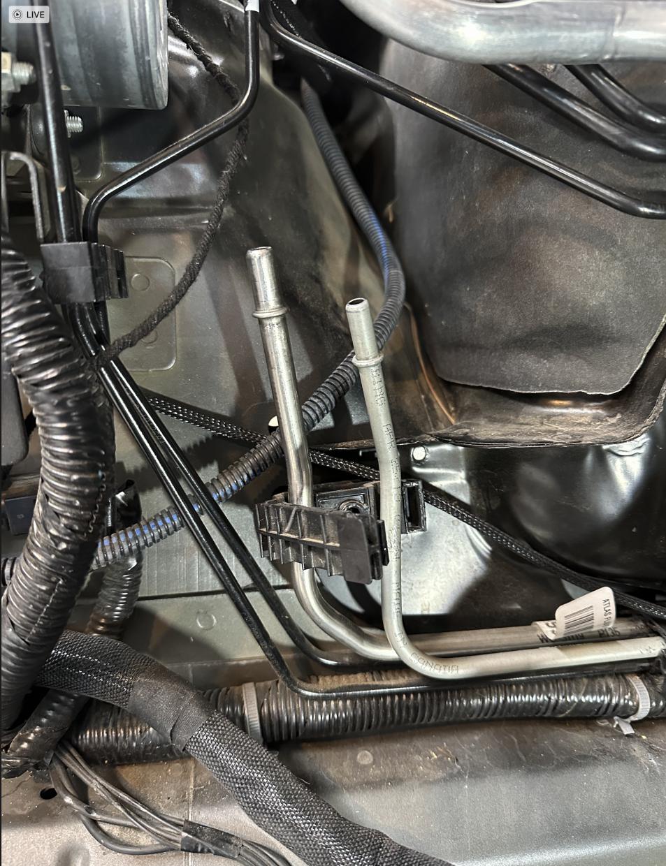

Next up is make a slight bend to the fuel supply line so it will be in the little cubby hole between the shock tower and firewall.
Name:  Screenshot 2023-02-11 at 6.16.44 AM.jpg
Line bent towards the passenger side -
Name:  Screenshot 2023-02-11 at 6.16.51 AM.jpg
E85 sensor back in place
Name:  Screenshot 2023-02-11 at 6.17.04 AM.jpg
Name:  Screenshot 2023-02-11 at 6.17.16 AM.jpg
Looks much better and just as accessible.
