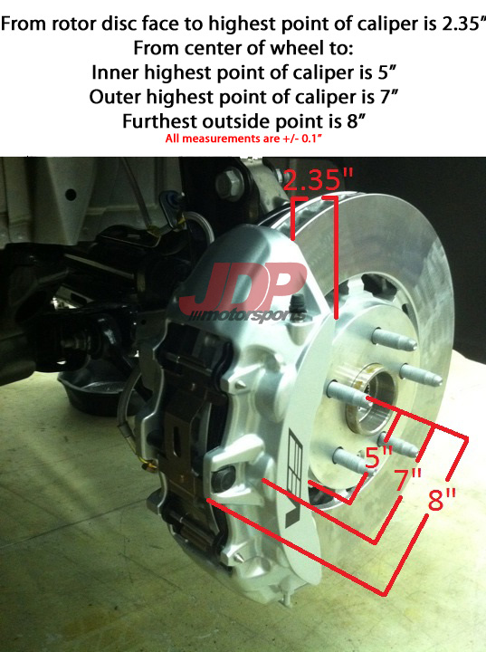

Does anyone know the caliper overhang on these guys front and rear? I'm looking for the distance from the rotor friction surface to the outer face of the caliper. I need this for wheel spoke fitment.
Thanks,
John

Here are some measurements for the front calipers. The rears are just the stock Camaro SS calipers.
- Jeremy
