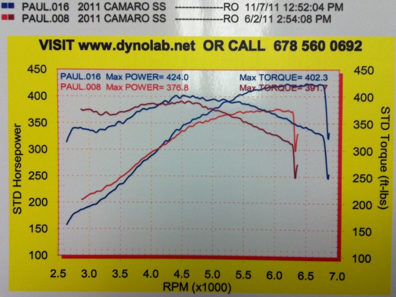

OK, here we go:
+48/+11 ... about what I was expecting.
Note for the dyno numbers:
- both runs were with TC locked.
- both STD corrected (SAE is about -5hp).
- 376 run was with 18" rims and DR's.
revved to 6200
- 424 run was with stock 20x9 and 275's.
revved to 6800.
Padre

Posts: 2,580
Originally Posted by Padre View Post
OK, here we go:
Attachment 303798
revved to 6200
revved to 6800.
Padre
You should get your 11 sec slip now! Ima guess 11.60@ 117. Good luck!
Wow....I was pretty close! Hit the mph dead on. Lol. Good job. You'll get some 60's and maybe some 50's out of it. Pssst.....maybe try some long tubes. If you don't pick up any....we can lay the long tune thing to rest.
