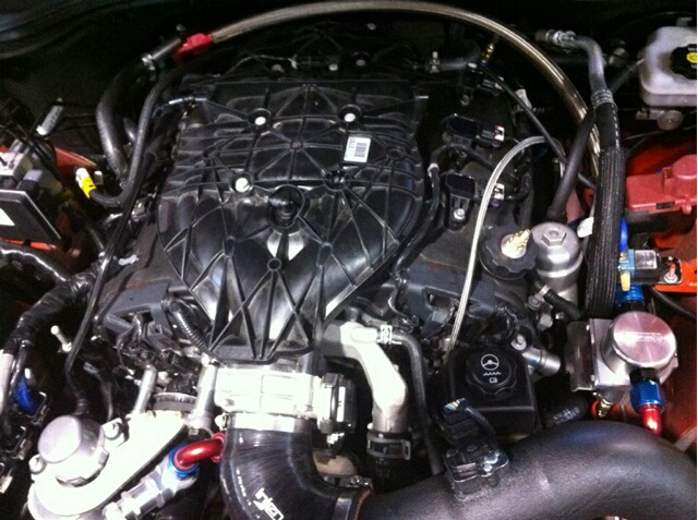

Originally Posted by KMPrenger View Post
One thing about the LFX....that intake sure ain't purty lol. Gotta use an engine cover with those things.
Yeah, just open it will fit with all those vacuum lines running around.

Originally Posted by GretchenGotGrowl View Post
Back to dual catch cans.
Attachment 463194
is there a reason for the dual can setup vs a single can with dual ports?
Just being safe given we are going to pull a good vacuum on it at the track. We were getting so much oil going through the baffle that when we put a vacuum on it was gushing through the catchcan and maxing out the oil return system. That lead to oil backing up in the turbos. So, we have done what we can to not pull oil out with the vacuum and the first catch can will pick up what we do, then the second can should catch the vapors and keep everything nice and clean.
