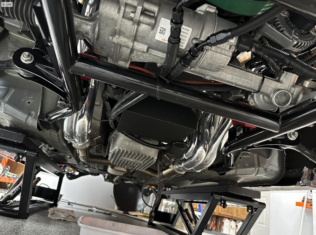

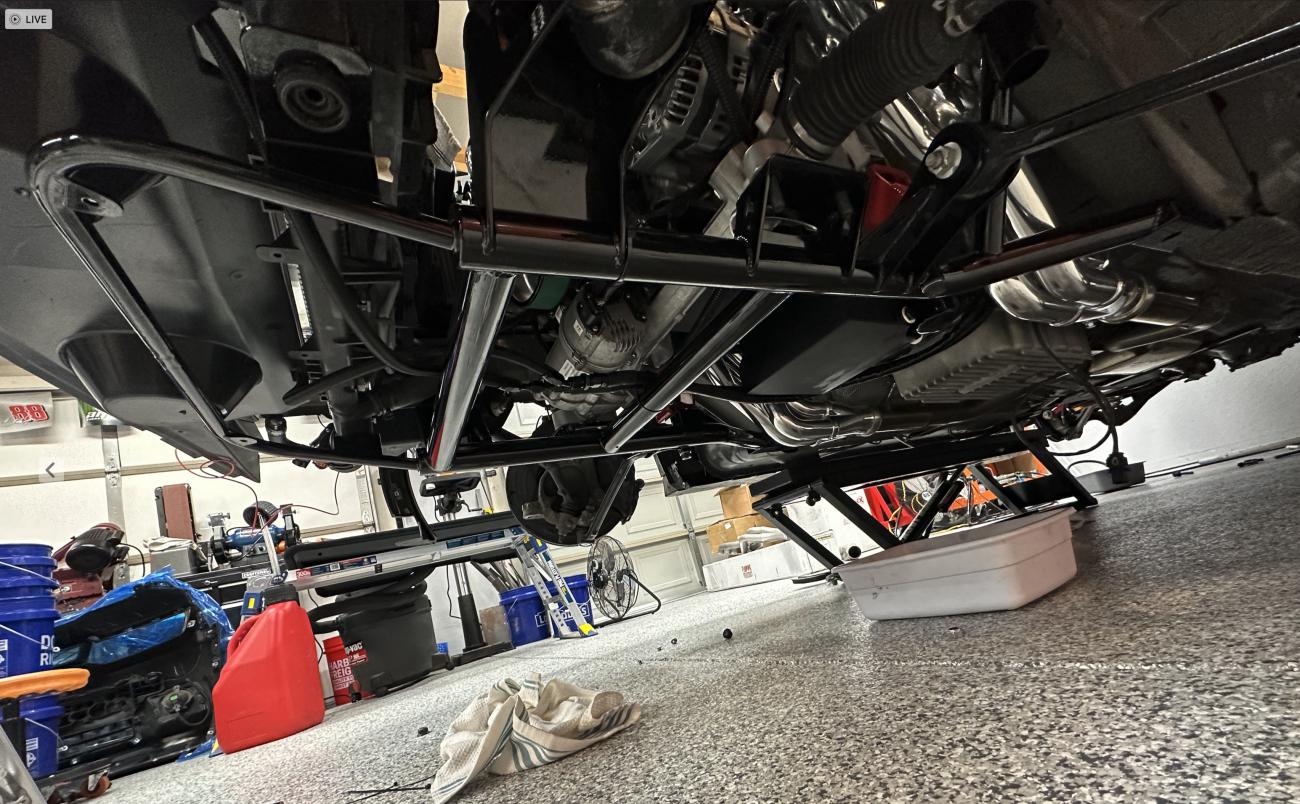

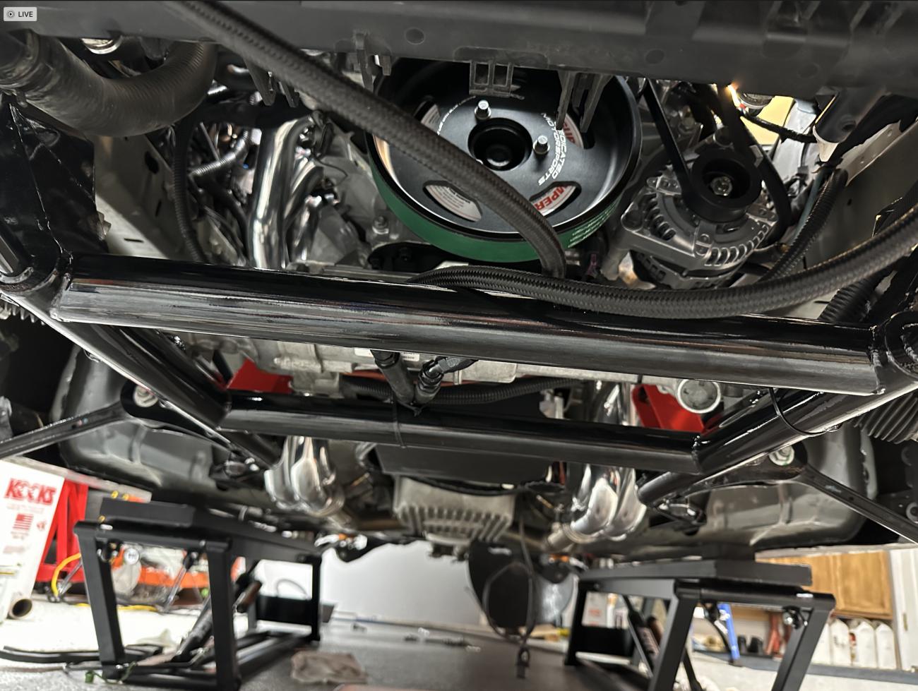

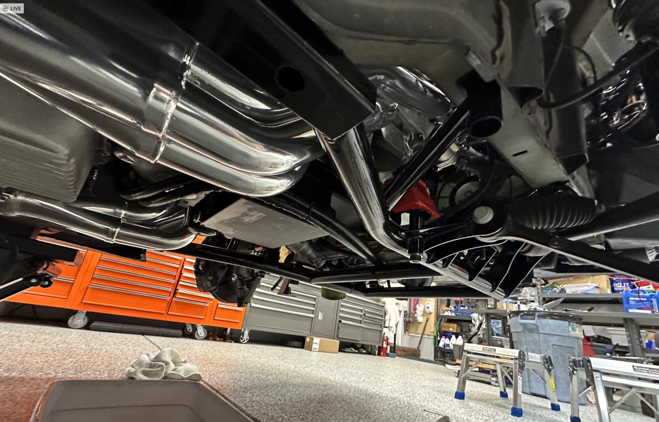

A few more pics of the cradle with pretty much everything installed except the front fascia.
Name:  Screenshot 2023-03-05 at 5.40.58 AM.jpg
Name:  Screenshot 2023-03-05 at 5.41.09 AM.jpg
Name:  Screenshot 2023-03-05 at 5.41.21 AM.jpg
Name:  Screenshot 2023-03-05 at 5.41.38 AM.jpg
Name:  Screenshot 2023-03-05 at 5.41.50 AM.jpg
Name:  Screenshot 2023-03-05 at 5.42.03 AM.jpg
GPI 416 w/GPI S/C Cam, GPI Ported Heads & Tuned by Ben, Holley Dominator ECU, Mag Heartbeat, ZL1 Fuel Pump/DSX Aux Pump, NW 103 TB, FIC 1650's, Alky Meth, Rossler T400 w/t-brake, Circle D Converter, Kooks Headers, Viking Coil Overs & all the BMR Goodies in the rear, Zl1 3.23 Diff, DSS Axles, Wiles Racing Driveshaft, Hendrix Offset Diff Bushings, AFE Solid Subframe Bushings, 875HP/843TQ 5FDP

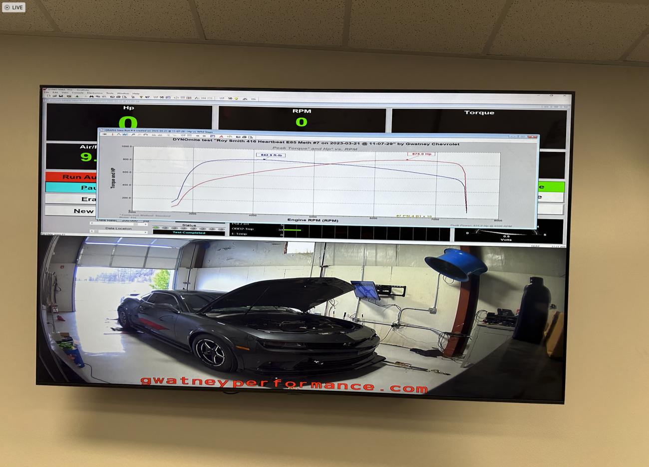

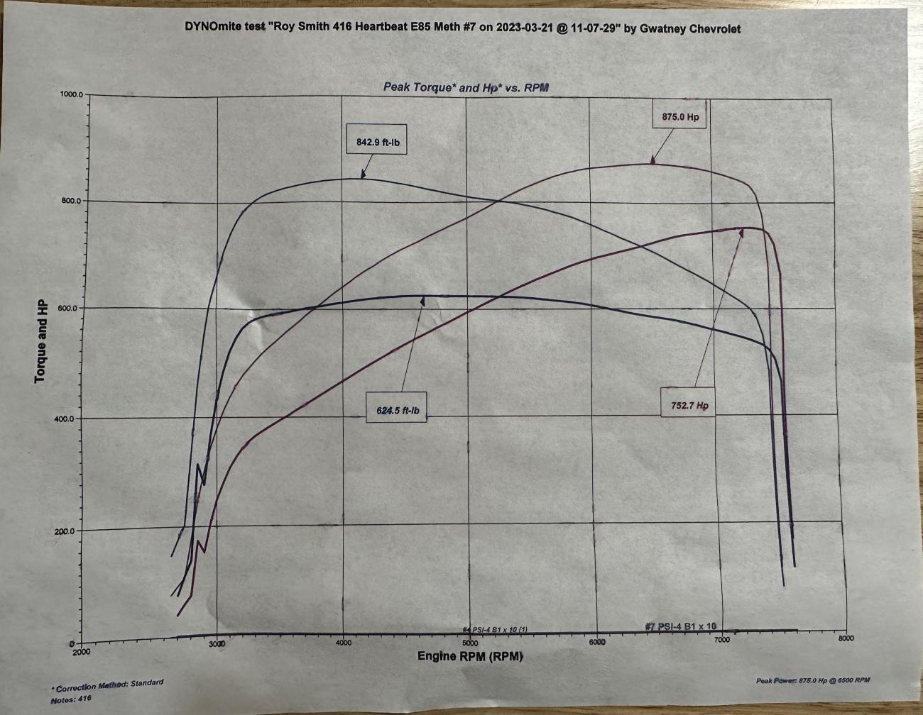

This was my day yesterday
Left the house at 3:30am to drop the car off at GPI and had planned to come back home empty. But when I got to GPI, Kevin said to hang around as he thought they would knock it all out. Sure enough they did and was loaded up and headed back home at 3pm.
This was my view point for the morning -
Name:  Screenshot 2023-03-22 at 7.24.12 AM.jpg
Ben finished the dyno tuning (7 pulls) around 10:45 and the results are - 875hp & 843tq. the graph below is overlayed with the previous results from last years mods. So gained 123hp and 218ft lbs of torque. 16lbs of boost out of the Mag Heartbeat.
Name:  Screenshot 2023-03-22 at 7.21.45 AM.jpg
After lunch Ben knocked out the street tune and finished things up with the tune.

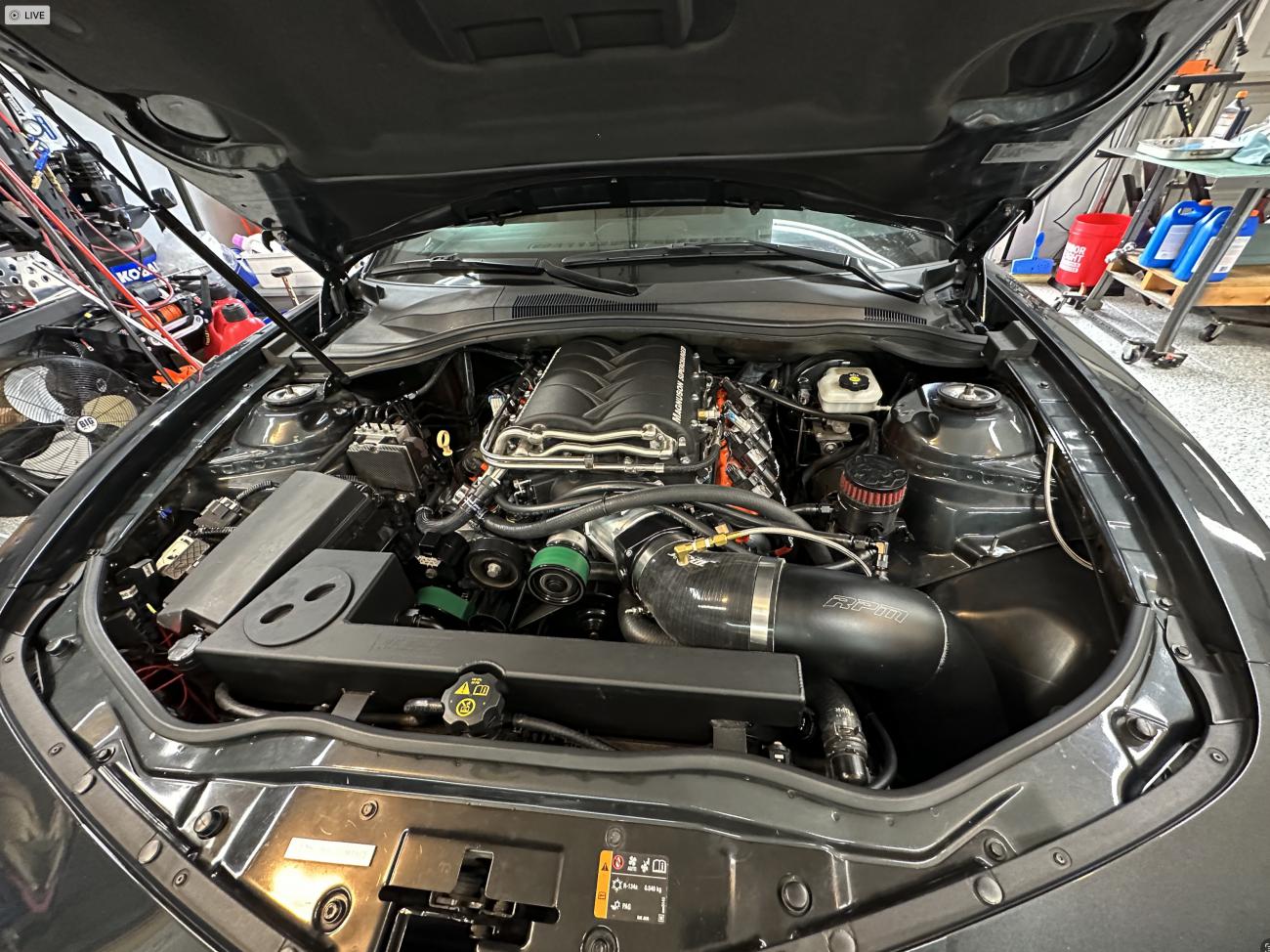

Anyways the combo is now a GPI forged 416 with GPI custom grind cam, 3 belt 10 rib LSA drive w/10" lower and 3.20 upper pulleys and same GPI ported heads I had before. Added the bigger DSX aux pump, FIC 1650 injectors, 2" Kooks headers, BMR (Black Market Racing) intercooler reservoir, Atco heat exchanger and a second Varimax cooling pump.
Name:  Screenshot 2023-03-22 at 7.29.52 AM.jpg
After the last pull -
Name:  Screenshot 2023-03-22 at 7.22.00 AM.jpg
Really enjoy going to GPI as I always learn more while I am there.. Great people & treat you like family. Got to see some cool cars they are working on along with one that has the Skyview rear solid axle conversion that I'm interested in for a future mod.
Now to change the oil and put the 17"s back on for some driving around once the rain stops.. Oh, and it sounds amazing too. I will get a video uploaded sometime soon.
Ashen 6.2 is offline   Reply With Quote
