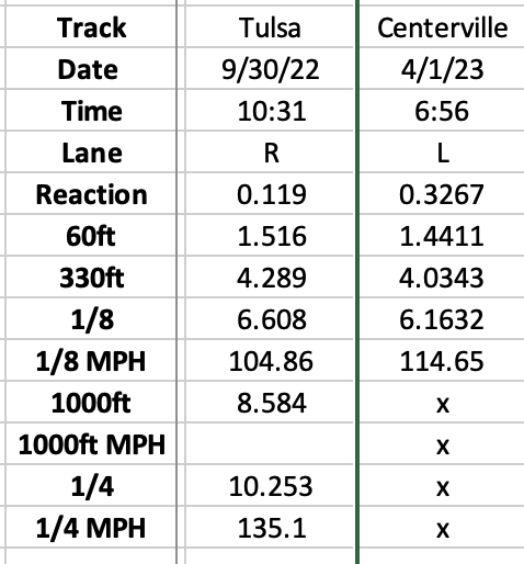

It's much better than I was expecting, especially for the first pass with the new combo and launching in 2nd gear.
Pic attached comparing time slip data from the best pass on SBE combo vs new combo.
With the previous combo, best 1/4 was 10.25 @ 135.1, 1.51 60'. That pass had a 6.60 @ 104.86 in the 1/8th, launching in 1st gear.
New combo launching in 2nd gear picked up:
.07 in the 60'
.25 in 330'
.44 in 1/8th
Also, Centerville has 1000' timing but I was getting out of it after the 1/8th as directed by the track crew. The time slip @1000' shows 7.9818 @ 110.70. Thats .60 faster than previous best 1000' under full power.
All of that to say - it's should be mid 9's.

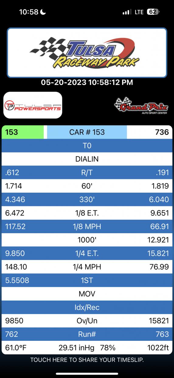

Took the car to Tulsa yesterday afternoon. For some reason I didnt take a single pic.. I was by myself though so that might be it..
Anyways, got 6 passes in and spun on all but one, but the one it didnt I was really expecting it too and soft pedaled it. Best time of the night was 9.85 @148.10
Left lane car 153

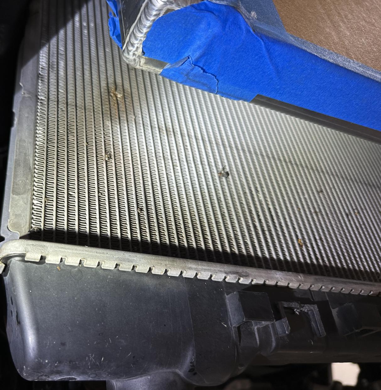

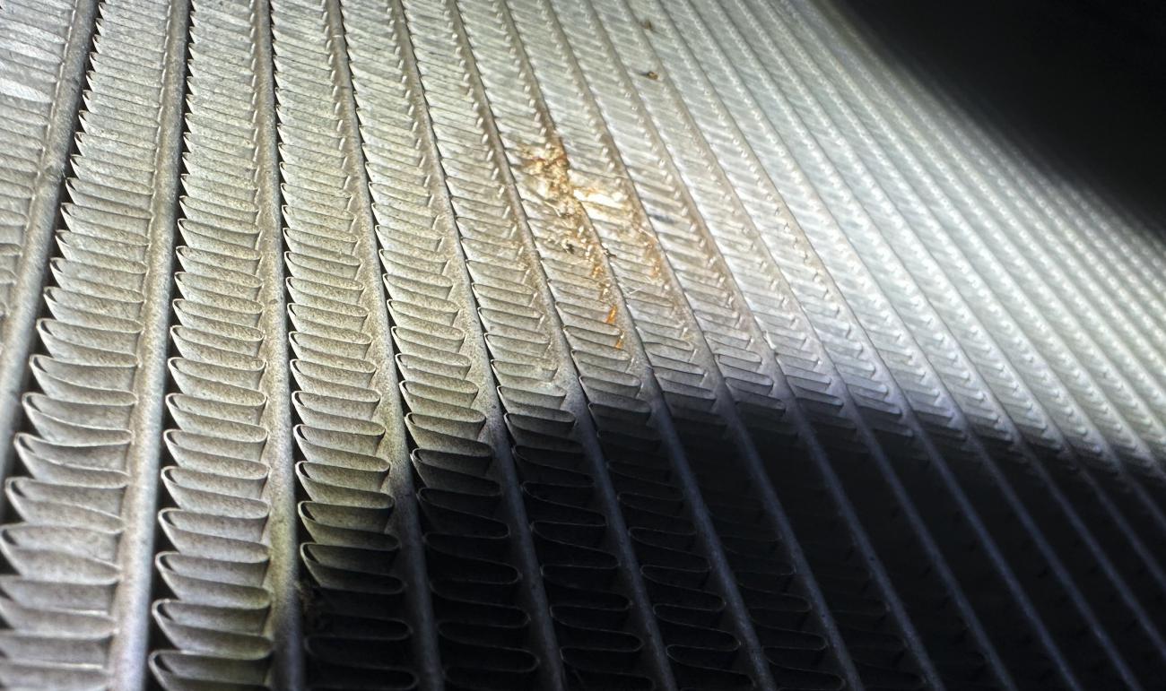

Had planned to go to Centerville Dragwway on Saturday but the weather didnt cooperate and the race was cancelled. So decided to pull the nose off the car to swap out the Atco heat exchanger for a Prospeed heat exchanger since rain was in the forecast for the next 7 days.. After getting it apart and put the Prospeed in place to check fitment, cut new hoses etc., I noticed this spot on the radiator (along with the dead bugs.. lol) -
Name:  Screenshot 2023-06-12 at 5.13.05 AM.jpg
Name:  Screenshot 2023-06-12 at 5.13.19 AM.jpg
Sure enough its leaking -
Name:  Screenshot 2023-06-12 at 5.13.34 AM.jpg
So ordered a new CSF aluminum radiator from Summit since they showed to have one in stock. I had noticed the temp had started creeping up some when driving but never noticed any leaks or smelled coolant.
Will add some pics of that when it arrives.

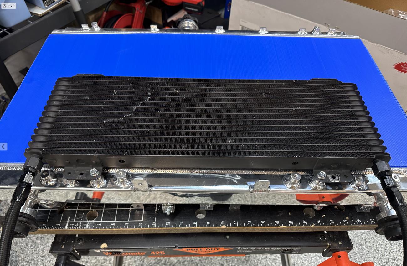

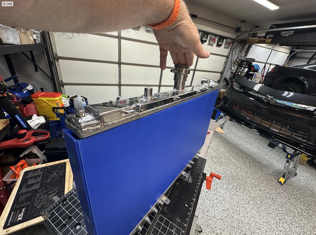

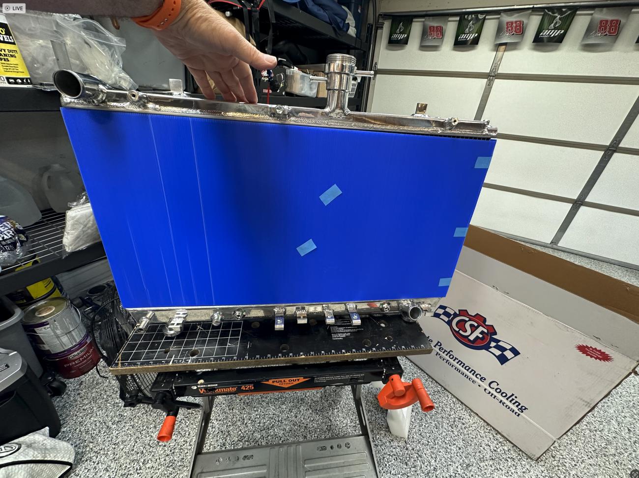

The radiator arrived on Wednesday and here are a few pics out of the box. Leaving the protective cover on the fins till finished fitting it and the new heat exchanger. Factory radiator was right at 12lbs & the CSF is just under 14 so not that much of a difference.
Name:  Screenshot 2023-06-16 at 5.54.47 AM.jpg
Name:  Screenshot 2023-06-16 at 5.55.06 AM.jpg
The Tru-Cool 40K trans cooler bolts right up to the bottom like it was made for it.
Name:  Screenshot 2023-06-16 at 5.55.40 AM.jpg

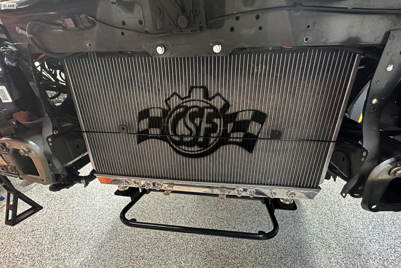

New CSF radiator is in and fits perfect.
Name:  Screenshot 2023-06-24 at 5.09.35 AM.jpg

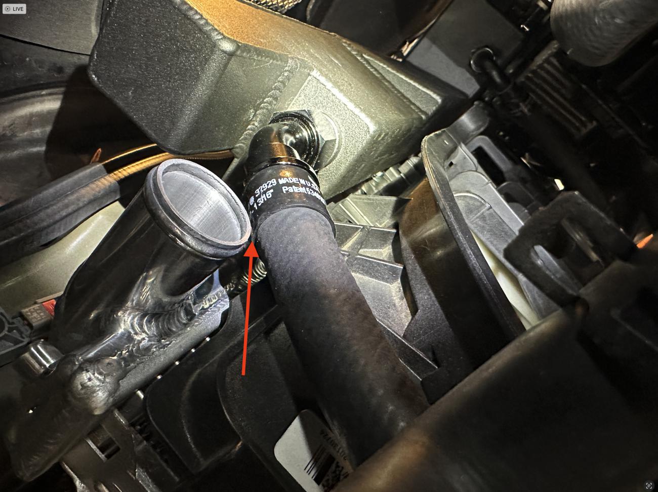

The only thing I ran into was the 12an fitting from the S/C coolant tank was in the way of the radiator hose. I could have probably made it work but wanted to get some clearance there.
The an fitting needed to be either shorter or swap from a 45 degree to a 60 degree fitting.
Name:  Screenshot 2023-06-24 at 5.00.59 AM.jpg
Name:  Screenshot 2023-06-24 at 5.00.38 AM.jpg
So I actually found a 60 degree fitting that was shorter and got that put on. Plenty of room now.

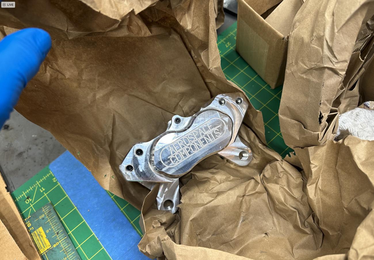

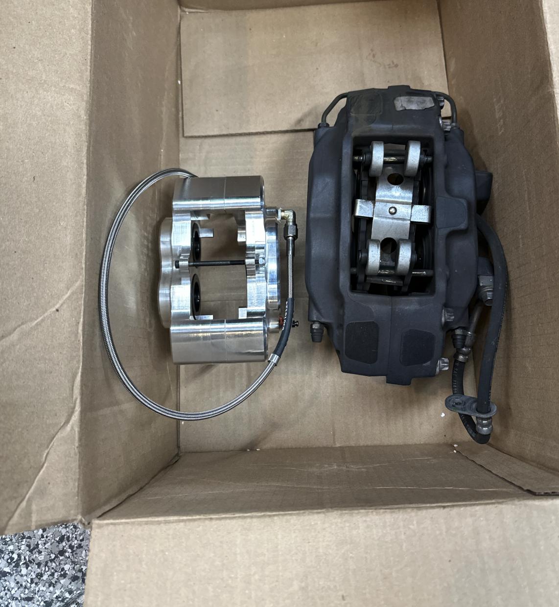

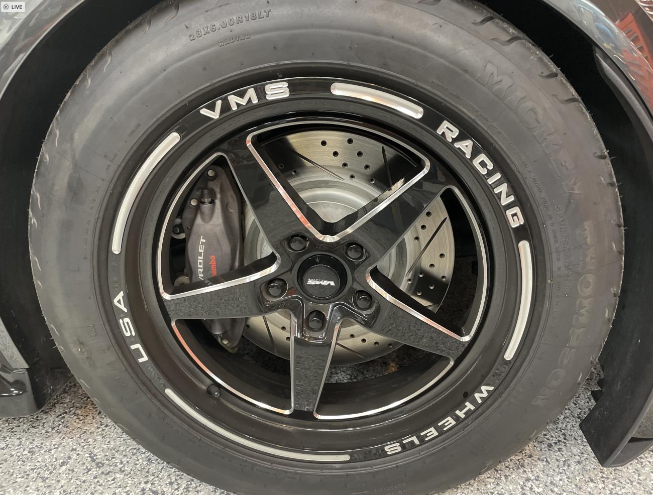

Next up is assembling the Aerospace Pro Street brake kit from GPI. These brakes are ~40lbs lighter than the stock brakes. And look Killer!
Name:  Screenshot 2023-06-24 at 5.01.19 AM.jpg
Name:  Screenshot 2023-06-24 at 5.01.37 AM.jpg
Caliper size comparison -
Name:  Screenshot 2023-06-24 at 5.01.46 AM.jpg

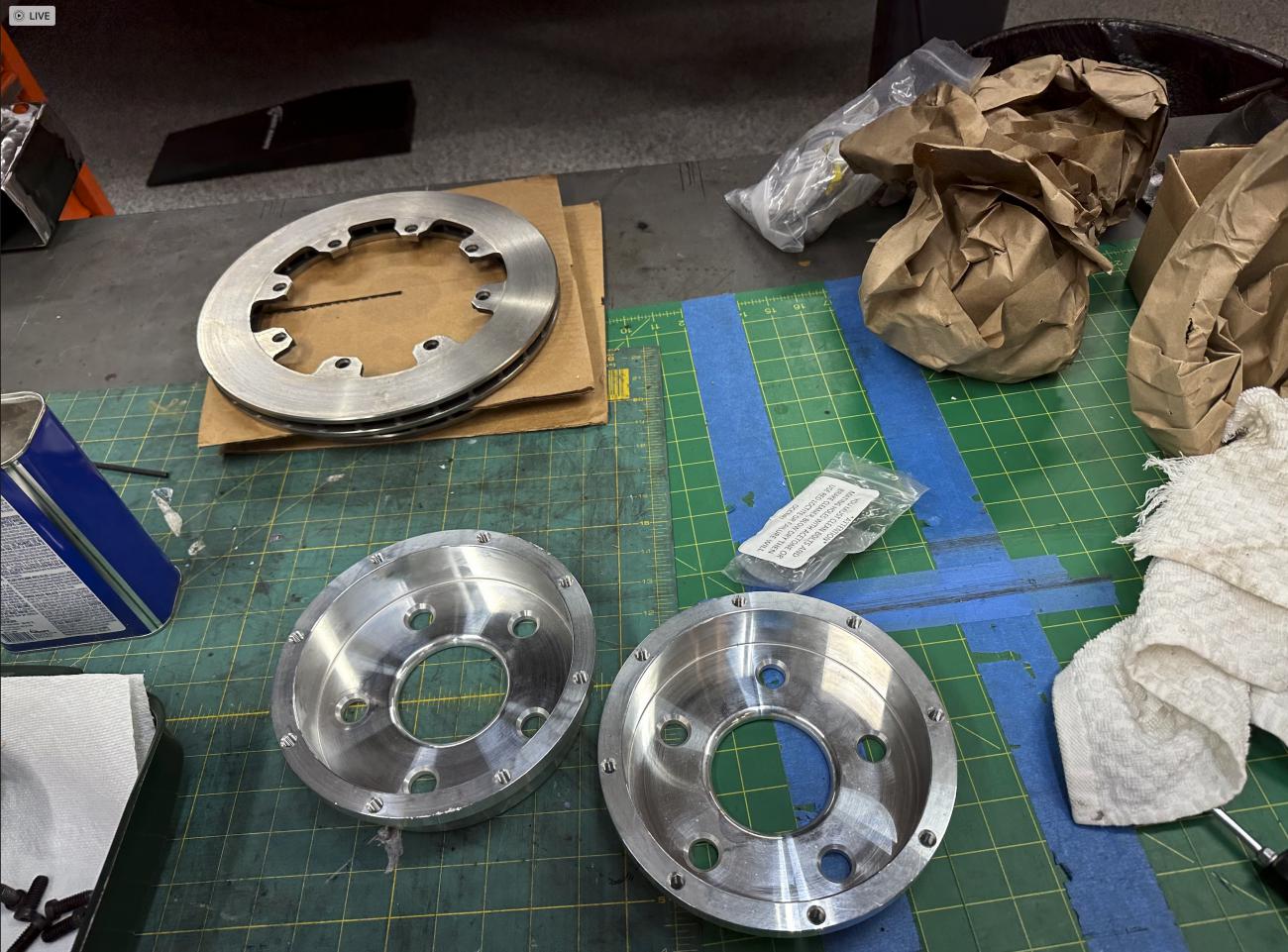

Cleaning the bolts and hats/rotor assembly with acetone prior to assembling with red loctite.
Name:  Screenshot 2023-06-24 at 5.36.11 AM.jpg

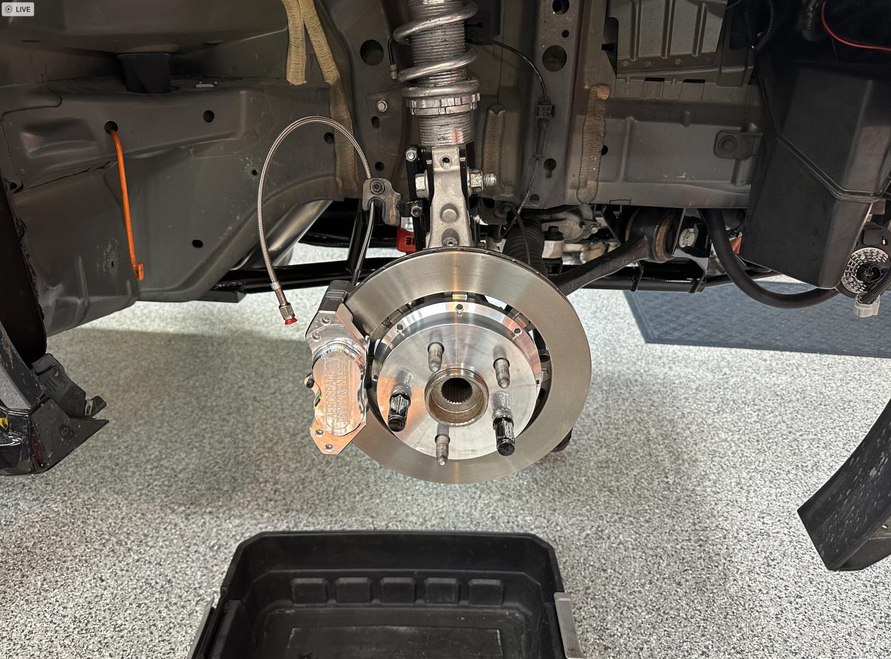

Test fitting checking clearances
Name:  Screenshot 2023-06-24 at 5.02.08 AM.jpg

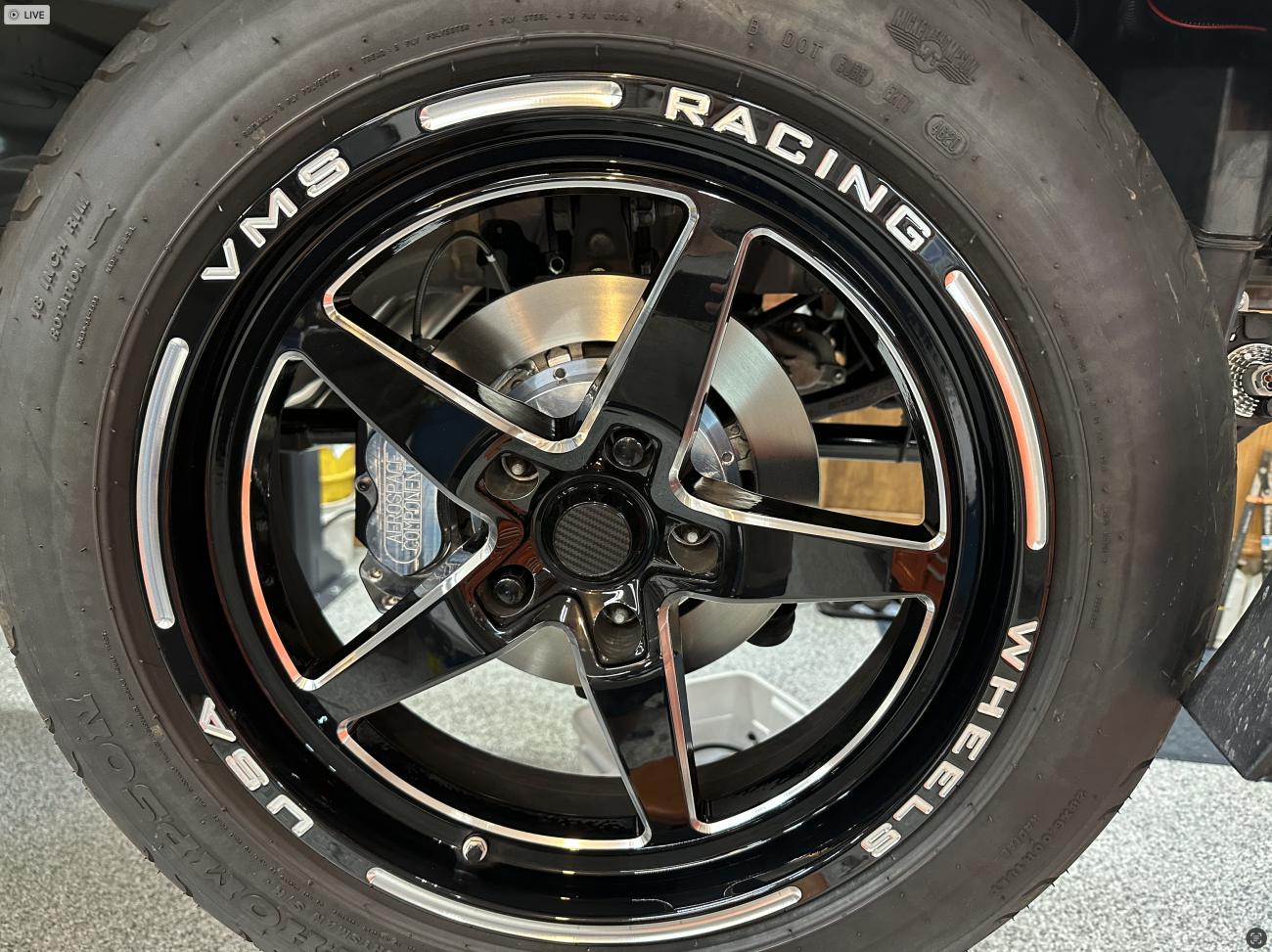

With wheel on
Name:  Screenshot 2023-06-24 at 5.02.44 AM.jpg
Comparison with factory brakes
Name:  Screenshot 2023-06-24 at 5.06.57 AM.jpg
