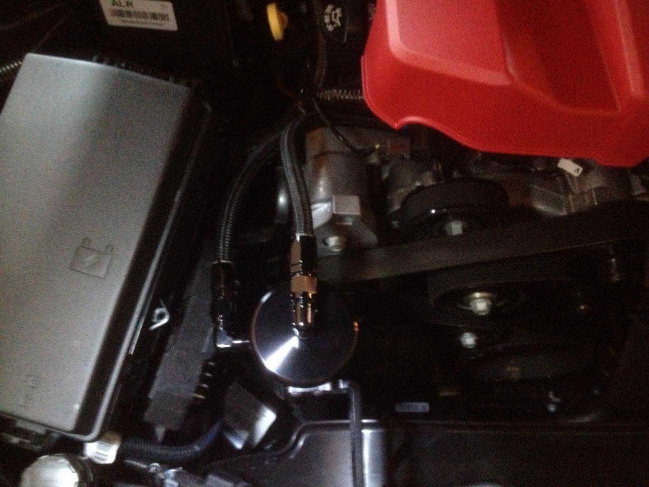

After about 200 miles.

Lower screws were to long in mine also. I installed using the upper only and will stop at Fastenal Monday to get two shorter ones. I also sprayed them simi gloss black so the silver won't slap you in the face looking at it.
I also installed with the return off the side rater then the front side as the instructions say. Looks and functions better IMO.
