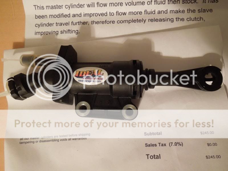

Well after watching Balue's issues and keeping me dealer up to speed on what's happening, im planning on taking her in next week and see what happens. Does anyone know where i can get the clutch slave bearing? I thought monster Clutches but cant find it.I am also getting (thanks Doug)the Ideal garage master clutch cylinder. I dont want to go thru this again, i cant even take 2 gears under acceleration without my clutch pedal going away. I wish customer support would be involved in this discussion, especially with the document (post 211) that GM is saying this is a "Launch control" issue..........uhhh hello, "launch control-Road racing" i dont think so. I have contacted William VIA PM, but dont really feel GM much cares about this issue. The fact we have to buy ANYTHING!!!! for an advertised "TRACK READY" car is just bad business/customer support in my opinion.

I don't think monster clutches has had a chance to get the bearings onto their website yet. But if you send Steve@SNL a private message I'm sure he willget you taken care of.
