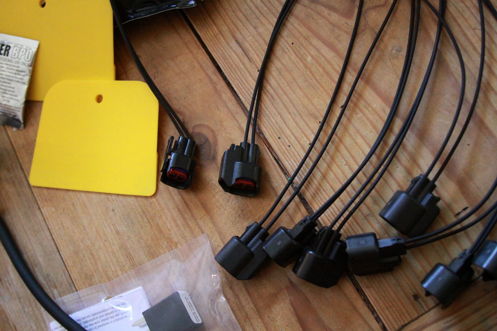

Got some stuff to do the inner fenders. I going to give them a skim coat to remove all the spot welds and ripples. I'm not going to start to till I mail the intake for powder coating. I want to enjoy driving the car while I can. I should have a week of down time to get all the work done.
Got some harness extension from http://www.casperselectronics.com/store2/ These will allow me to reroute the throttle body and map harnesses. Once I do this, I wont have any wires running up the front of the engine.
The extension are wrapped in a similar material I used for the spark plug wires.
Got the connectors so that I can complete injector harness 2.0. You could see I already gave a hair cut to one. These are a lot nicer than the factory units. For folks who would want to get rid of the factory Circus colors connectors, you could buy them without the pig tail wires and just replace your exiting ones with these.
Nothing to do with cleaning your engine bay but the solenoid in the plastic bag is pretty cool. It prevents the trunk from popping open by accidentally hitting the bottom when you have your keys in your pocket. In order to open the trunk, you have to press it twice.
