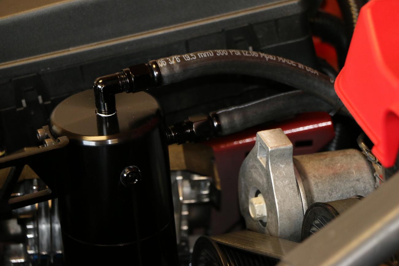

Originally Posted by Shrek View Post
After about 200 miles.
Originally Posted by hotlapZL1 View Post
Lower screws were to long in mine also. I installed using the upper only and will stop at Fastenal Monday to get two shorter ones. I also sprayed them simi gloss black so the silver won't slap you in the face looking at it.
I also installed with the return off the side rater then the front side as the instructions say. Looks and functions better IMO.
Looks great!

Mine came with the long screws also. The correct length for the bottom two screws is 10mm. I bought some black oxide socket head cap screws. The black screws look much better. I also used a straight fitting coming off of the center port for the outlet.

I saw someone else recommend Ninja Black Thread Tape for a clean, no white, install. I did that with great result
That is perfect. No need to trim back white tape.

Is it necessary to install the little clamps around the braided hoses at the end point where they connect to the "nipples". Seems like the hoses fit pretty snug
No. The clamps are mostly just a warm and fuzzy thing. People would panic if they were not included.

I install my catch can today. My question. Nobody have fear, then the catch can, falls possibly down. For me, looks this very dangerous. You guys take also loctite for the radiator bolt or not?
I think, i need to make my hoses shorter. My looks longer, then all this pictures.
And you guys have installed the clamps on the in and outlet "nipples" on the engine side or not

I did also wonder about to go over the flanges on the engine,seems as though hose I.D. too small to make it go over them.Also my can has only 2 bolts holding it onto bracket,Production change?
