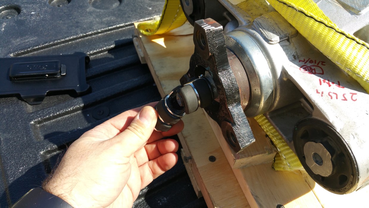

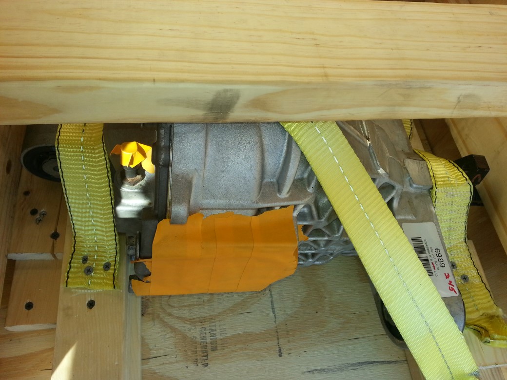

Well, UPS -- just sucks -- no other way to put it
I got the differential today from them, and they must have dropped the crate -- even with ALL the warnings on it
They lost the gear oil and drive shaft bolts, crate was broken, the differential was not strapped down right -- I have the pictures.
They sent me a note saying 'left at facility' and delayed the delivery -- no way I was going to accept that so call CS and after 2 hours, still no confirmation. I did get from them 'where' it was and I just rented a truck and got it myself...
Looks like they were doing a CYA move -- really sucks.
So, I have it, does not look like its in bad shape (a few scratches) so I'm going to put it in and get the bolts and oil tomorrow (thanks to Aaron @ GPI for getting the for me so fast).
I'll post pics of way I got it from UPS...

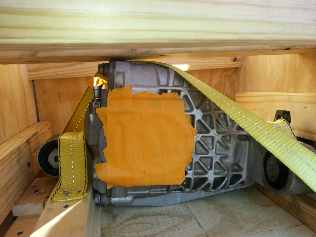

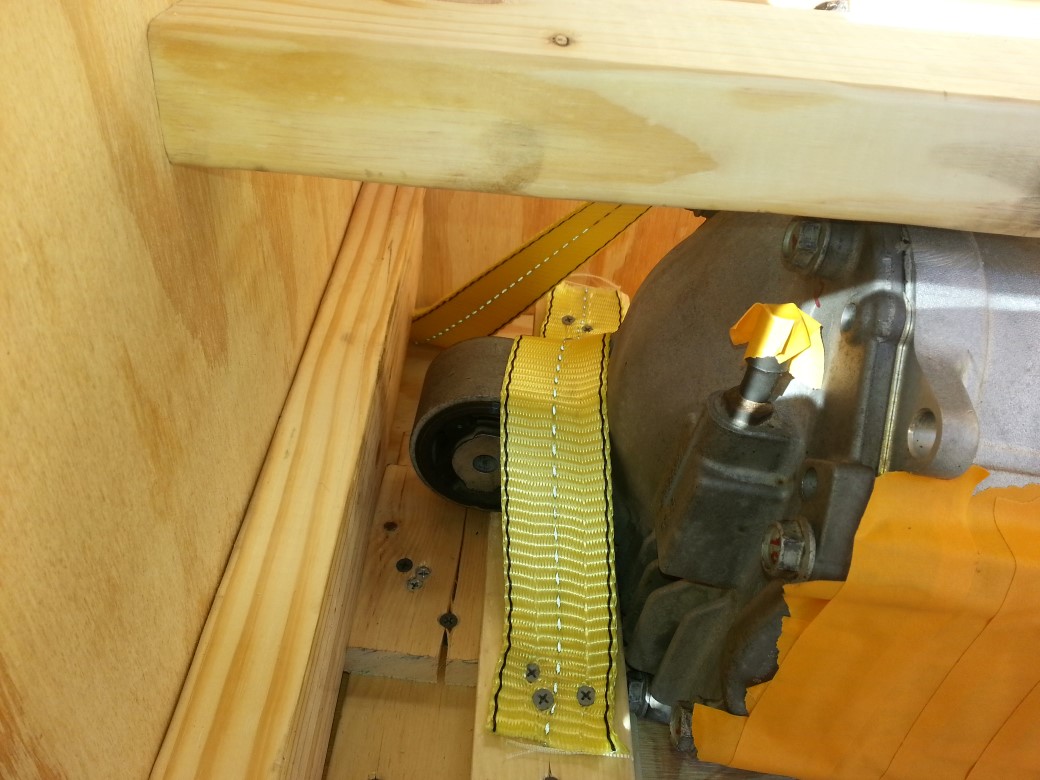

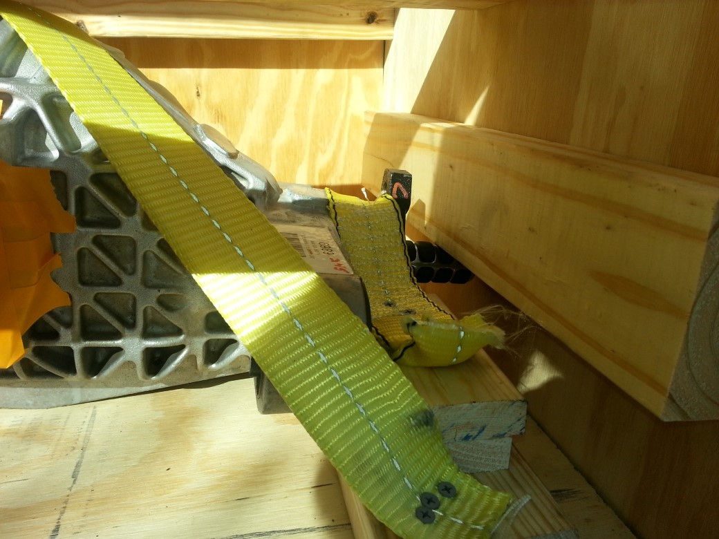

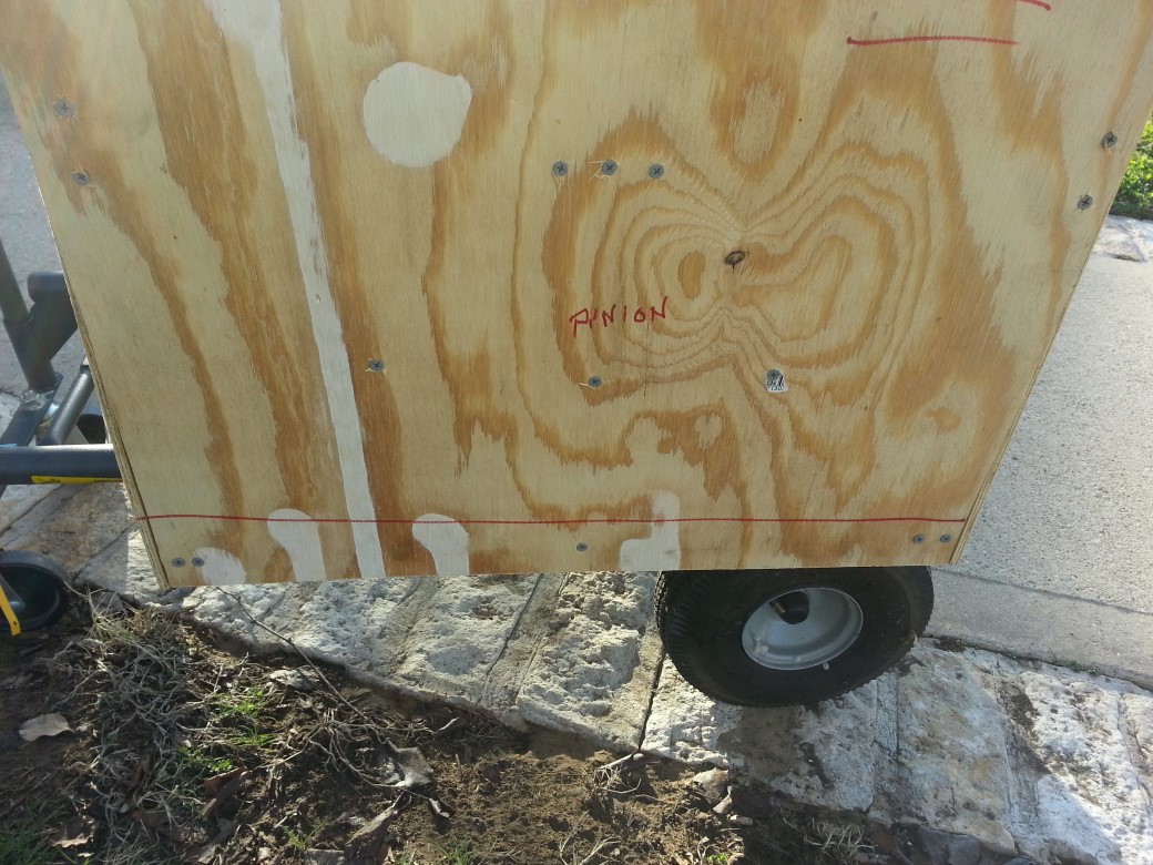

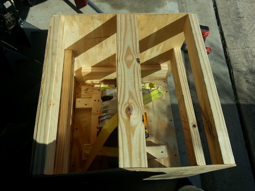

How I crated it:
Got to GPI great with no issues and GPI packed it the same way
I even put handles on it -- those were still on the box too...
But UPS then gave it back to me like this:
Humm....
-Don

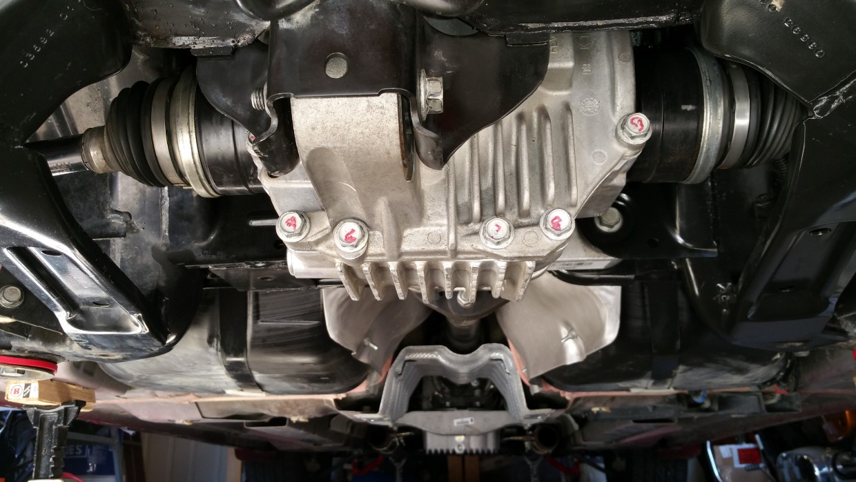

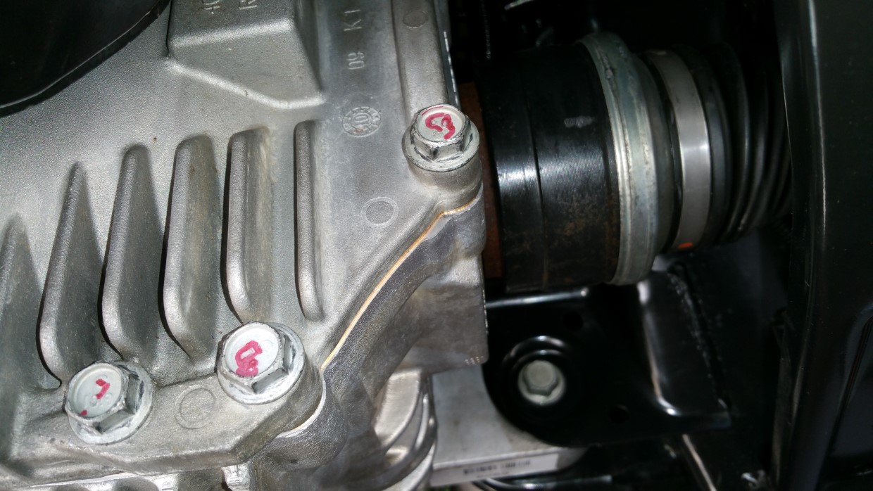

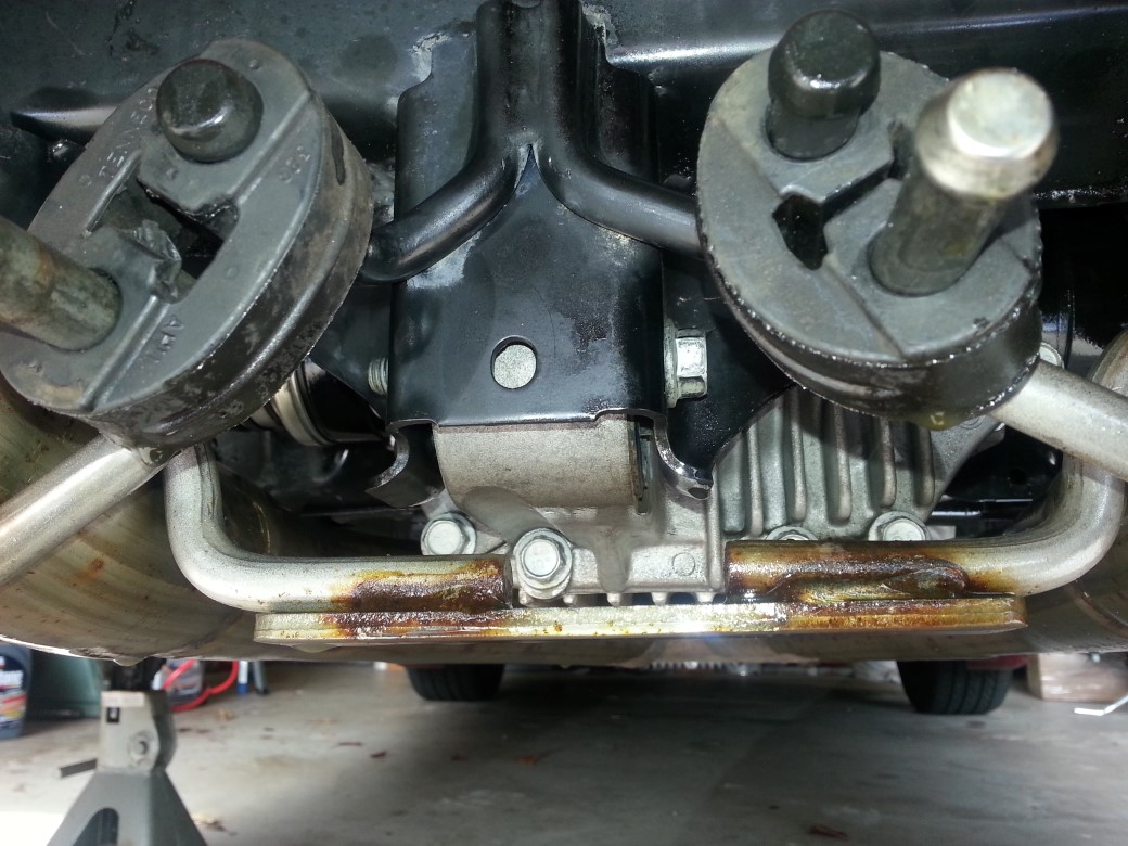

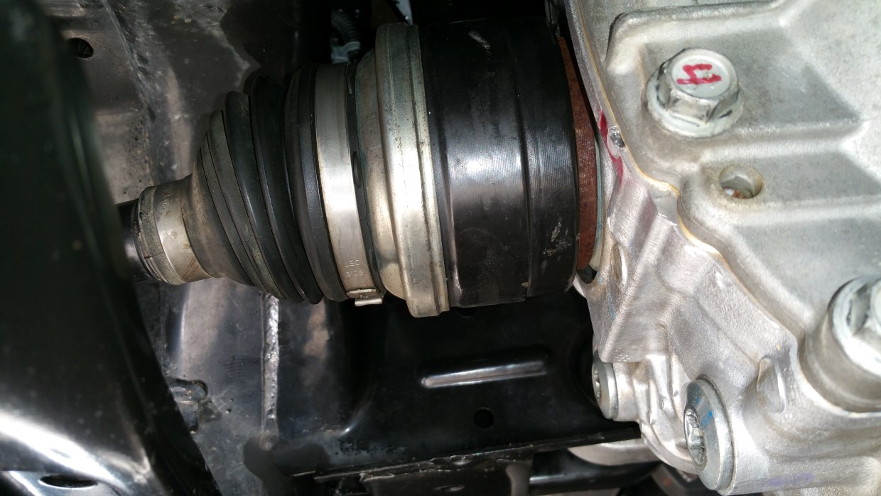

Differential is back in! Went in much faster than taking out.
I used 2 jacks (one for the differential, one for the drive shaft) and slowly jacked them up together. I was able to put the passenger's axle in first (I tilted the differential down and to the drivers side). Once that was in slowly jacked both jacks up until I could get the drivers axle started -- then jacked both jacks again -- keeping the pinion yoke aligned with the drive shaft and put the differential bolts in (torqued to 59 ft lbs).

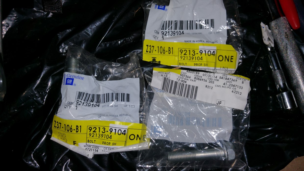

Here are the drive shaft bolts (MUST replace each time -- no questions about it) These get torqued to 85 ft lbs:
Gear Oil:
Everything lined up perfect!:
BTW, don't forget the differential Vent tube ;o) !

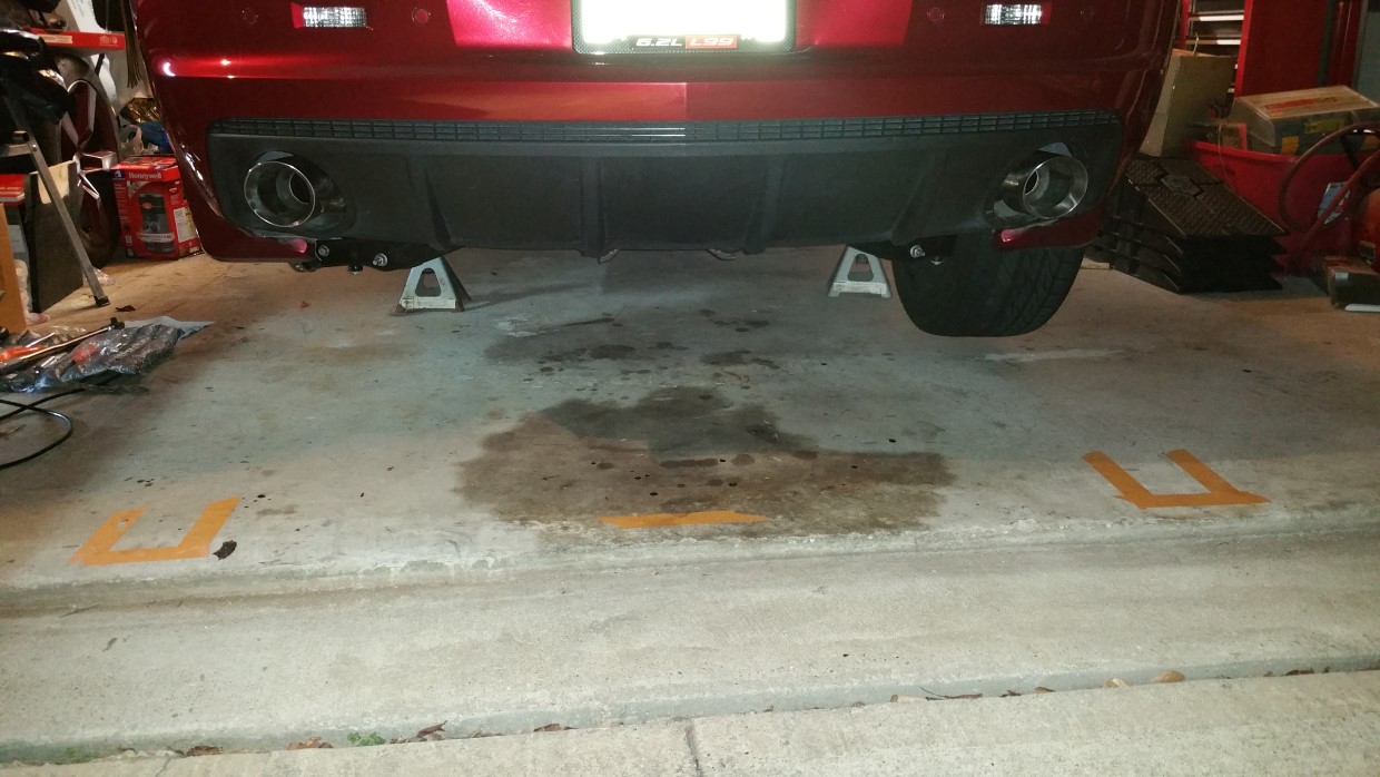

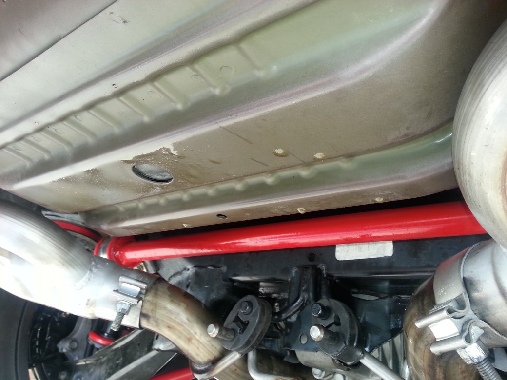

BTW this is the gear oil all over the Camaros 'Kardashian' booty from the pinion seal leak:
Turned out the 'spring' that surrounds the pinion seal popped out and that cause the loss of fluid -- now all new seals, bearings, clutches, Posi-Mod -- just great job by Aaron @ GPI. Can't wait to try it out...

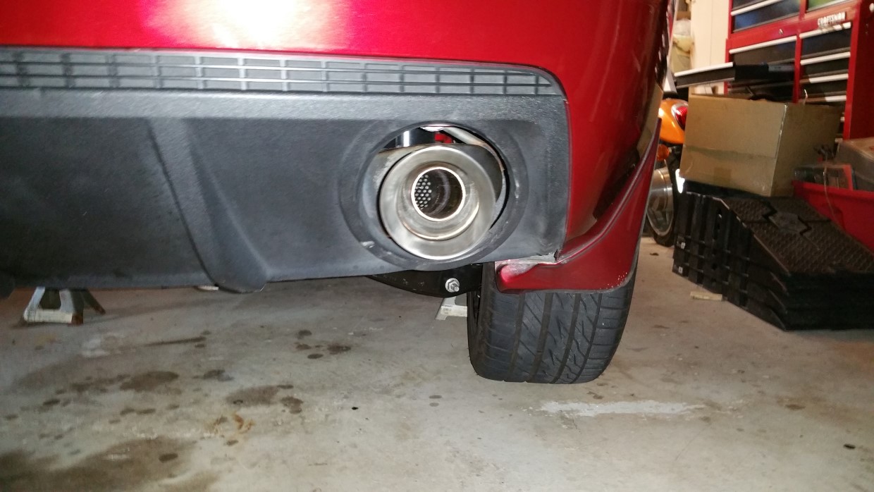

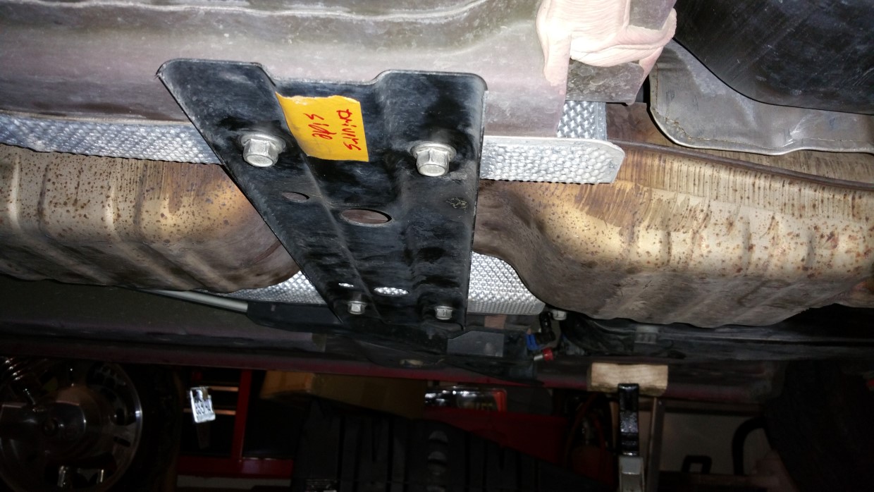

Differential is quiet as a mouse -- did about 40 figure 8's in Lowes empty parking lot to break it in. Did some low speed drives and took it out on the highway -- not a peep!

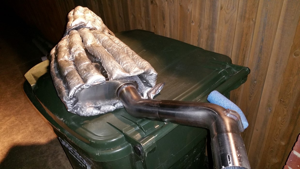

The new exhaust is awesome! Tyler (JDP) hooked me up! I heard the wine of the Supercharger for the first time doing WOT! That is an AWESOME sound ;o)

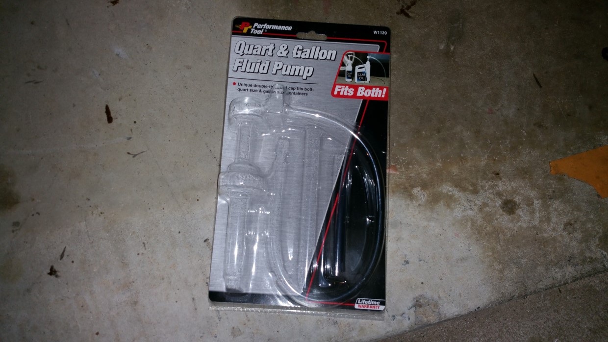

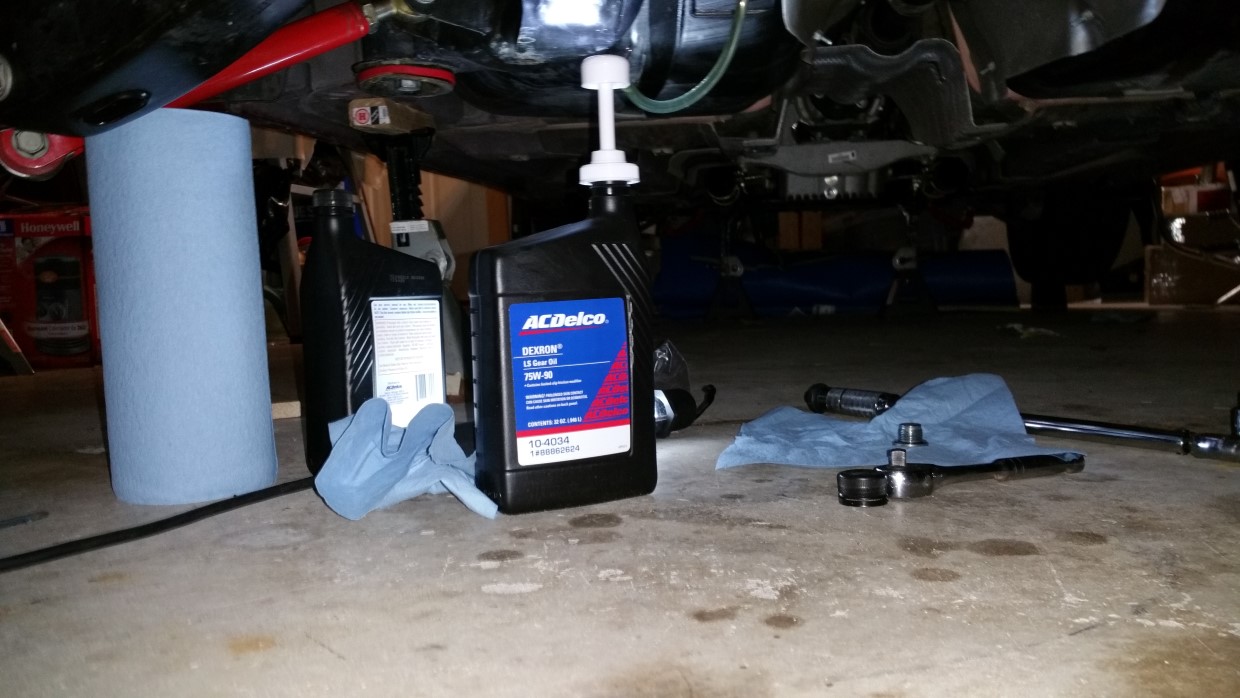

Here is some of the pics of the what I used for filling the gear lube:
Torque the filler plugs to 24 ft lbs (both of them)...
The pump made it a no brainer (doing it with the exhaust off does make it easier)...

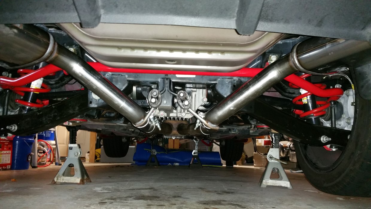

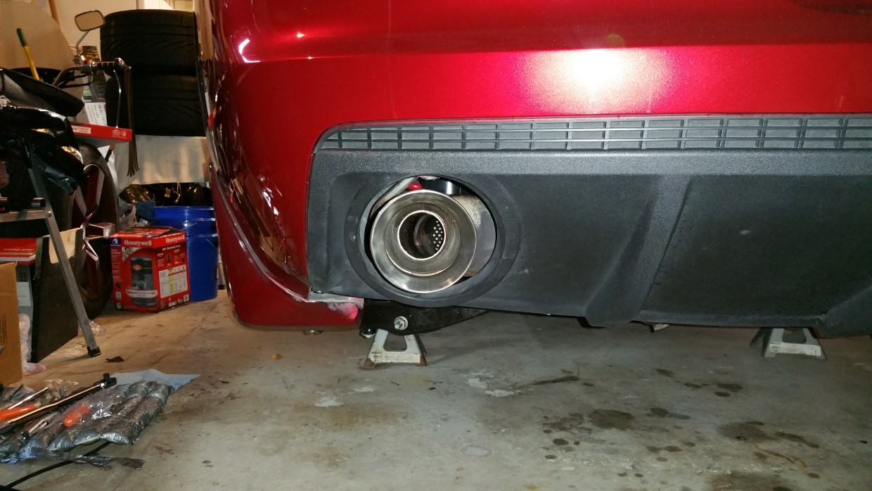

And now the exhaust and installation:
I had to re-adjust this after install as it had a slight NVH. So moved it back and raised it up a bit and all gone!
The mess on the floor is the gear lube that dripped from the car after I got back (stained, gonna need some concrete bleach now ;o):

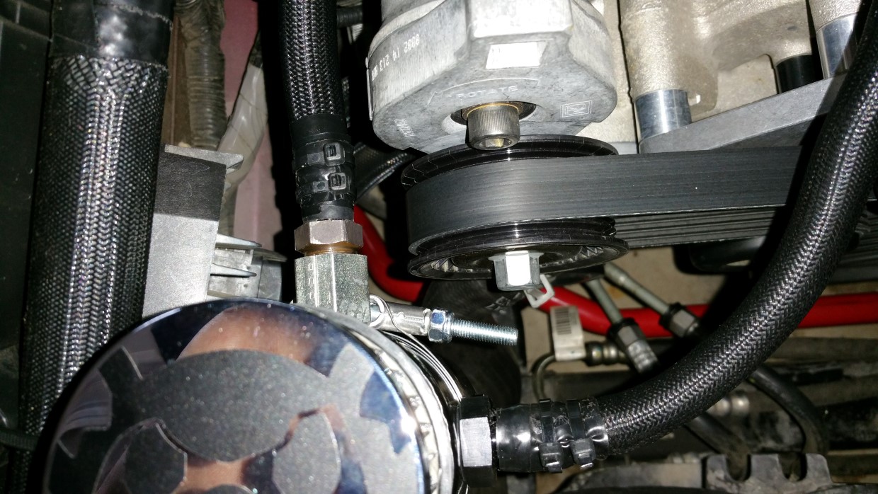

OK, MightMouse Catch Can is on (before it started raining hard here ;o)
Pretty straight forward install -- got the Gen5 bracket to install it:
Hoses have plenty of clearance and not near any pulleys -- test drove -- no vacuum leaks and NO HISSING as I used 3/8" fuel injector line to fix that part...
More to come...
