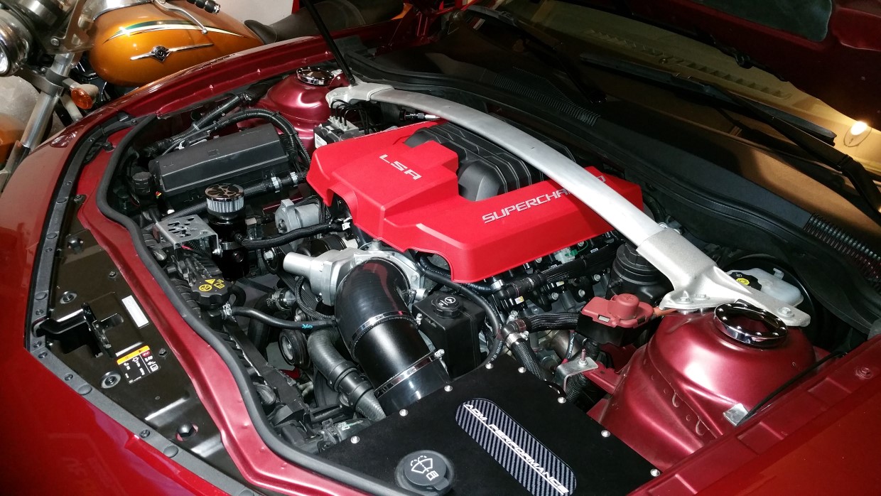

Got the 'SC' cover cleaned up to fit the breather now!:

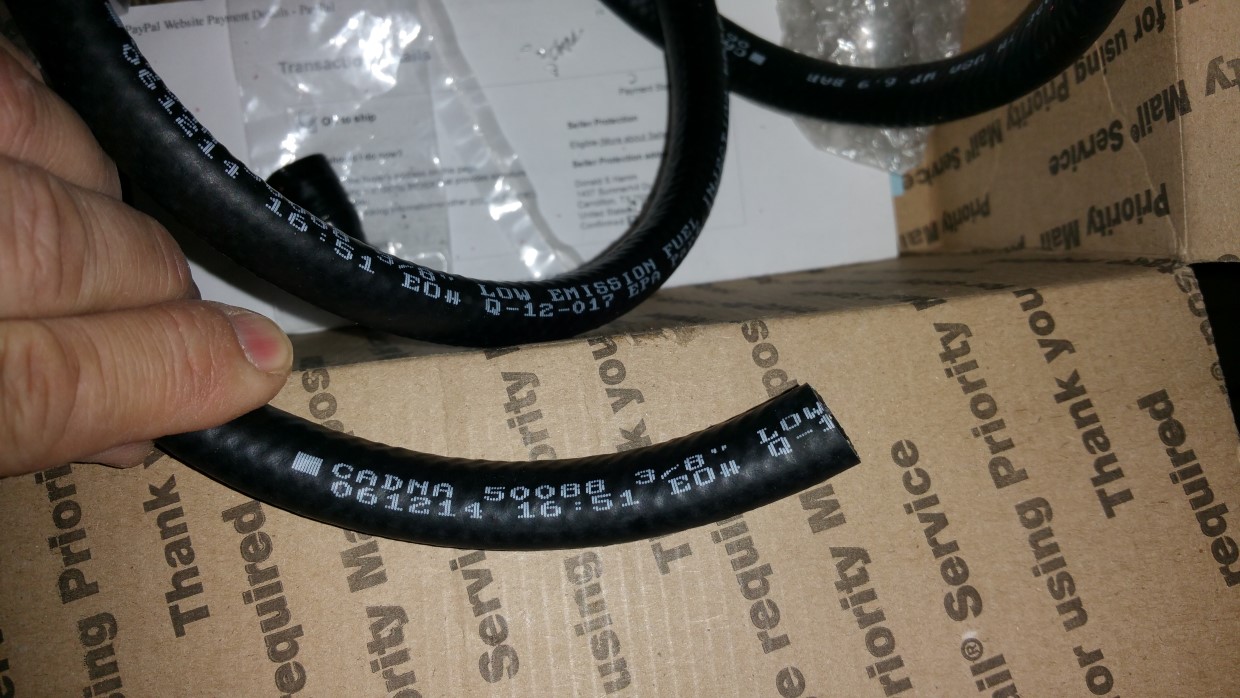

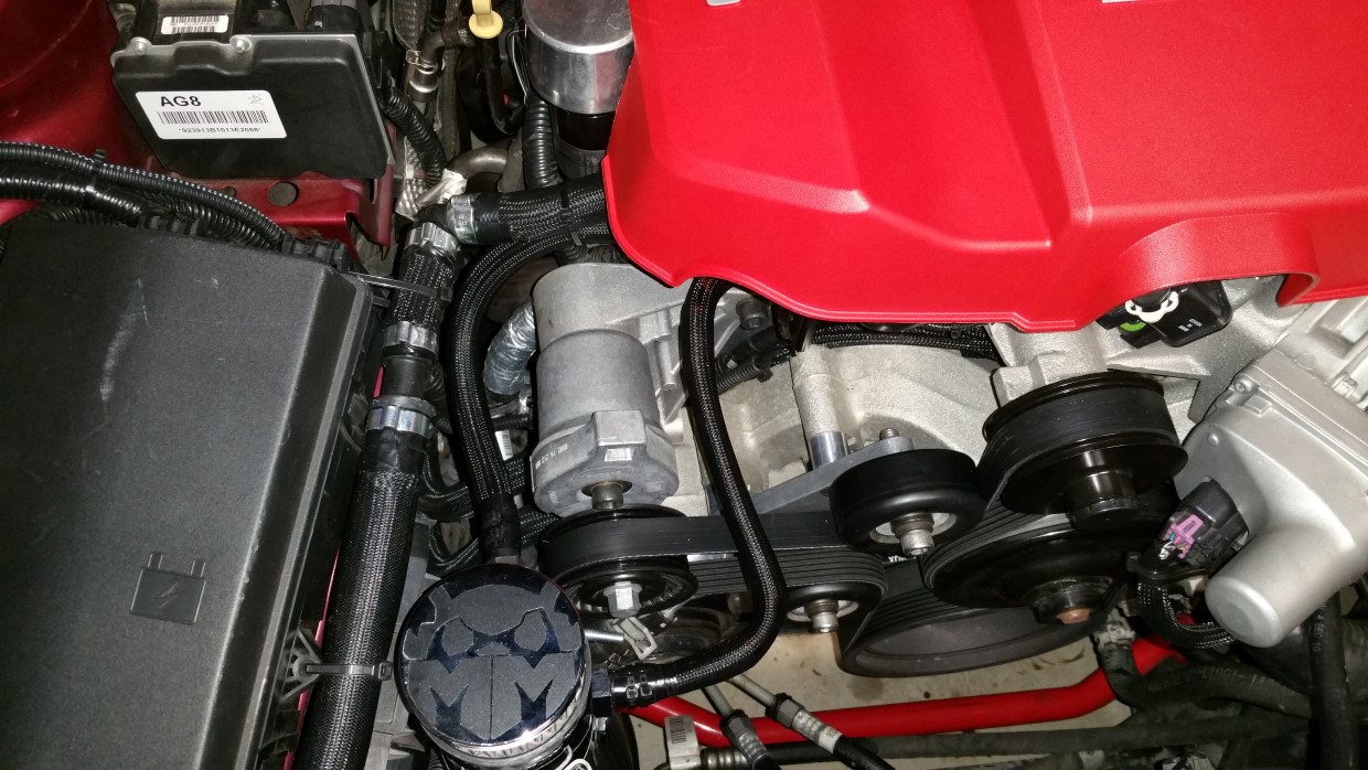

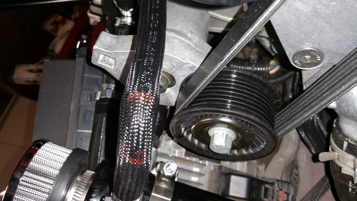

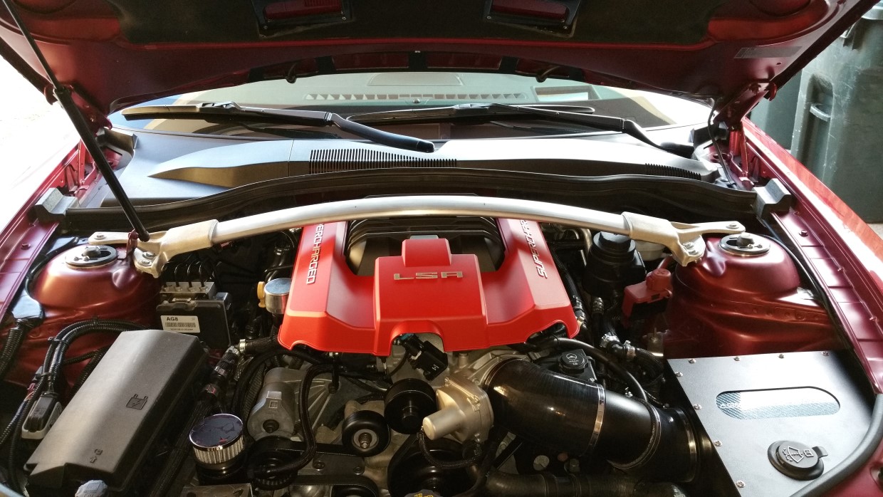

I wanted to route the lines for the catch can differently so I used the 3/8 fuel injection hose, the 'ends' from an L99 'passenger side' clean PCV line, the '90*' bends from that and created my own custom hose. I also used this to give it that 'special' look (from Masters Carr):
Really makes it stand out.
The PCV line was one I had plus I bought another one to get the 'straight' end. If you don't have one, then get two of these:
Now, nice and clean look (I used high heat RTV to 'hold' the curves together):
Fuel Injection Hose (3/8"):
Routing:
Much nicer I think and looks like more expensive hoses too...
-Don
747 RWHP 794 RWTQ

Just so you know, yes there is clearance for the hose/belt:
-Don

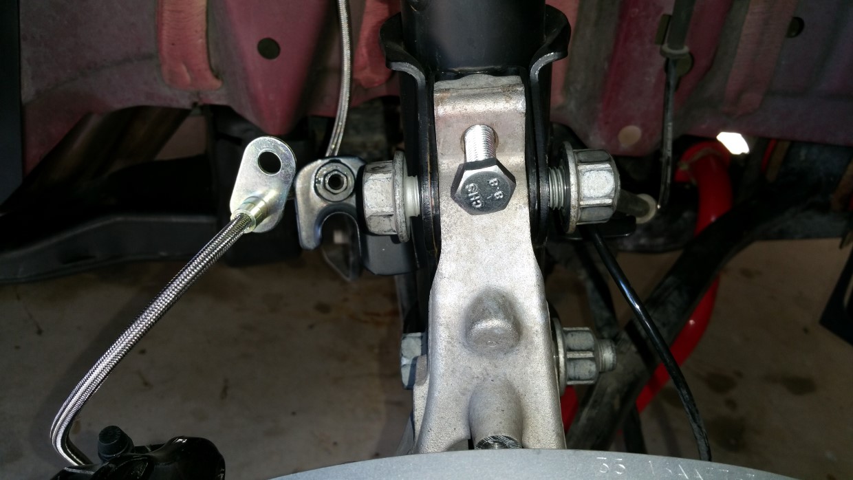

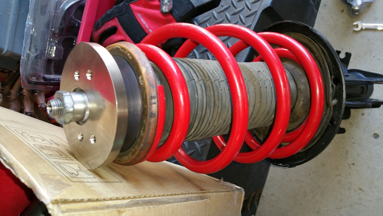

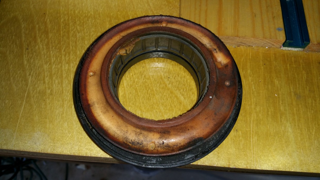

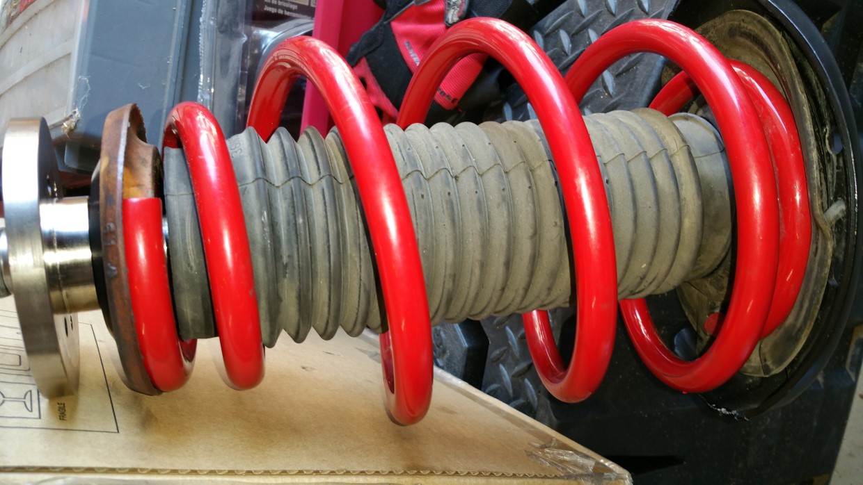

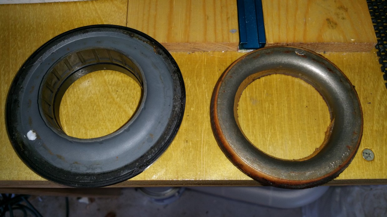

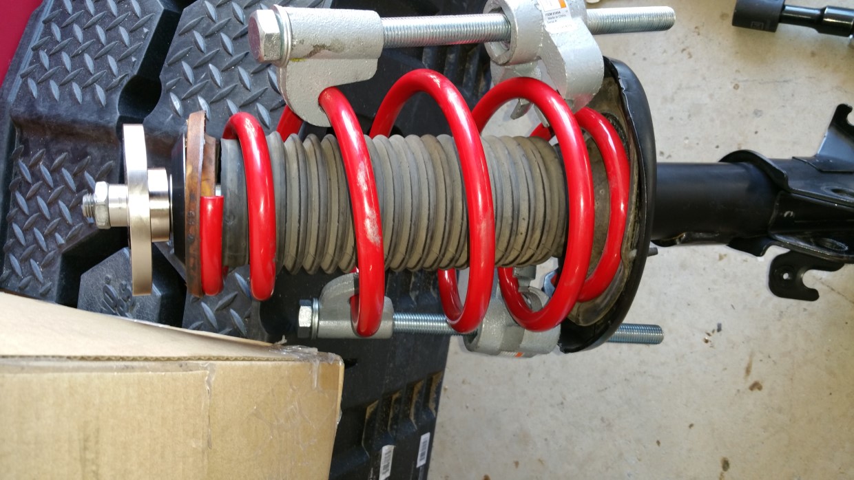

OK, Moreno's are on!
Just so everyone knows, I have a late model 11 and after a call to Justin, we both realized I needed to follow the '12' instructions as the late model 11's were upgraded.

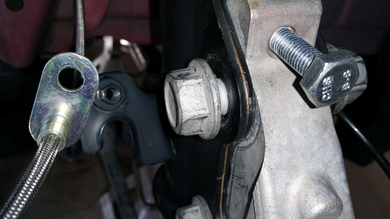

So, taking off the struts are no problem (I've done it a few times on this one), but before you do that, take advantage of 2 things:
1) Mark the strut to the Knuckle with a marker and
2) Using the metric bolt, screw it in to 'mark' your current setting. This will make it MUCH easier to re-install and get it right:

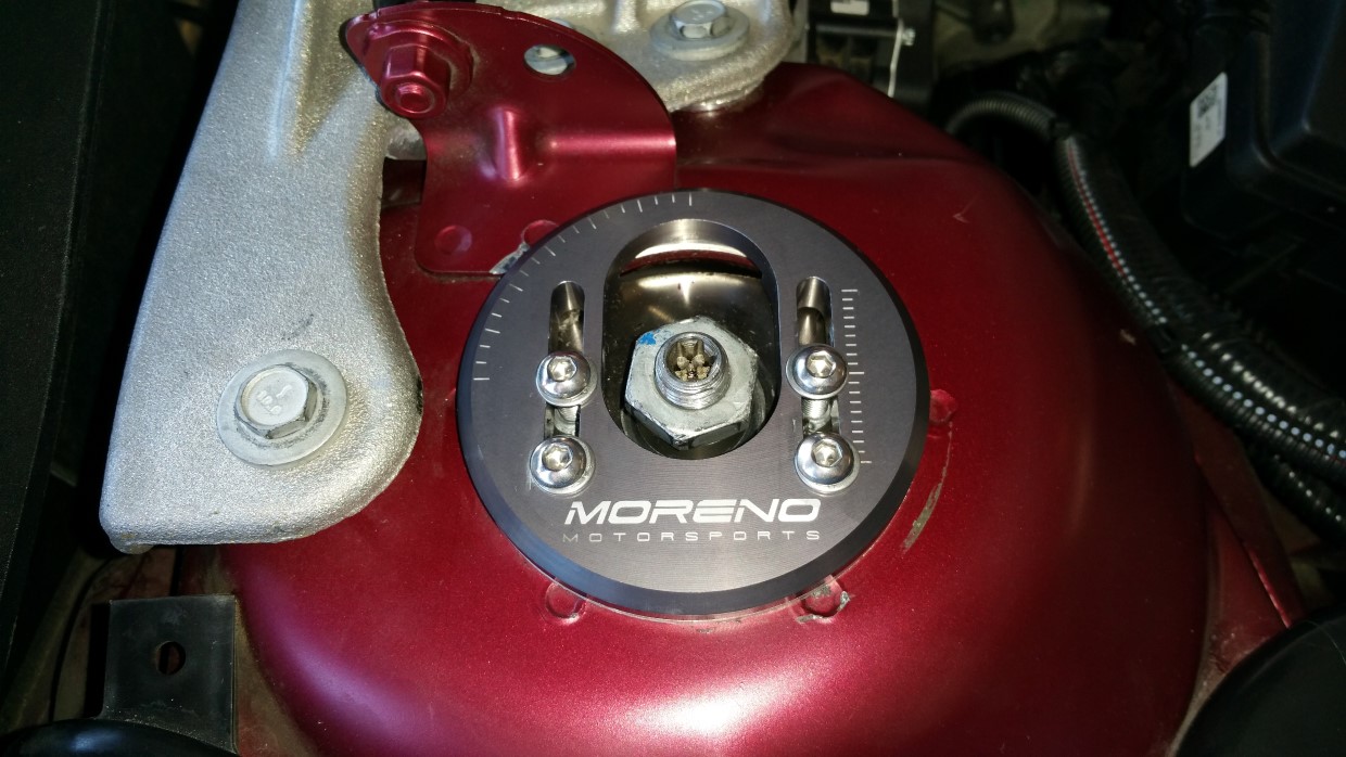

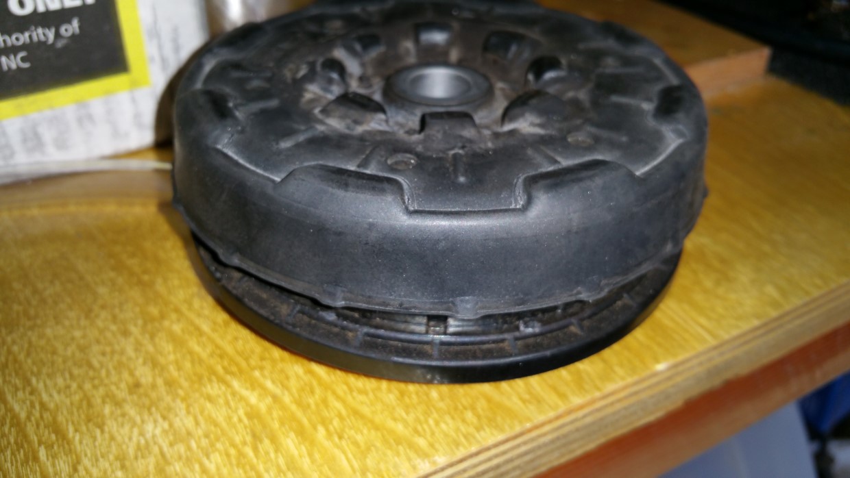

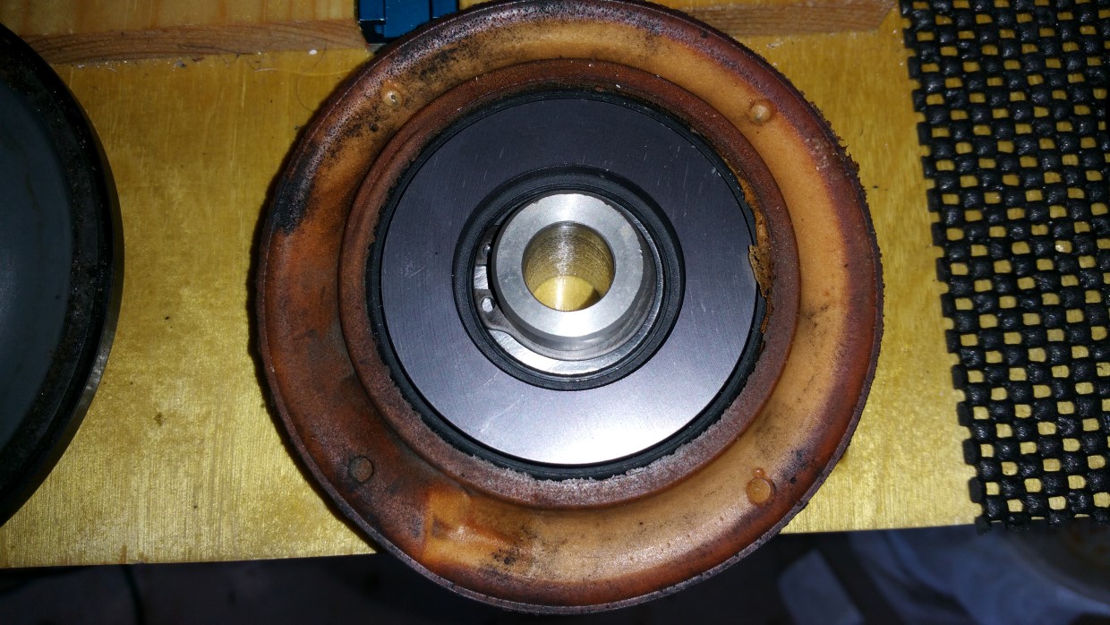

So, once you've followed the instructions, here is the 'black' top:
and the spring retainer you need to separate:
Lower part of the Moreno installed:
Now installed on the strut:

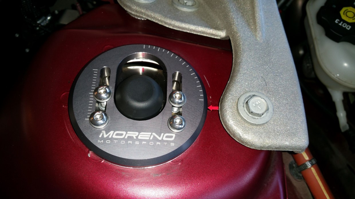

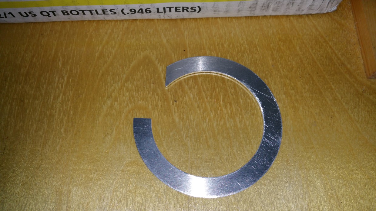

So to install the 'top' on the passenger's side on the late 2011, here is the spacer you'll need:
Installed!

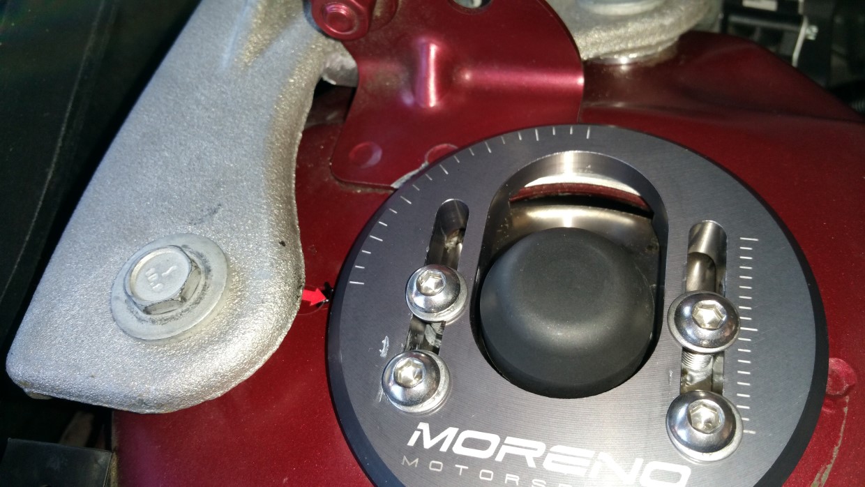

Now, the vinyl arrows don't stick well. I adjusted them and then used super glue to 'clear coat' it to stay. I did clean the area first and then applied the arrows...
Now, I did tighten the top camber plates, but when I 'moved' the car, the left strut 'slipped' so I had to adjust again and made sure it 'settled' properly. Tighten up and off I went -- no issues!
All done!
More to come...
-Don
747 RWHP 794 RWTQ
