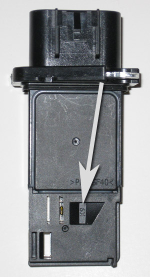

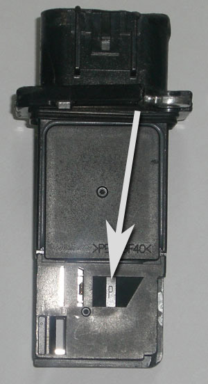

As far as the defective MAFs go, it is only on the earlier production cars and only a few of them and it only affects your car if you have done any mods to it, even just a CAI and exhaust. If you take your MAF off, you can look on the side of it. There is a small indented triangle looking area. If you have 1 letter or number in that space, it is a "weak" MAF. If you have a letter and/or number, then you are fine. Like I said, this only affects cars with MODS and not even all off them.
Go to http://www.vararam.com/camaro.html for further info.
As for me selling a "defective" Vararam, now Larry you should know better then that. Vararam thought my problem was the MAF so they sent me out a new one for free. They said if it stopped the surging, we can call it even. Well it did stop the surging BUT I wanted one of their new vararam units so I called them up and paid for the MAF and had them send me a new unit. If someone trys my old one and doesnt like it, I will gladly take it back!
Attachment 201297
Attachment 201298
As for me selling a "defective" Vararam, now Larry you should know better then that. Vararam thought my problem was the MAF so they sent me out a new one for free. They said if it stopped the surging, we can call it even. Well it did stop the surging BUT I wanted one of their new vararam units so I called them up and paide for the MAF and had them send me a new unit. If someone tys my old one and doesnt like it, I will gladly take it back!
Kirk,,,so let me get this straight..the Vararam comes with its own maf and you dont use the stock one any more? Or the stock one that comes with the car was defective?
So it fixed your surging?
What could be causing Scourges surging then as he does not have a vararam?
I should have known you had some kind of deal going on...lol
Is the new one differnet than the old?
LARRY>>>>>>> YOU ARE KILLIN ME!
The Vararam does NOT come with its own MAF BUT they are selling them at cost if you need to get a new one. It is still a stock MAF. MY stock one was a "weak" MAF, meaning it would work fine with the stock air flow but not that great with the increased air flow caused by the Vararam. There is only a small lot of MAFs that fall into this catagory and even smaller number that actually affect anything. My car wasnt surging too bad to begin with but it completely stopped with the new MAF and OLD Vararam.
The new Vararam does have a bit of a different design and flow to it and it also has some sort of screen or cone in front of the MAF to help settle the airflow a bit.
As for Scourges surging, not sure but if he is running an after market CAI, I would check his MAF to see if its one of the "weaker" ones. Just my 2 cents as I am BY NO MEANS the Camaro expert you have become!! I belive you have surpassed Dons Camaro knowledge!
Good post...
The MAF will provide the best, most accurate readings when located where there is linear/straight air flow, I don't think it's a MAF resolution or increased volume airflow issue. After a CAI install the engine still consumes about the same amount of airflow, and only really starts to breathe alot more air after mechanical change like a Cam/Intake or heads.
Not sure if GM really accounted for the large amount of aftermarket CAI pieces the consumer would install. Different intakes have Curves or bends in the piping could effect MAF performance, the Vram especially.
The older mafs had a screen to straiten the airflow before the MAF could read, these MAFS don't. Looks like the newer MAF design helps in these situations.
Good find
