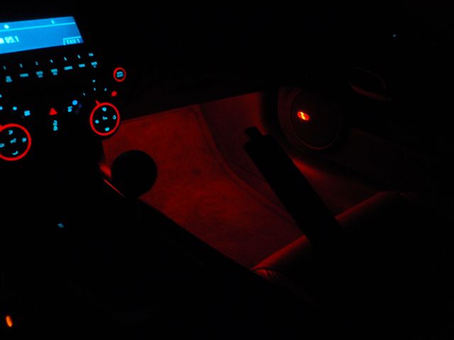

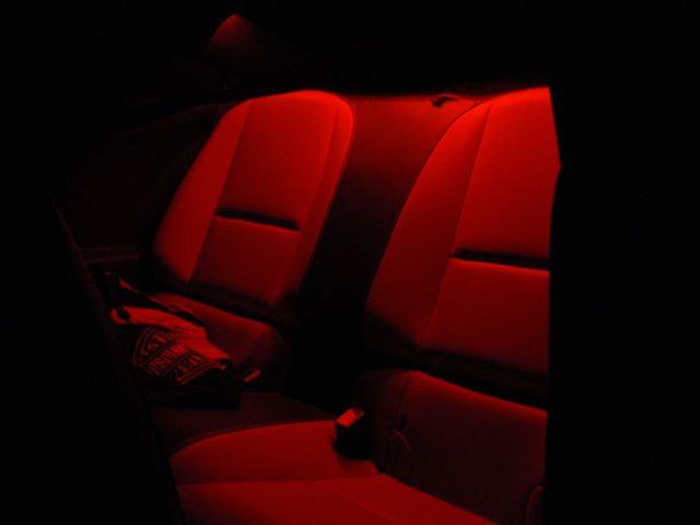

Interior Lighting
We are having great weather down here in AZ... good time to do some lighting mods!! In the 80's this weekend!! (Larry )
I bought two sets of ambient lighting kits from AAC in orange color and some orange lighted ring switches. The LED strips are about 16 inches long each.
I cut off four inches from two strips to make them 12" long and put each of the shorter ones in the front seat footwells, just under the lip of the dash. Then I put one 16" strip centered just behind the headliner stuck to the rear glass tight against the headliner in the blacked out area and the two 4" pieces (that were cut off the 2 strips) I put behind the headliner out by the C pillars.
I wired all these interior lights to the dome light circuit, so they come on when the doors are opened or the dome light switch is turned on. I also wired these same lights to a separate ring switch on the side of the center console, so the interior LED's can be turned on without turning on the overhead dome light while driving (so you don't get the windshield glare of the dome light). I had to put a Diode in the wire from the dome light circuit to the LED's so that when I use the ring switch to turn on the LED's, it doesn't backfeed power to the overhead dome light.
I wired up the last LED light strip to the underside of the hood, just above the underhood insulation behind the hood latch loop. I ran the wires down to the back passenger side of the hood hidden by the insulation and came out by the hinge and put another ring switch by the fuse box. It throws a nice orange glow over the whole engine compartment at night.
Here's some pics:
Footwell Lighting
The ring switch on the side of the console. Lit up so you can find it at night.

The back seat lighting.

Nice pics Don.... posting a teaser worked!
EDIT: Okay Don, just looked a the pics closer..... is that a BMR strut tower brace?
