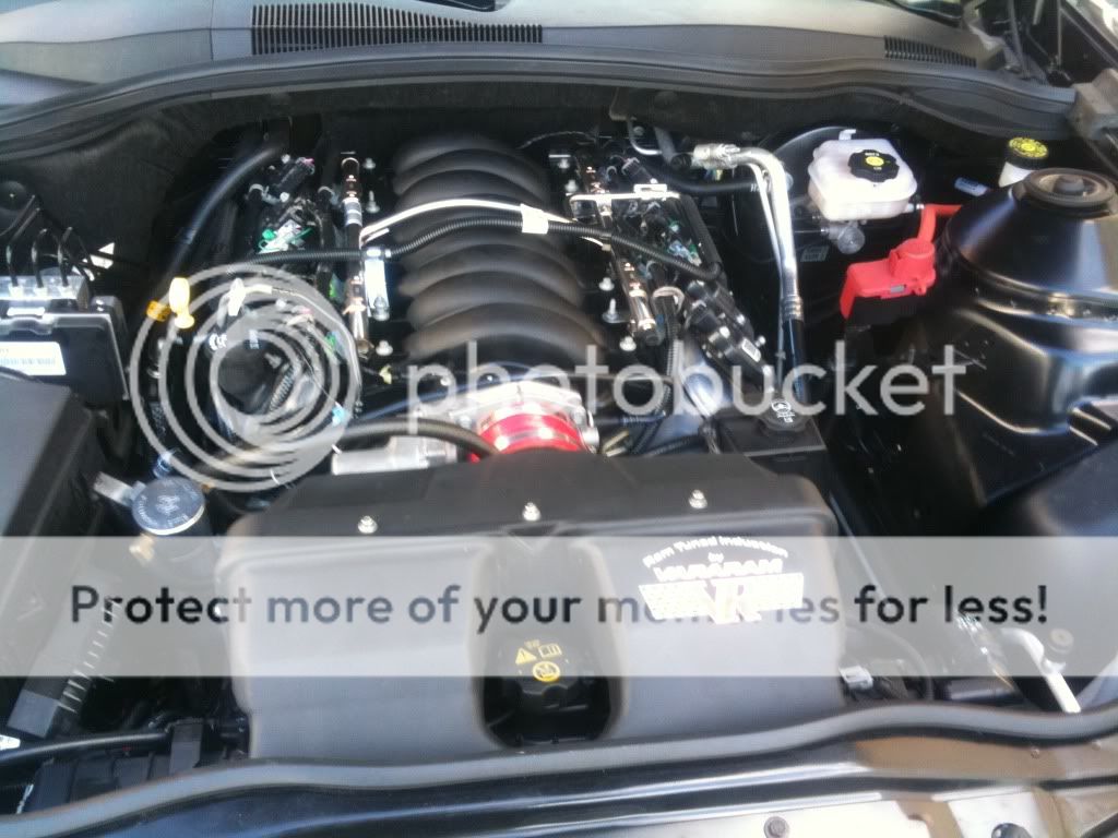

Got my Vararam installed today. Unfortunately, Autozone here in BFA (Bullhead F'in Arizona ) only had 8' of 5/16" fuel line for the catch can relocation. They had no stock of the 3/8" either. Had to run the hoses over the throttle body and remove the engine cover. So, I will be moving to civilization in February and will follow your lead of rerouting the lines across the rad when I can purchase the proper hoses.

I don't reccomend using fuel line as it is to soft and can collapse under vacuum and block or restrict the flow. Emmissions grade or trans cooler hose works well.

Vararam CAI, Elite Engineering Catch Can, Separate Clutch Fluid Reservoir, Ghost Armor Full Protection Package, Chromed Turn Signal Bulbs, RPI Stealth Splash Guards, Skip Shift Eliminator, Defenderworx Chrome Bowtie Inserts, Pfadt Trailing Arms, Camaro Decal Store CGM Hood Spears with "376ci" custom text, Billet Depot/Drake Underhood Polished Caps, CGM Lug Nut Decals, Pedders Front Radius Rod Inserts, JacFab Front License Plate Bracket

Here's another option with a VaraRam. I know it's not the best catch can but I pulled it off my totaled G8. I drilled a hole in the corner of the base of the underhood fuse box support, used a bolt and old rubber shock mount to raise it a little. I've since shortened the stupid long line from the valve cover to the intake. Think I'll replace it completely with a oil cap breather soon.
