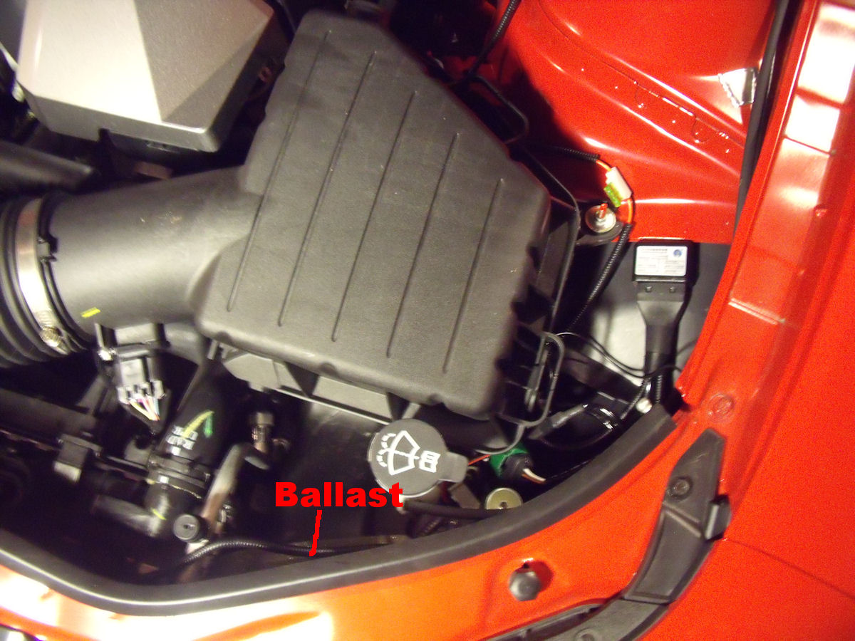

As for mounting the ballasts....the driver's side one I used a small self-tapping screw and mounted it to the radiator support. Because of my CAI I couldn't really find a good place to zip tie it to. On the passenger side I zip tied it to some of the wire looms on that side.

I don't have a pic of the ballast on the driver side but I'll get you one by the weekend if you still need it. The car isn't at my house right now.
Here is a pic of the passenger side. Again, just zip tied to some wiring loom.
On the driver side it's just in front of my CAI, mounted with a single screw just under the lip that has the rubber to seal the hood.
You can follow this thread I did to install the AAC lights. Installing the relay, power, and negative is all the same. Actually the TRS relay is exactly the same as the one AAC uses.
