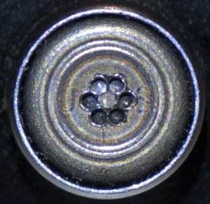

If the modification is so simple, why don't you just cut the plate off the tip of injectors and sell them? Nobody provides injectors that flow this much that still have superior control at low pulse widths. If you're so quick to bad mouth their stuff, why not take Paul's offer to buy back the ID850s? You clearly are equipped and knowledgable enough to replicate their product, and you already have the raw characterization data from ID, so you can just copy and use that, right?
Generating that data is part of the expense. Please refer me to another aftermarket injector company that is developing the voltage offset and short pulse adder data for injectors.
My quote from their site doesn't confirm anything regarding no waste. You're scraping tha barrel on that one.
Buy modded injectors somewhere else, and here's what you get:
ID does match injectors into batches. Any that deviate from their target range of operation get tossed. That's a fact.
I guess I'm trying to figure out why you're trying to take away from the quality of what they offer when you said you've become quite "found" (I think you meant "fond") of the ID850s.
