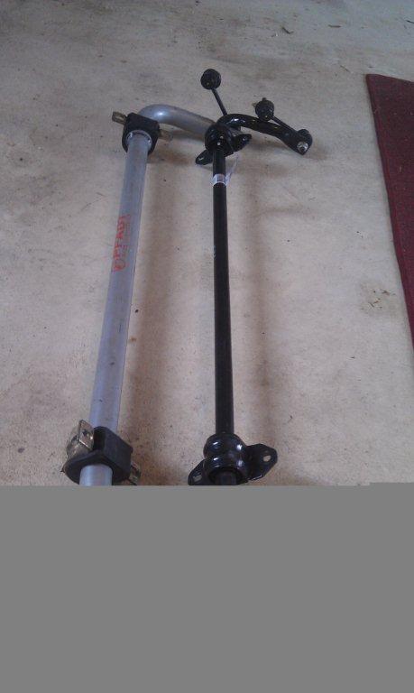

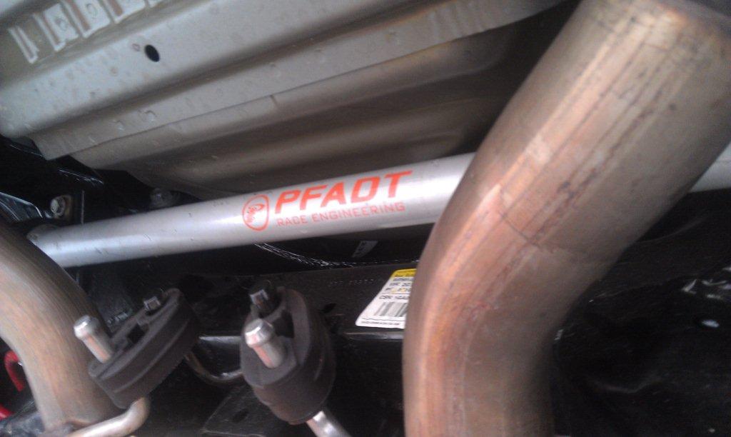

Pfadt "sport" sway bars installed
WOW!!!
Just took the car for the post sway bar installation test drive and at the risk of sounding like my tween daughter..... OMG!! Upgrading the sway bars makes a world of difference. I never have really liked the stock tires, I thought they were too hard and never got enough traction. But after the test drive today, in cool-ish weather (about 75 deg F) post rain, the car drove like it was on rails. I was VERY impressed. One of these days I'll get to the road coarse...
stock vs. Pfadt 'sport' rear bar
rear bar installed

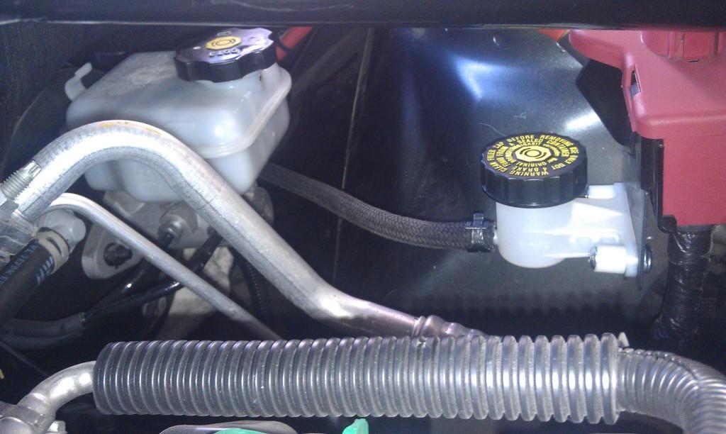

A few new small parts installed:
GTO clutch reservoir:I decided to add a second reservoir after reading some of the other trheads on C5, so I ordered the reservoir online and go the other little pieces from other forum members.
UPDATE Aug-17: Got the parts quick from Ed (http://www.camaro5.com/forums/showthread.php?t=214983)
UPDATE Aug-23: GMPartsDirect shipped my part. about 2 weeks of backorder.
UPDATE Aug-29: separate clutch reservoir installed. The hardest part was getting the hose back on the clutch connection at the firewall, but the job was more difficult overall with the strut brace installed.
Heater hose relocation:I just bought the hoses from a C5 member that had these as part of a Whipple kit but had already done the hose relocation prreviously. So I won't do the fuel and evap line but I'm not worried about those.
After install comments -----------> so I ended up not using the smaller hose from the Whipple kit because I couldn't get it onto the water pump flare. I bought the Gates #18078 from O'Reilly with 5/8" on one end and 3/4" on the other (from Caverman's suggestion in his DIY post - http://www.camaro5.com/forums/showth...ht=heater+hose). Who knows why GM has these opposite sizes on the firewall and water pump?????? I did like that the Whipple kit had hose guards/sheaths so I used it on the Gates hose after cutting to the proper length. These small issues always come up with me because I try to get out cheap or do things in my own unique way and it usually costs me a little more than it should have. I think I was in $70 here whereas I could have done it for about half that.
