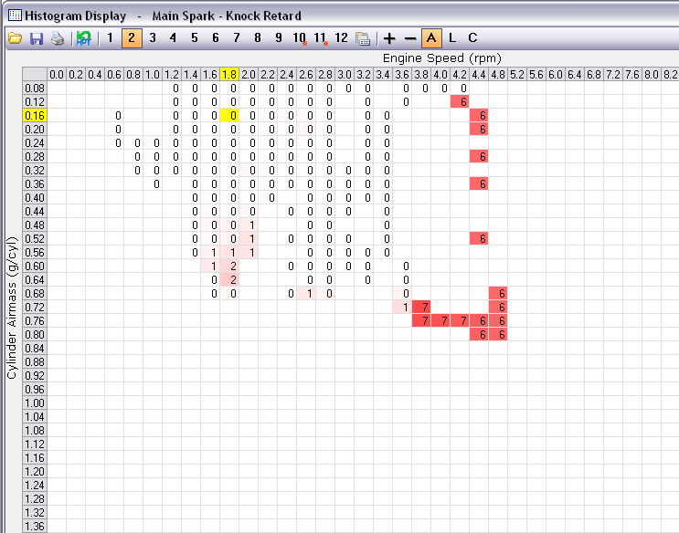

Pictured is after about 60 miles with the 87 octane. Hopefully tomorrow will give a better comparison to the 93 tables as the trip should be very similar. That said you can see the difference already, although I'm not feeling it much if any.

as expected. what will be interesting is if those tables auto-correct with 93 or if they keep the same values locked in after the switch.

I had assumed the point it would lock was in cells where 1.00 KLF was achieved. But it appears that may never happen since the highest is only about 34% of that. I had heard that that stock timing was too high in certain places (cruise range) and I'm beginning to believe that may actually be the case.
While I'd like to see what the numbers look like at WOT at the very top, based on the numbers so far I'm not willing to go there for this experiment. I have about a half tank of gas left, so unles the numbers change drastically,over the next couple of days, this will be the final 87 octane scans posted.

there is a good amount of timing being pulled up high...dang 87!

I'm a bit nervous about this, because there are times, when opportunity knocks, that I will start to open it up, then remember 87 is in there, and have to back it down for engine health reasons. There is no way I'll run 87 again and am going to have to be careful for the next couple of days.

i don't think there are is anything to worry about. there are quite a few nanny's built in that pull timing prematurely to keep things safe. if you don't do it...i'll be doing here shortly. the only thing you'll notice is that it doesn't have the same performance that your use to.

Interesting thing about the nanny's it that the knock happens first even though after a while it is predicted but it's the initial hits before that worries me. But I come from supercharged V6's where knock would chip pistons. Low to mid performance is still there if not a little better although I didn't expect that. While surprising, kind of follows what some have said about too much timing from the factory. I can't verify any of this yet, but once this test is over, I may play with with the timing in certain spots. Would be best to do on a dyno, but I'm not up for spending the money to do so.
