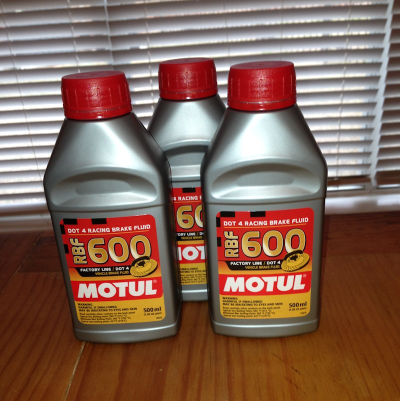

Next up Motul RBF 600 DOT 4 brake fluid. Getting prepped for Eagle Canyon in a couple weeks.

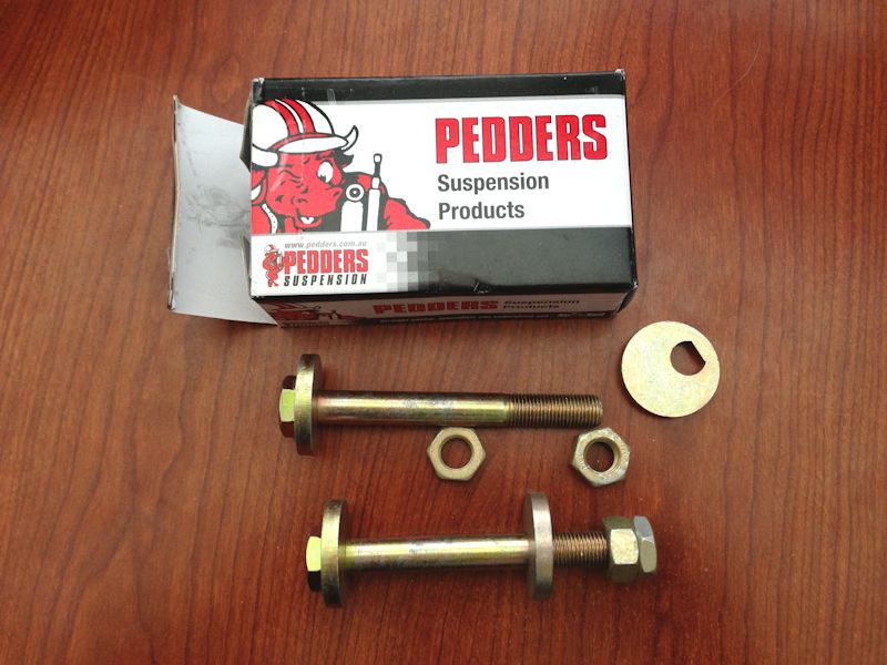

Added some Pedders rear eccentrics bolts. They allowed my alignment guy to get the car to the Pedders Aggressive Street alignment.
