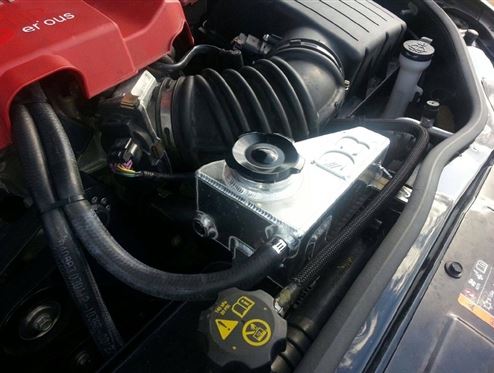

Thanks for the info, I know I'll be doing an ADM CAI, and still looking around for a reservoir. Sort of leaning toward the D3 reservoir, but will definitely need to do some logging and see how it goes.
Attachment 544768
I'll let you test this stuff out, hurry up please.
Attachment 544768
Did you end up going with just the reservoir or doing the hx?
I did the D3 Reservoir and a Ron Davis HeatX. Very happy with the setup and IATs are pretty much under control now.
Old 09-03-2015, 10:39 AM   #39
BattleScarredSoldier's Avatar
Drives: 14 Camaro ZL1, 87 Grand National
Join Date: Sep 2014
Location: Houston, TX
Posts: 131
Thanks!! Im going to go ahead and order those today. I pretty much always take your advice Mike, whether its on this forum, H town Camaro Club, or on fb, thanks for always giving good feedback and input. Hopefully, whenever they let me come home, I will catch up to you around Houston.
