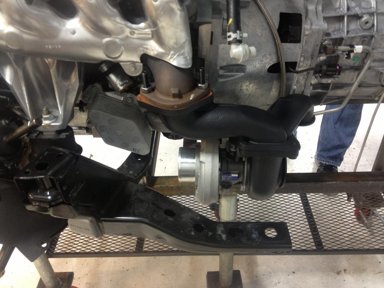

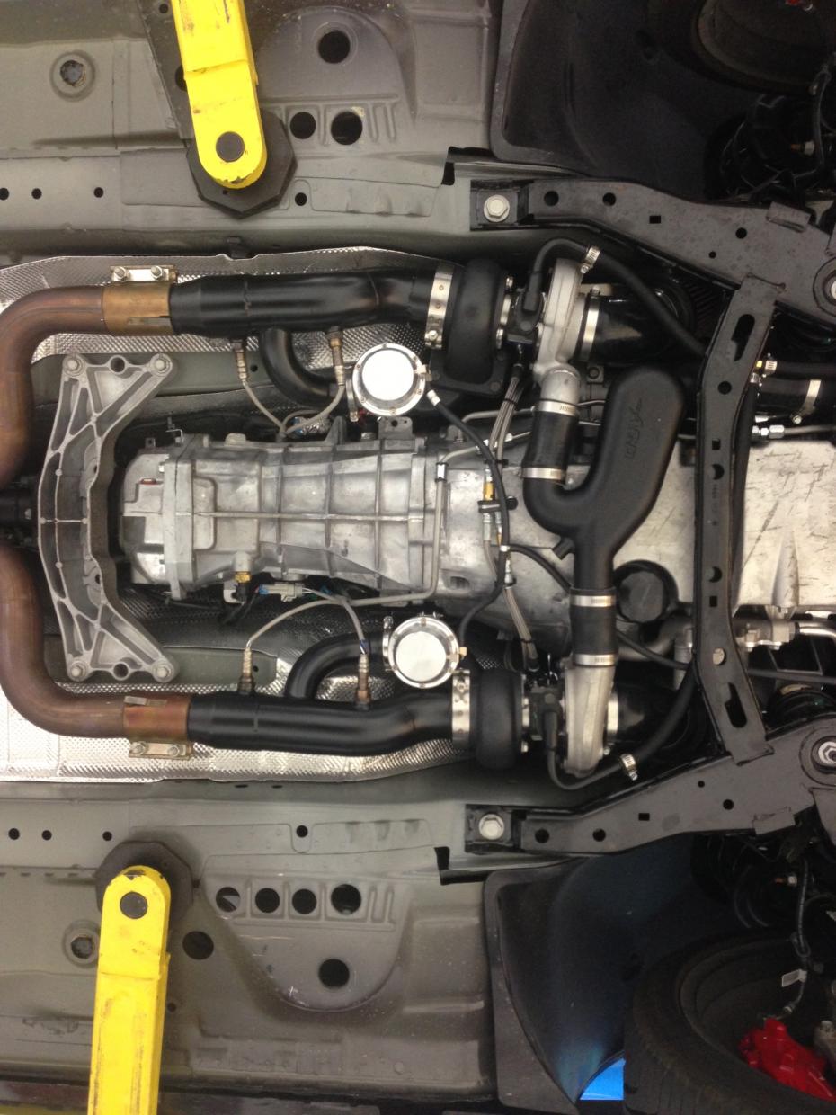

10 Sep 13
Kit goes on and engine is installed.
Who Dares...Wins
SGDM is offline   Reply With Quote

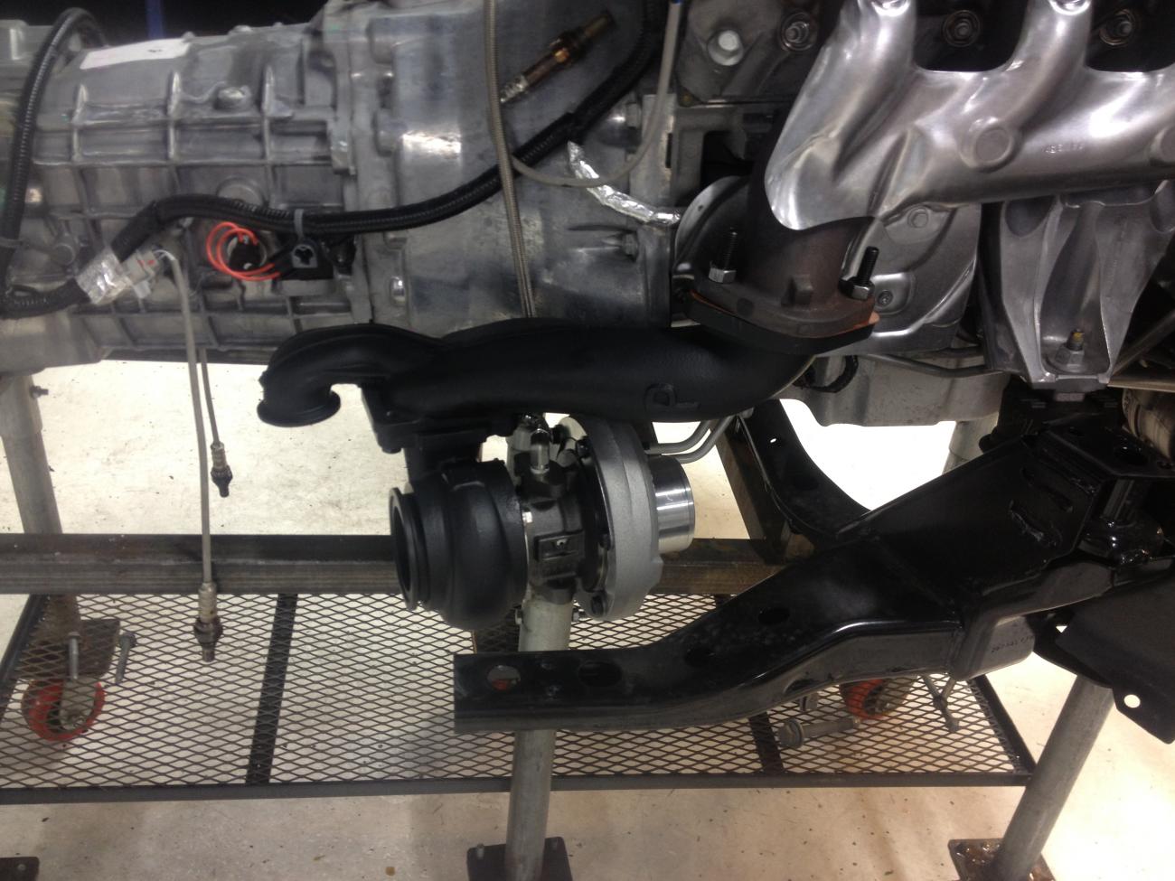

Almost there...

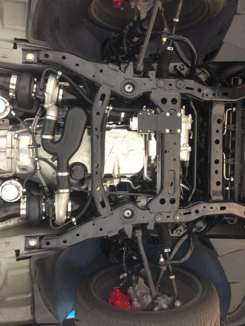

11 Sep 13
9-11 Remember the Fallen
Everything is back together and a new TT is born. I think Andy is more excited about this project than I am. This Kit is very clean and slick.

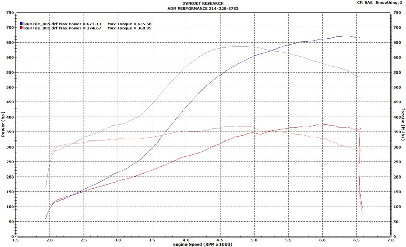

Dyno!
Conditions for base Dyno:
1580 Miles on Car, 94 Deg F, Humidity 30%, 29.90 HG
Conditions for final pull:
Hot and getting hotter!
Here is what consisted of the install.
AGP BASE TWIN TURBO KIT W SMALL INTERCOOLER 9-10 PSI
ADM INSTALLED LS9 CAM AND SPRINGS(26918)
"NEW ADM FPCM FOR 1LE AND NPP CARS"
GM NPP EXHAUST SYSTEM AND CONTROLS
AIR OIL SEPERATOR BY ELITE AND GM
STOCK THROTTLEBODY
STOCK INTAKE MANIFOLD
STOCK CLUTCH
STOCK GEARS
STOCK MANIFOLDS
STOCK FUEL PUMP-1LE GETS ZL1 PUMP FROM FACTORY
93 OCTANE FUEL
ZL1-UNDERBELLY
Who Dares...Wins

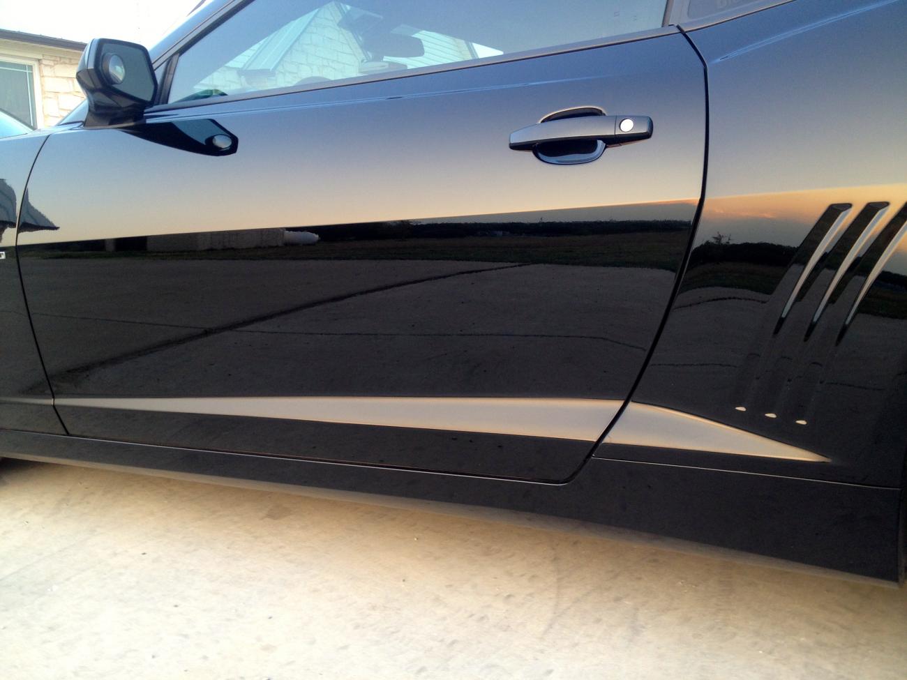

13 Sep 13
Back to Big Worm for subdued matte black side stripes.

15 Sep 13
This car is a Beast and extremely powerful. I have been driving it quite a bit and monitoring systems at different speeds and RPM. The car drives like a stock Camaro until you open the throttle and sounds very aggressive. There is not any Turbo lag as far as I can tell, the cam picks up the low end and the turbos start to boost about 2800 RPM and at 3400 RPM it transitions into a Rocket Sled. It is pretty damn fun to drive!!
I have been driving in all traffic conditions and it has been 104 Deg F
IAT - 110 to 130 Deg
Water Temp - 194 Deg
Xsmsn - 205 Deg
Everything has been normal...Green and Groovy.
