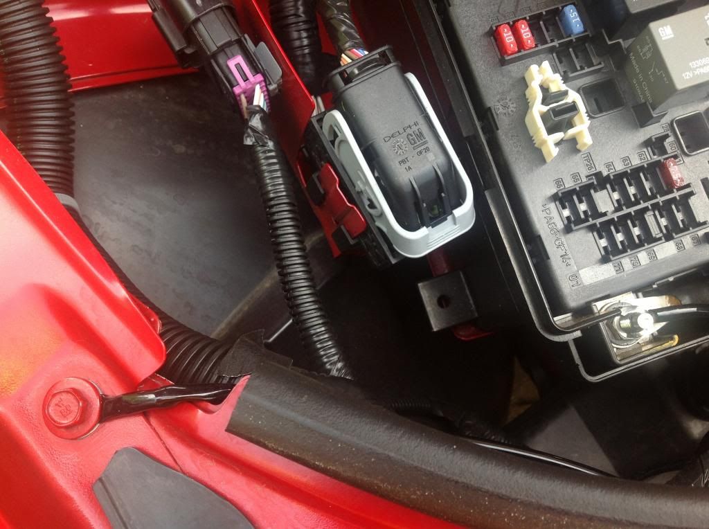

One does not need to lift the car and if the car is not lifted, unscrew the three torx screws from the wheel well. Also, I used the power stud in the relay box for the power wire and used a chassis screw close to the power stud for the ground wire to power my HIDs.
