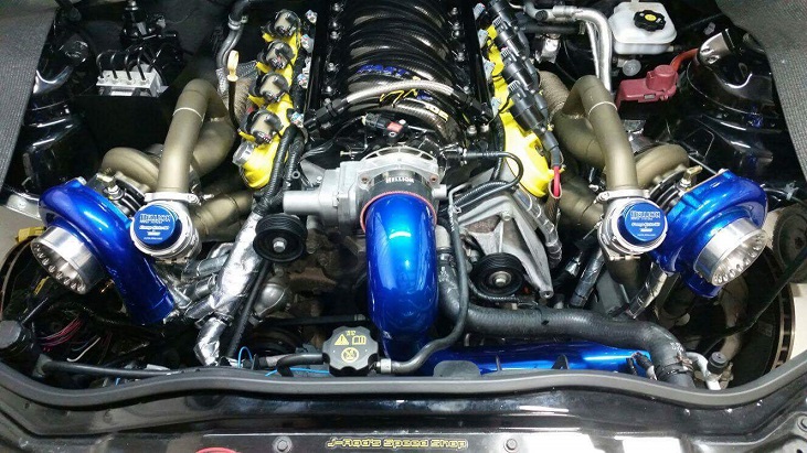

The car is currently in the shop (dropped off about Thanksgiving) for the big upgrades. I am hoping to have it back in the next week or two.
Here's everything that's being added:
ZL1 driveline
From JDP (very great service and patient with my dumb questions!)
Mantic twin disk clutch
FORE innovations triple pump system
Alky Control Meth Injection system with a trunk tank
From Moreno Motorsports (also very helpful, and great pricing!)
Hellion twin turbo top mount Eliminator system. Kit included 62mm ball bearing turbos. I ordered what was needed to convert the car to e85. id1700 injectors and all the supporting goodies.
I'm very excited to get the car back!!
Al Moreno and Jeff at Hellion helped me out a lot.

Here's some pictures of the turbos going in.
