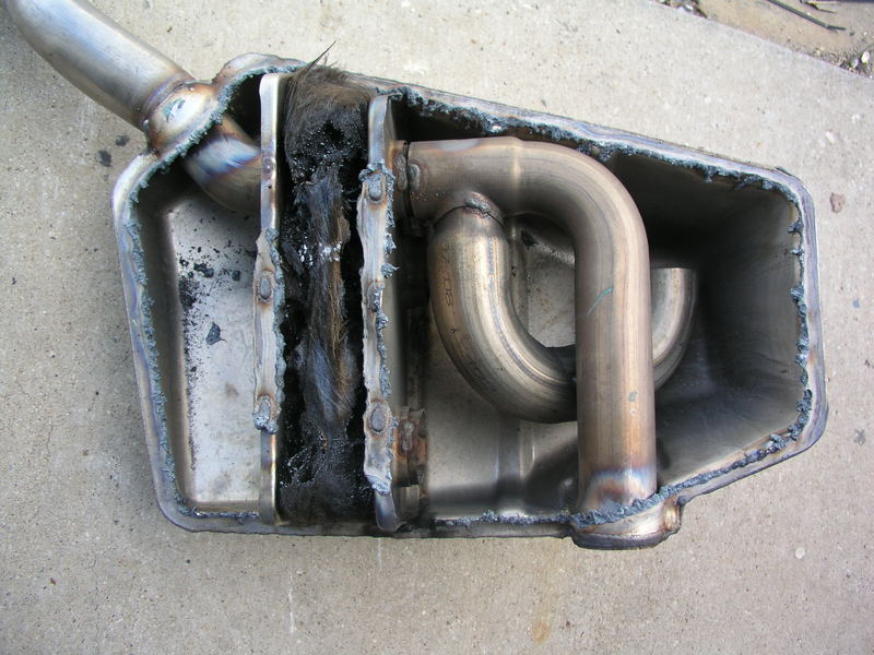

Also, I do believe the factory 'spam can' mufflers have j-pipes or an open end to help with the 4 cyl mode -- saw them cut open...
-Don

Here is a pic (L99 I believe):
-Don
747 RWHP 794 RWTQ
