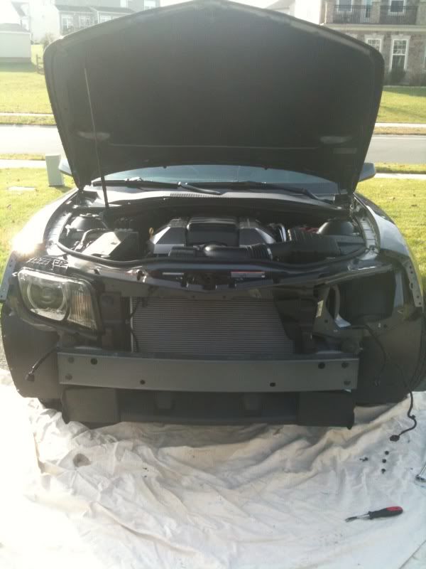

I put my absolute best foot forward in repairing this dent today. While It did not come out 100%, it is very very close. There were a couple of (minor) problems encountered today when I got a chance to see it in broad daylight for the 1st time. First the body line was hit harder than I initially realized, it was actually inverted from the hit it took, second the wood that hit it scored the paint which always provides an opportunity for the paint to crack as the crack will often follow the lines or scoring that are embedded in the paint, and 3rd the wood grazed the clear coat off the car. While the paint wasn't damaged all the way down to the metal like you would see when the paint gets chipped, there was some definite discoloration that became more evident as the fender was repaired and the light began to hit it better.
Anyways here is the repair process from start to finish...

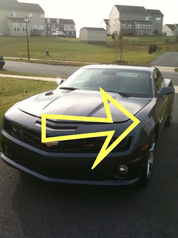

When dents show up in pictures from this distance, you know they are pretty substantial.

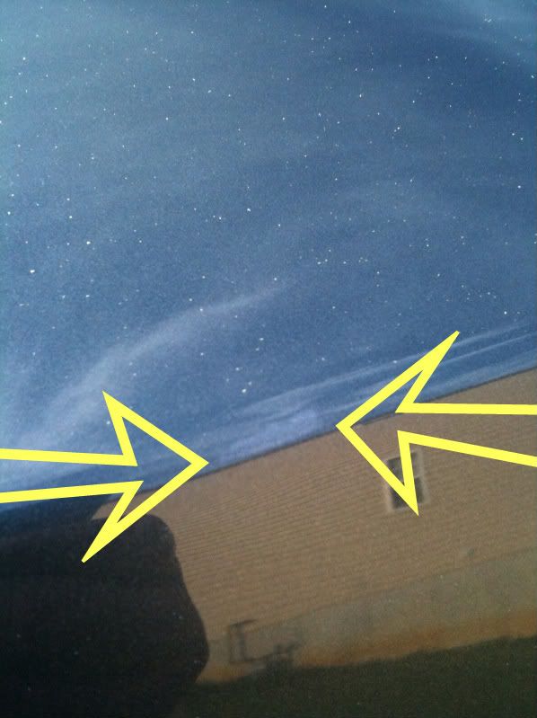

Closer view showing body line completely flattened out with the metal bulging at both ends of the dent (we call these "smiles" or "eyebrows")
I decided immediately after seeing the dent the other night that going through the front of the fender would give me the best leverage. Takes a little longer, but is the right way to do it. Here is the front end disassembled.

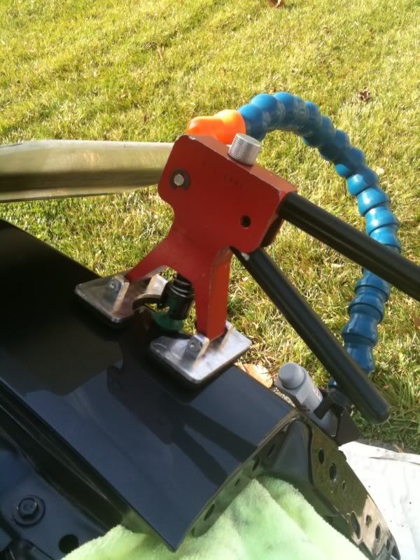

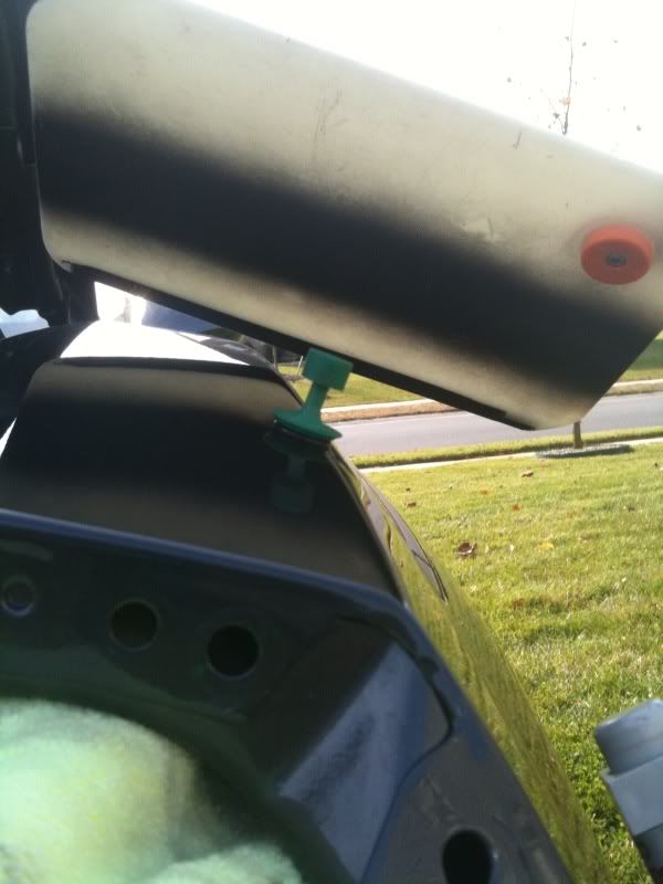

I utilized two different methods including both the glue pulling device along with conventional PDR tools. Here are a couple shots of the glue tab and puller.

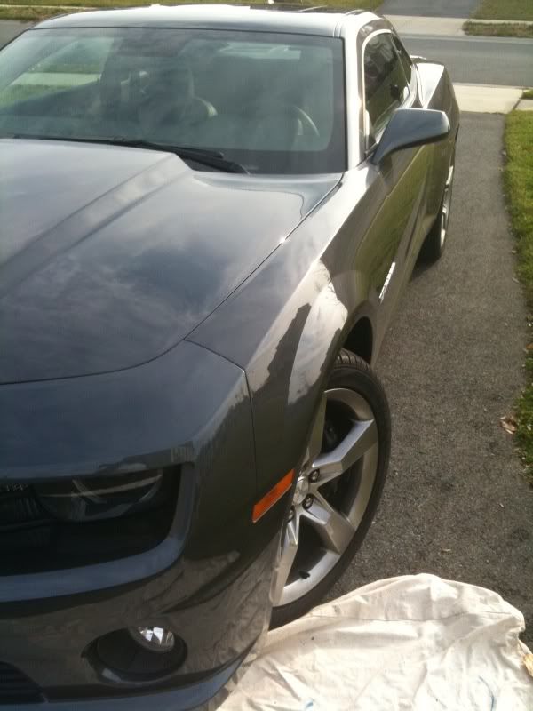

Here are some shots after finishing and reassembling the car.
Here is the light spot where the clear was worn away. Buffing made it a little worse so I decided it best to not continue with that.
I recommended blending or "spotting" in some clear coat to bring this repair closer to completion. As it sits now it's about 90-95% better. If I had gone any further with this dent the paint would surely have cracked wide open and metaphysician would have no option but to put it in the body shop and have half the left side painted/blended. I am disappointed that I couldn't take it the last 5-10% but I made a call to leave it as it is vs. a sure body shop repair. I hope you left happy and remain so after seeing in the daylight for the first time tomorrow
