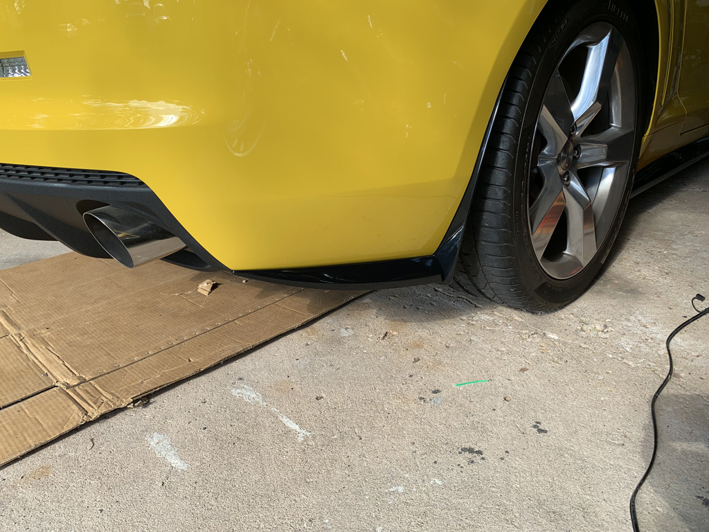

Everything except the splash guards/deflectors and splitter were pop riveted to the body. Since I didn’t have an extra set of hands to install the Splitter, I took the front bumper back off and put some heavy duty folding tables together. I then clamped the Splitter to the bumper and stood it upright. I was then able to carefully position it to hang over the table in the spots and starting in the center, began drilling and bolting the Splitter to the bottom of the bumper.
The winglets were probably the biggest pain to install. It would have been nice to have a second pair of hands (hence to the two filter boxes shown in the one picture). But I could not get the rivet to catch enough of the factory rocket to hold it in place. I couldn't find any access inside the factory rocker, so I had to get a few washers between the winglet and the T4 rocker to allow the rivet to expand. They were officially installed on November 10, 2021.

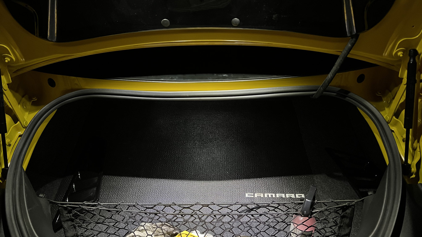

And the ACS Trunk Liner was installed and wired up the next day. It uses the same Eagle T lights that are in the T4 bumper ports, and it is really like a pair of headlights shining down into the trunk.
Name:  2021-11-20 14.06.40.jpg
Name:  2021-11-20 14.16.19.jpg
If you look really close, you’ll see the Upper Rear Quarter Ports peaking out of the shadow. That will be the last painted part to get install, but there are still sitting in the trunk at the moment.

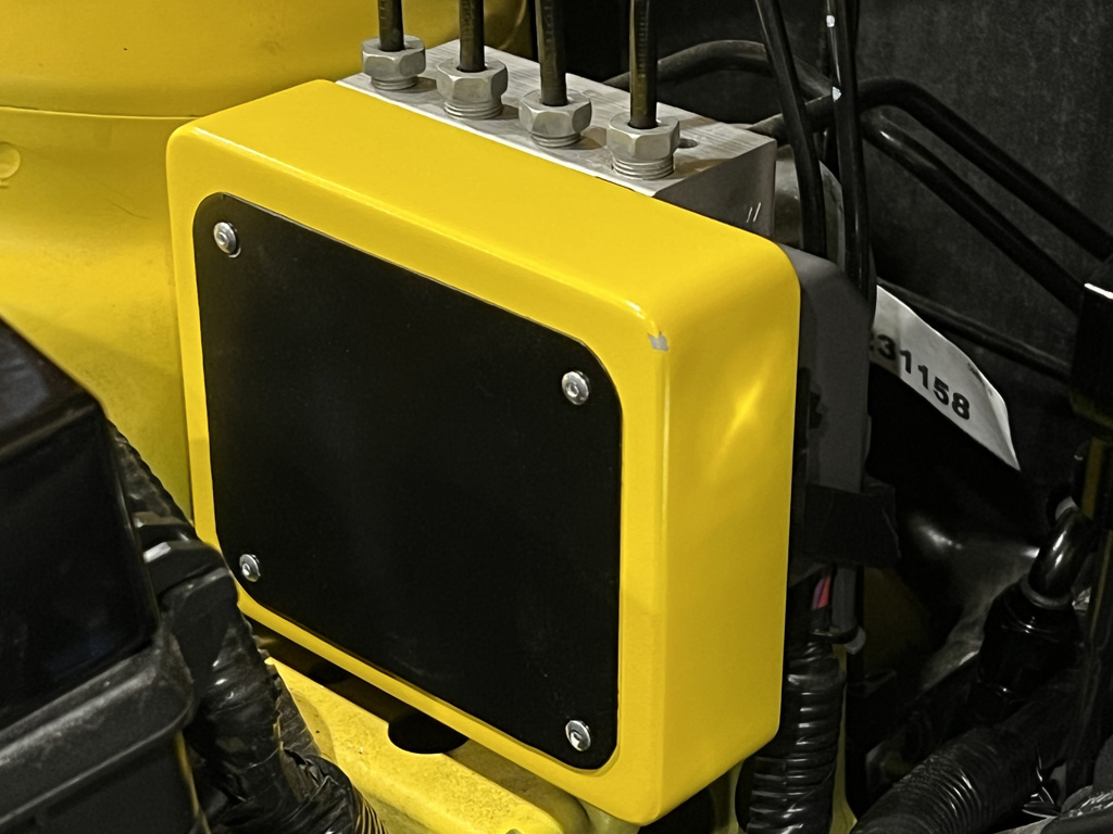

With this post, I will finally be up to date on my build. (If you made it this far, thank you!)
As I may have mentioned a few times in my previous posts, a long-time goal has been to get under the hood show worthy. In between updating the exterior, I was also collecting and preparing some more goodies…and with this round of updates, I think I am about 95% there. At some point, I may get brave enough to redo some of the wire harnesses and paint the coil packs. But for now, I am happy with how everything looks.

Billet ABS Cover (modified)
Name:  2021-12-27 14.35.05.jpg
Name:  2021-12-27 15.46.36.jpg

For the yellow covers, I still had a can of Krylon Fusion Sunbeam back from when I attempted to paint the factory engine cover. The color is almost a perfect match to Rally Yellow, and thankfully I had just enough to paint both covers. I then went with Satin Black for the panels, which were cut from sheet aluminum I picked up at Lowe's.
Without further ado, here is how it all comes together!

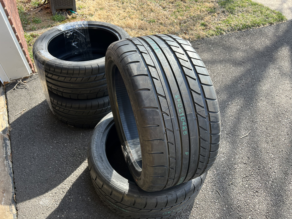

Today, the new tires arrived!
Mickey Thompson Comp Street Tires
Front: 275/40-20
Rear: 305/35-20
Name:  2022-03-15 15.37.04.jpg

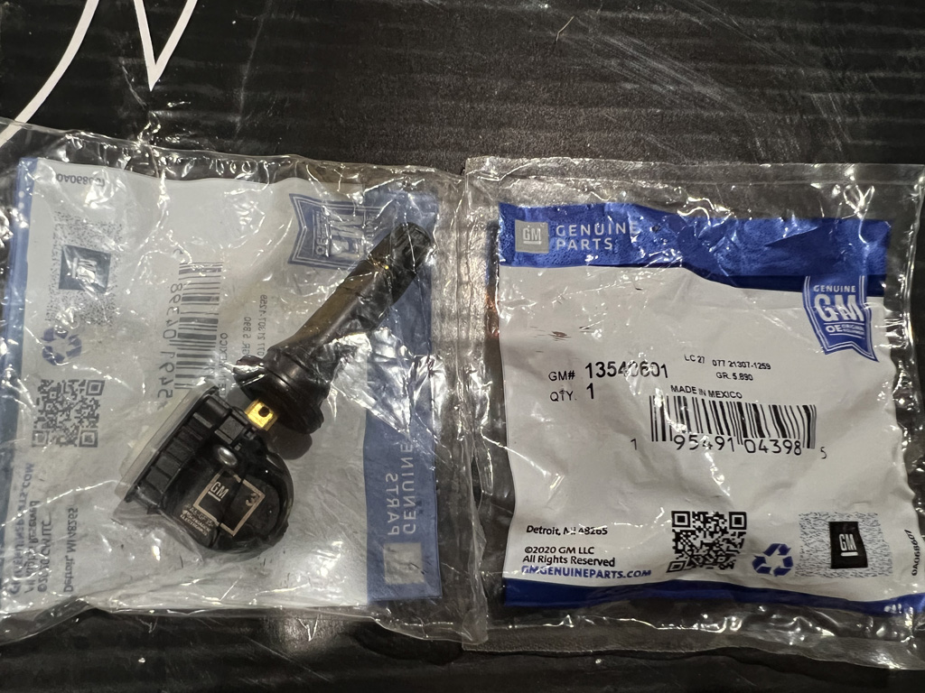

Since the TPMS sensors are still the originals, I figured it would be a good idea to throw a new set in as well. I went with ACDelco (Part# 13540601)

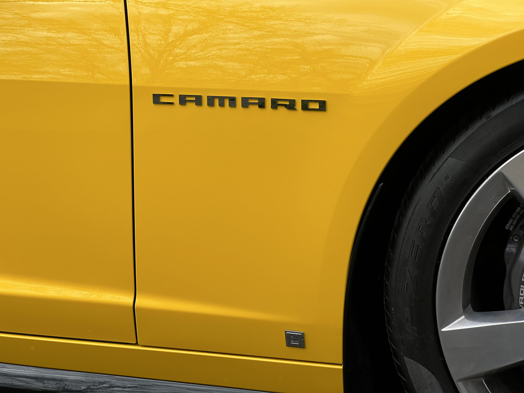

While my search continues, I thought it was time to finally swap out the Emblem Pros Onyx Camaro fender script. I did one letter at a time so I could keep everything lined up like it came from the factory. I started out with just a hair dryer and dental floss to pop the old letters off, but all the double sided tape stayed on the car. I then used a plastic trim removal tool as a scraper to get the bulk of the tape removed, followed by Adam’s Bug Remover and rubbing alcohol. The first couple letters took forever, so I did some searching on the forum and found a few recommendations for 3M Adhesive Remover.
Name:  2022-03-19 17.35.02.jpg
Let me just say, that stuff worked amazing! I would spray a tiny bit on a rag and gently rub over the residue and it would instantly start to dissolve. I then followed up with the Bug Remover and alcohol before putting the new letter on the fender, using a wooden ruler as both a straight edge and to equally space each letter 10mm apart. I’m not sure why, but the factory C and A were a little closer than the rest of the letters. But since a few of the Emblem Pros letters were slightly narrower than the factory lettering, it happened to work out by covering the same overall space.

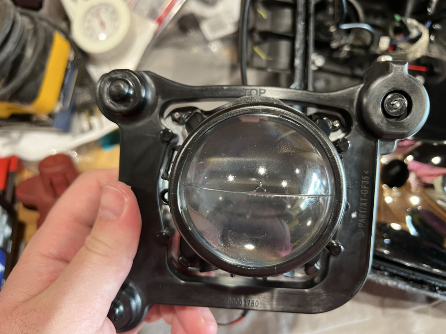

Since it wouldn’t be a good build thread without posting some lessons learned, I spent the last few weekends correcting a couple things that weren’t installed correctly the first time around.

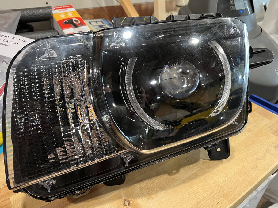

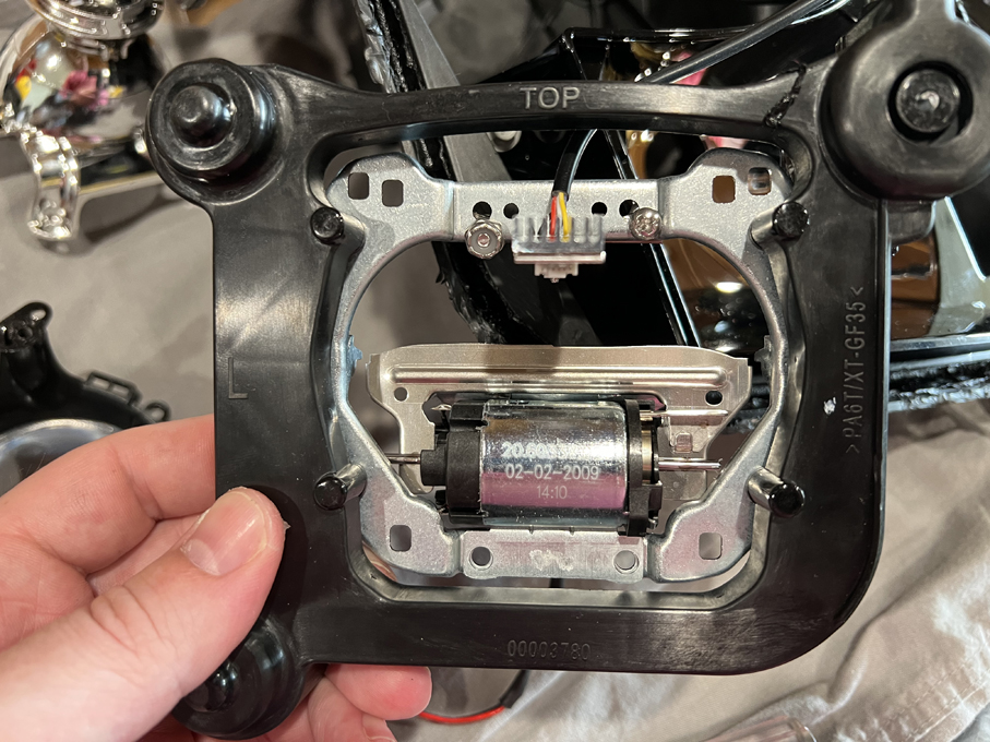

First up was my demon eyes. In the first pic, you can see the heat sink protruding down into the headlight. It was something I don’t remember seeing at first, but then once I noticed it I couldn’t un-see it. It really was pronounced whenever I would take pictures (especially with the flash on). I went back through all the pictures I took during the installation, and found one key step was missed. Unfortunately, to correct it meant I had to reopen the headlights to get back to the projector housing. On the plus side, the new butyl made it much easier to get the headlight open…I just baked it in the oven at 250 degrees for about 5 minutes and used a long/thin screw driver to pop off the lens. But one thing I wasn’t quite prepared for was the gooey mess. I found the best (possibly the only) way to get the butyl off the track was to use a ball of butyl. The factory butyl was hard whereas the aftermarket butyl was extremely sticky. A few hours later, I had them cleaned up enough so they could be resealed. But before that, I still had to correct the demon eye issue, which took all but two seconds to fix. After unplugging the projector beam, I removed the four torx screws to gain access to the demon eye/heat sink. I then gently bent the demon eye up about 45 degrees from the original position. I triple-checked to make sure the new position could no longer be seen and then resealed the headlight.
Name:  2022-05-14 13.28.11.jpg
Name:  2022-05-15 15.14.34.jpg
Name:  2022-05-15 15.15.41.jpg
Name:  2022-05-15 15.25.09.jpg
