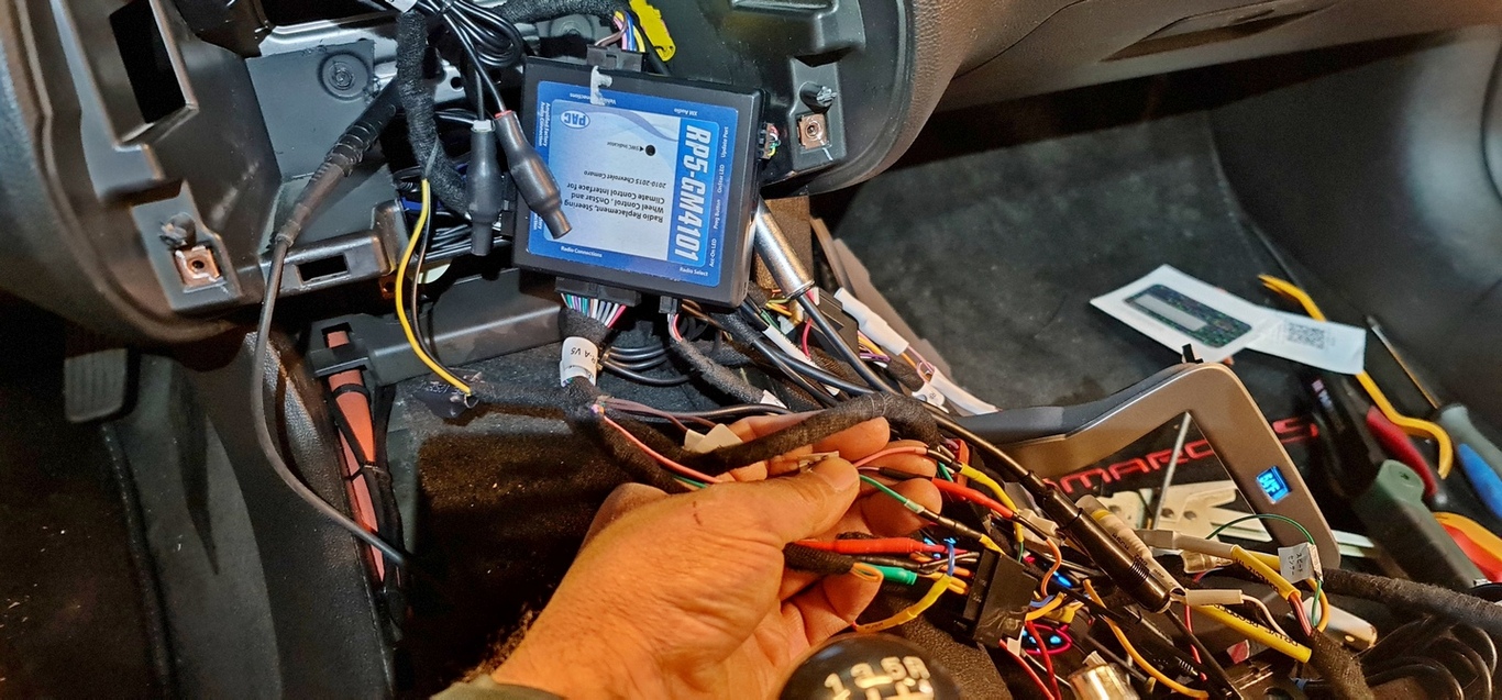

RPK GM4101 in Croatian Camaro
Hi guys, I just couldn't find earlier an appropriate part of forum where I could introduce myself, found it later on.
This is RPK installation in my 2010 Camaro SS.

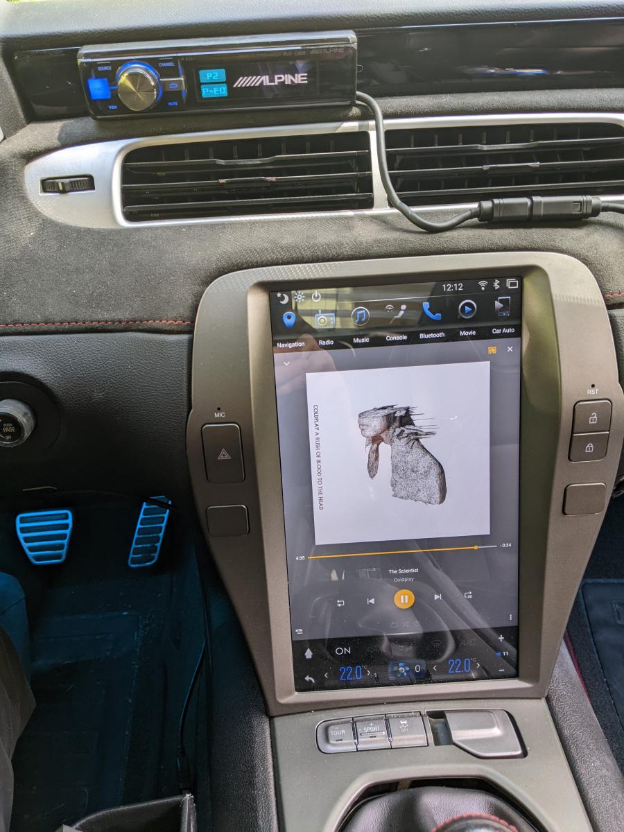

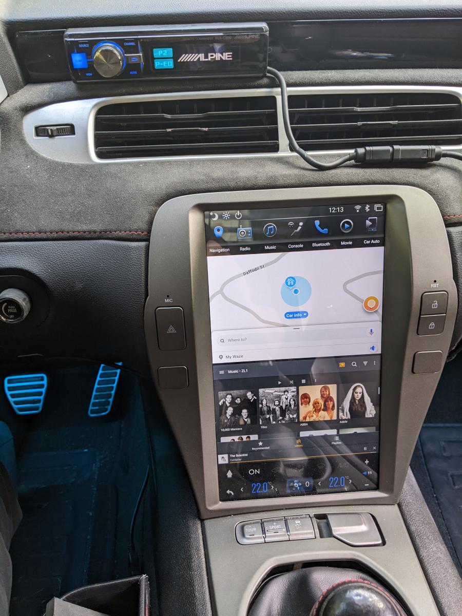

I have recently installed the Digital Octopus DOTS-1015 into my 2013 ZL1 and it works well.
My system configuration is a little complex with the DOTS-1015 running Plex Media Player casting over Wi-Fi to a Win 10 PC running Plexamp and Plex Media Server with 1TB of FLAC music which is the routed via 5.1 TOSLINK to a Alpine DSP PXA-H800 ie. no DACs in the signal chain. The DOTS-1015 has all the functionality and versatility that you would expect from Android to support this configuration.
The DOTS-1015 supports all of the Camaro CAN signalling that is needed, and "more". The "more" is support for other manufacturer's or vehicles, which means that there are some menu and screen functions that are present but are inactive eg. HVAC supports dual zone which the ZL1 does not have. The DOTS-1015 large screen modernises the look of the dashboard, and I am happy to be with out the stock non-viewable console gauges and funky HVAC controls. Android OS and applications update automatically and regularly, so the system must be "phoning home" over the LTE connection.

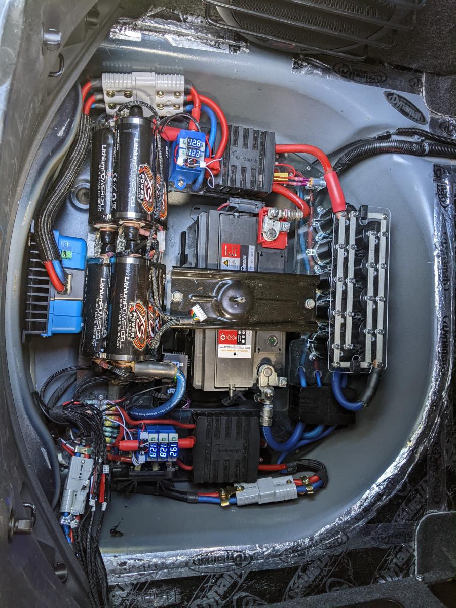

Photos are of Plex Media Player and Waze split-screen view - Plex Media Player album view - Plex Media Player libary view - Waze full screen - SxxTxxxx Amp rack with cover off and Zotac ZBOXNANO-ID68-U PC & Alpine DSP PXA-H800 & DSP PDX-V9 amplifier - SxxTxxxx box and Alpine SWS-10D4 sub-woofer - SPS-610CG 2-way components mounted in parcel tray (tweeter in C-pillar) & cross-overs & LTE modem with omni-directional quad antenna, and rear seat pass-though is retained (SPS-610CG 2-way components are also mounted in doors, with all speaker routing using OFC cable) - power supply and audio system is autonomous from starting battery, "real" 0.47F capacitor array, Victron 360W DC-DC charger from engine alternator to 40AH LTO battery array, DCDCNUC 19V power supply, TDK DC contactors, KnuKonceptz cable & fuse/distribution blocks.
