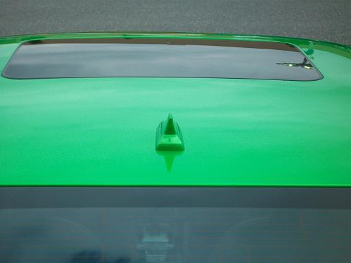

JoeP@TeamBeckyD
JoeP@TeamBeckyD's Avatar
Location: Detroit, Mich
Posts: 68,623
a couple pics of a Synergy Green, I delivered today...
Old 08-23-2010, 01:46 PM   #34
GTAHVIT
Blessed
GTAHVIT's Avatar
Drives: 2013 Sonic RS MT
Location: Saint Augustine FL
Posts: 28,441
That really does look so much better.
