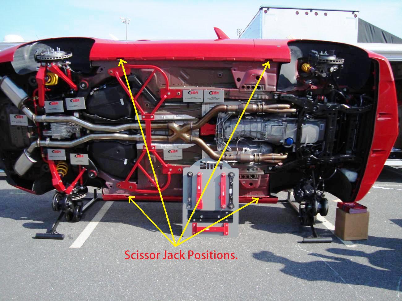

I've had mine on no less than 6 lifts at 6 different places and NONE of them did it that way. I can't tell you where the proper lift places are for this car on a lift, but I've jacked mine up many times already and it's really not hard to find. (Even though I had to call a former member to make sure. lol)

Actually, if you look at the manual on this. It's gonna tell you to do it under the rocker panels at certain points but for a large lift pad it won't work well. So if this guy followed the GM manual, he's doing it right.
BUT, common sense tells you NOT with large lift pads. Again, I don't know where the points are for lifting the whole thing, but I have been lifting the whole front with a pad and using the large cross member on the frame, in front, and the suspension arm joint in the rear, with the jackstands in a different spot. I'll try to get a pic, since mine is on stands now.

I'd have punched that MF'r in the face. That rocker panel and body seam is not the lift point.
The lift point is right behind there. In front of the rear tire, look under there and behind the rocker panel is a reinforced flat spot. You'll see two round holes and an oval hole between the two round holes. Looking in those holes you can see that it is a reinforced area - two layers of steel thick. You flip up the hoist pad ___/ , and lift it there.
Every Camaro I've seen lifted on a hoist, the pads are flipped up and lifted by the reinforced area behind the rocker, not leaving the pads flat and smashed against the plastic rocker panel and body seam.

This is the way I currently do it.
Name:  With floor jack..jpg
The manual says do it here. But I'd only do it this way with a scissor jack
that will not touch the rocker panels.

On GM Service Info, it shows the front pads flat on the big "torque box" (so they call it) right behind the front wheels. The rear goes on the large flat spot, right on the other side of the pinch weld, with a short raised pad. ___\
