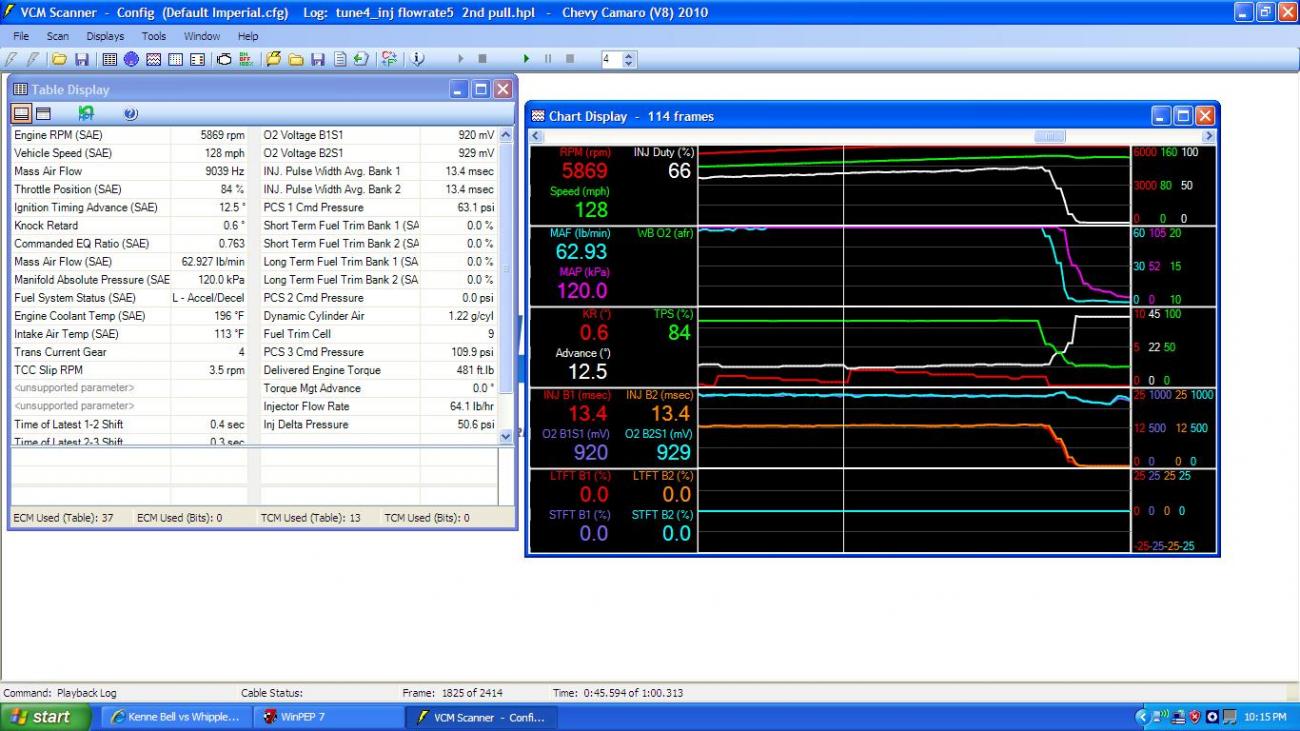

Here is the HPT scan from my most recent dyno pull. This is with my new Whipple and custom HE, the IAT peaks at 115 just after the WOT pull. Ambient temperature was about 80 degrees. Yes, I've triple checked that the IAT sensor is working correctly :-)

Old 07-26-2011, 01:05 AM   #427
Adam@ST
Drives: 2010 SS Camaro
Location: SoCal
Posts: 211
Those are nice readings..just out of curiosity, where is the IAT located??? Thanks Adam@ST

Old 07-26-2011, 01:10 AM   #428
mikepage0007
mikepage0007's Avatar
Drives: 2010 camaro
Location: port st lucie ,florida
Posts: 4,273
you read my mind, as we both know the whipple had a relocation issue...i believe the new whipples come with the correct sensor in the manifold.. some shops actually correct it by locting it in the intake..

Old 07-26-2011, 01:33 AM   #432
WhoMadeWho
Liberty vs Tyranny
Drives: 2010 SS/RS M6 Inferno Orange
Posts: 98
Rear of the Whipple manifold (below the blower)

Old 07-26-2011, 01:36 AM   #434
Adam@ST
Location: SoCal
Posts: 211
Well thats just insane..per log the log, that line never moves. If thats real, its awesome. Thanks Adam@ST
