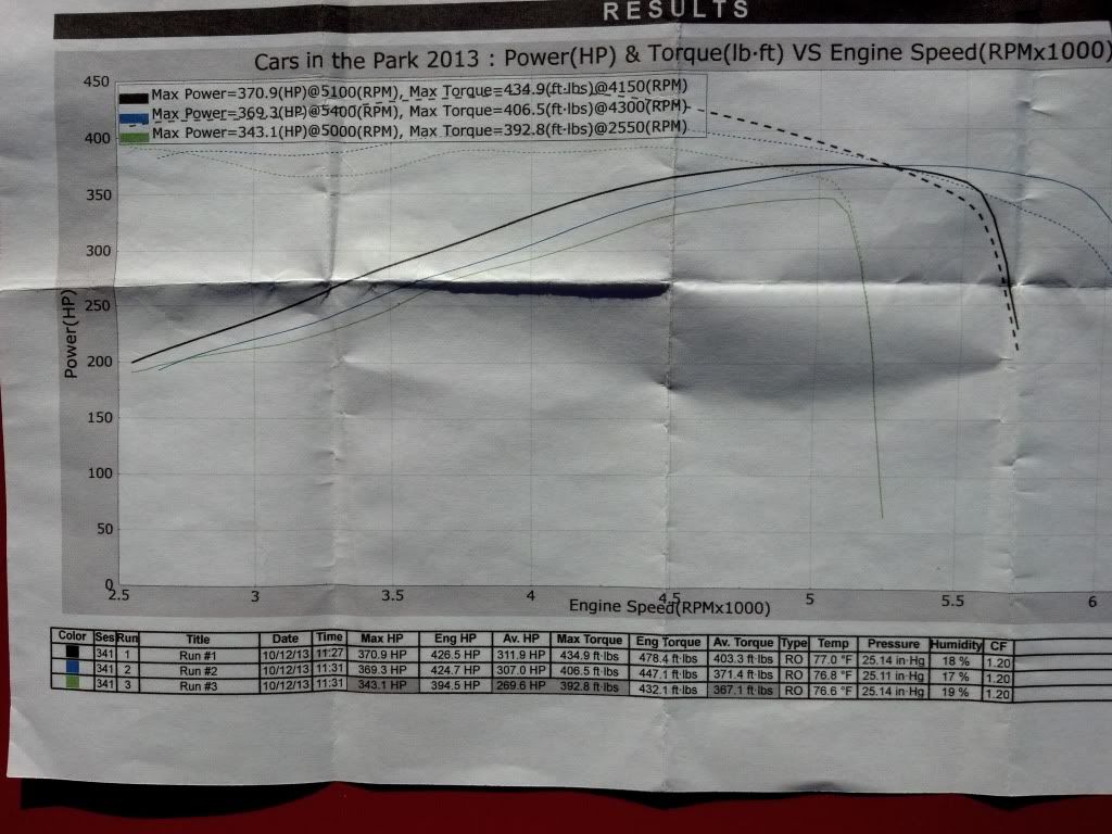

Saturday, 12th, @4600'+
Pfadt Tri-Ys, Cold Air Inductions cai, Foose wheels-29#s back, 91 octane.
On the 3rd pull I inadvertently paddled up from fourth gear and the electronics shut the engine down at ~150mph.

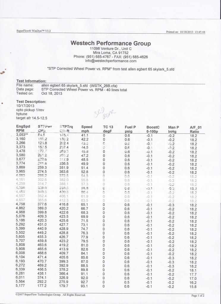

Dyno Results
If the moderators want to pulls this thread that is OK but the drivetrain is like the 5th Gen Camaro. The motor is a L92 out of a 2007 Escalade but for all intent it is now a L99. The motor is in a 1965 Buick Skylark and has the 6L80 transmission. Has the TSP VVT3 camshaft with PRC CNC heads and the valve spring upgrade. Has Headman 1 3/4" to 1 7/8" stepped headers. 3" exhaust with a Pypes X pipe. Ported LS3 throttle body. 4" cold air intake made by yours truely.
This was done on a Super Flow chasis dyno which the owner says that it reads about 4% less than a Dyno Jet. I have no way to confirm that. The operator of the dyno was having a devil of a time keeping the transmission in 4th gear. He had to kind of roll into it with the accelerator pedal to keep the transmission from down shifting . In fact we only got one clean run and that is the graph posted. A little later we did get a 473rwhp reading and we did some more fuel trimming after that. Here is the one good graph.
Edit. I forgot to say the tuner got this motor to idle at 700rpm. I did not think it would be posible with the VVT3 camshaft.
Does that run at the top say 434.9 torque? Any idea where you picked up that extra 28lbs of torque @ 150RPM lower?

I just realized something when I was looking at my dyno data sheet. See post 458. It looks to me as if this pull was done in 3rd gear instead of 4th going by the mph. I have the Drag Race 2000 simulation program and the mph and rpm matches pretty close with that in 3rd gear. If it was forth gear the mph would have been 120+mph at that rpm.
Here is the data sheet. Keep in mind in had to kind of roll into it in the lower rpms to keep from down shifting and in this case 2nd gear. I will have to get this car back on the dyno.
